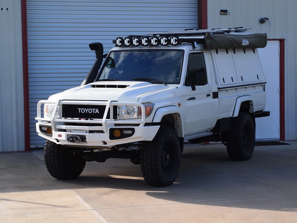

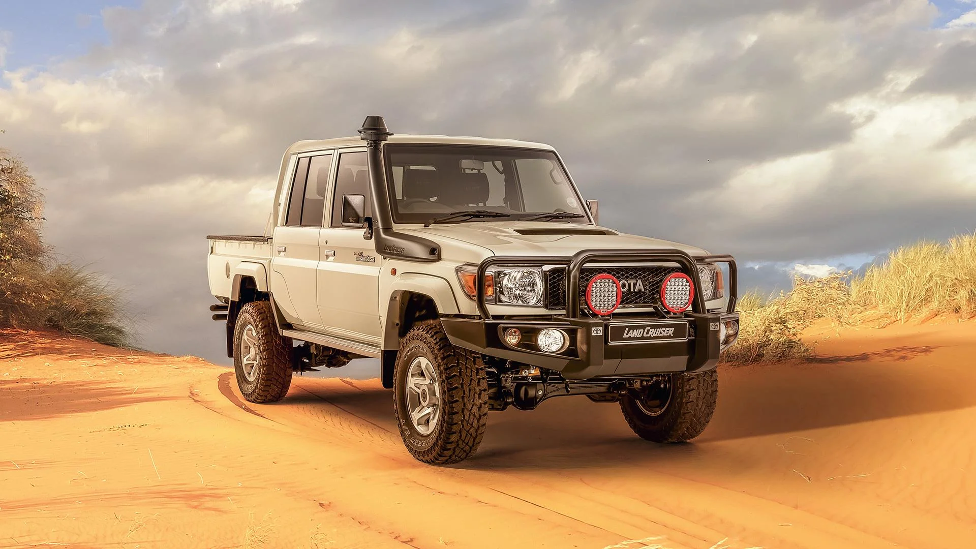

Good day. I need some assistance with a part number. I have a dual cab 79 series VDJ in South Africa. In about 2017 the bonnets/hoods on these changed in Australia. In South Africa we still get the same hood as before 2017. I am looking for the partnumber for the newer Australian bonnet that is on their version of the V8 VDJ. If anyone can please assist. First picture old hood and second picture the newer hood.

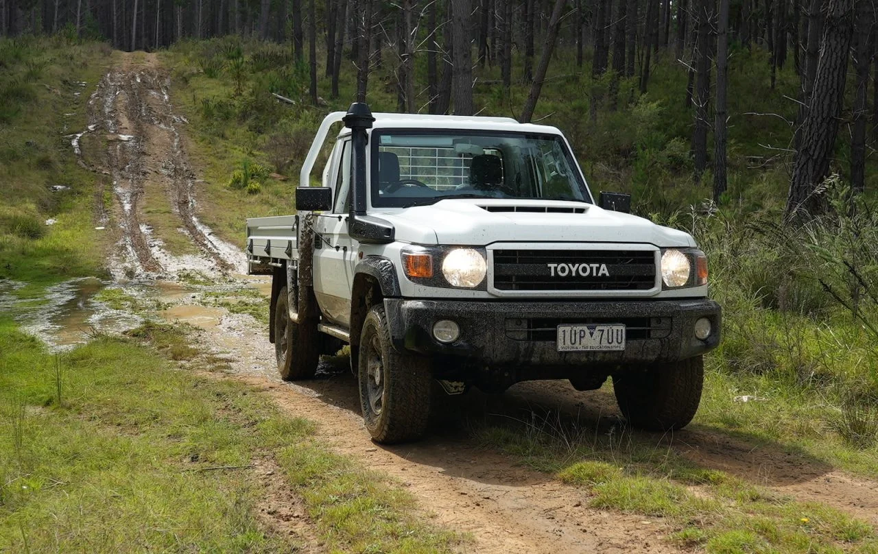

This is the newer bonnet/hood on the Australian V8's.
53301-60750 is the hood assembly.
The air intake/bulge will be color matched so you'll need the iteration that matches your body color.
You will need the internal guide as well: 76109-60020.
The hood insulator part number is different as well if you are intending to install that as well: 53341-60430
Great! That looks like the exact bonnet I am looking for. Thank you.
