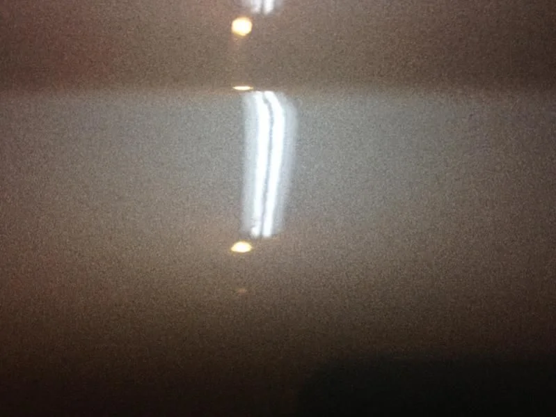

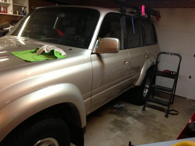

The gray 3M sheets you buy at the parts store, they're junk. They clog up wet or dry and you'll spend more time cleaning.
These round 3M 260L resin bond are no joke. They do not clog up and attack the clear coat consistently while sanding. I like using these by hand, I just fold a rag and use equal pressure and you won't get finger lines. For large flat areas ill use a Dura block. I've done hundreds of cars and none get easier. I'm just starting at 9pm and will be sanding for a few more hours and then polishing.
I tape off all edges with 1/4" green tape and back tape with 3/4" blue. This protects areas from the paper and the buffer.
Ill use a black foam waffle pad and then a white foam pad. For those hard to get spots I use my favorite tool a 3" polisher.
