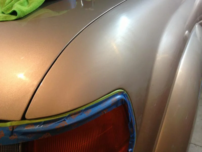

I get asked often how I can see flaws in the paint that are so subtle that most don't see them.
Here's an example. Take a flashlight and lay it on the body or close to and inspect the truck. Here's two handles on the drivers side that have abraded paint. Dead center in the handle from opening.
You really want to see something crazy, go turn off the lights in your house and shine light down the walls, not at them. You'll find some interesting things ;-)
Same technique investigators use at crime scenes.

Flares, mirrors, hood and many spots around the body sanded with 3M p1500.

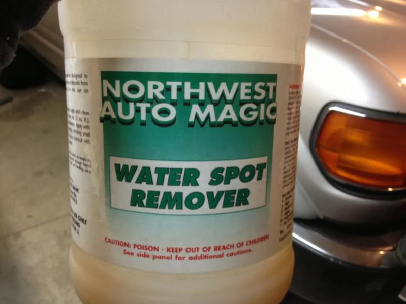

My other secret is an acid base gel. It's great for removing water spots of paint, glass and chrome.

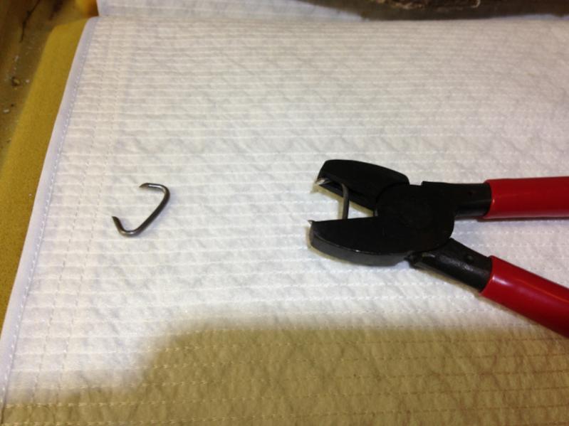

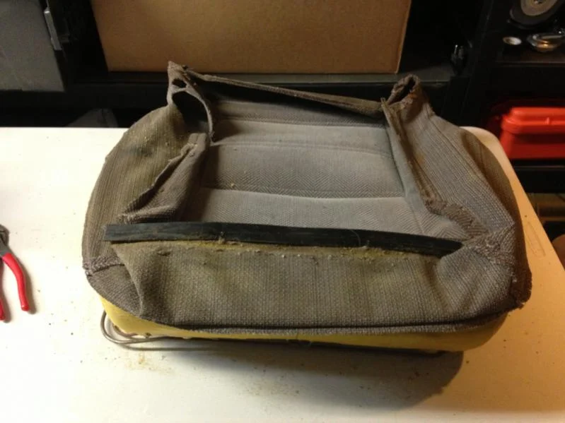

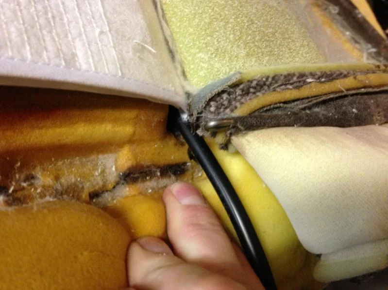

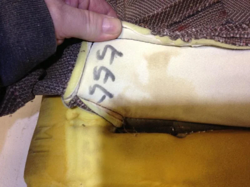

Finished up installing heated seat inserts into the passenger seat. Our kit is 100% plug n play. Tap into key hot (under console) and run switch to dash or console com blanks and wire ground.
I ran all under the carpet along the factory harness.

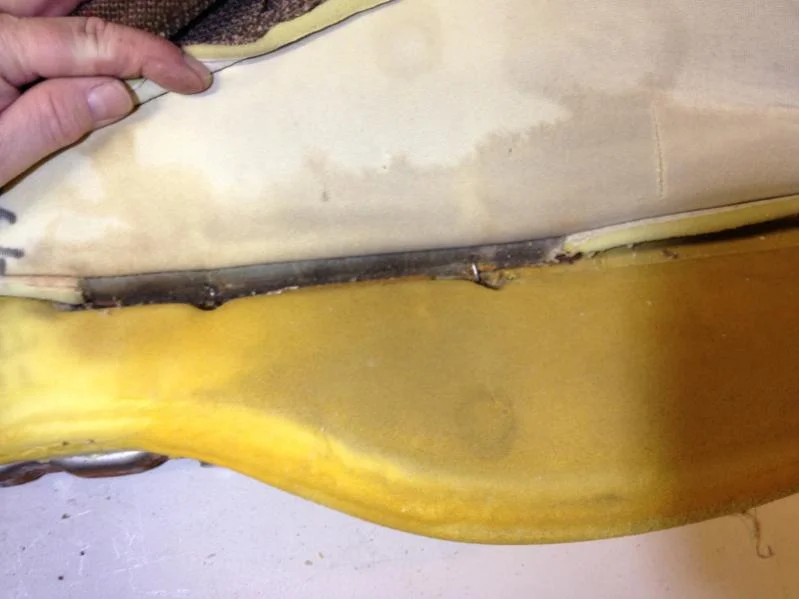

As you can see the drivers bolster was broken down. Upon removal I found it to be completely broke down. Ordered a new cushion.
The seat back middle spring where the seat listing attaches to was loose. The welds had broken. Upon inspection I found another broken and another cracked. Busted out the Lincoln and made it whole again.
