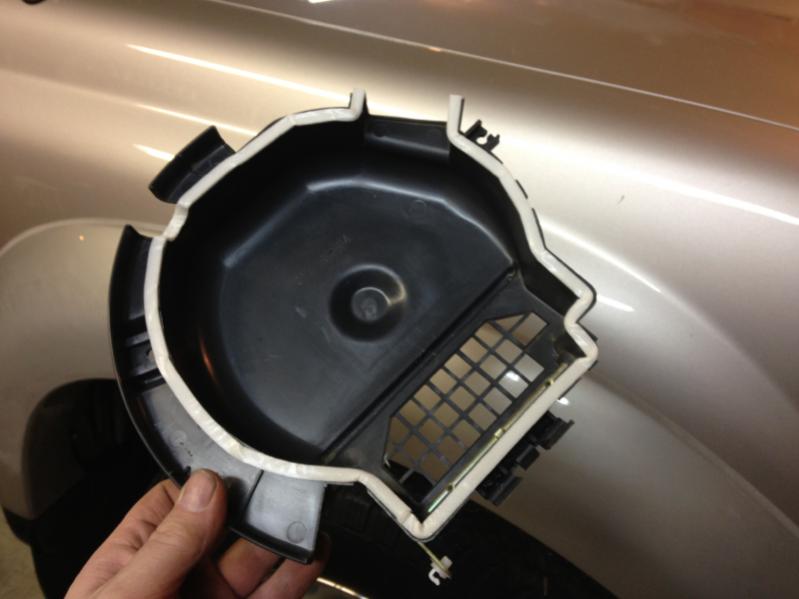

Because some said it was a good idea to clean the heater box (Darkness) I still can't figure out how that stupid thing comes apart. HELP PLEASE
But I remove the fan and cleaned it up, also re sealed the housing and replaced the foam on the blend door. I know, it's a sickness.

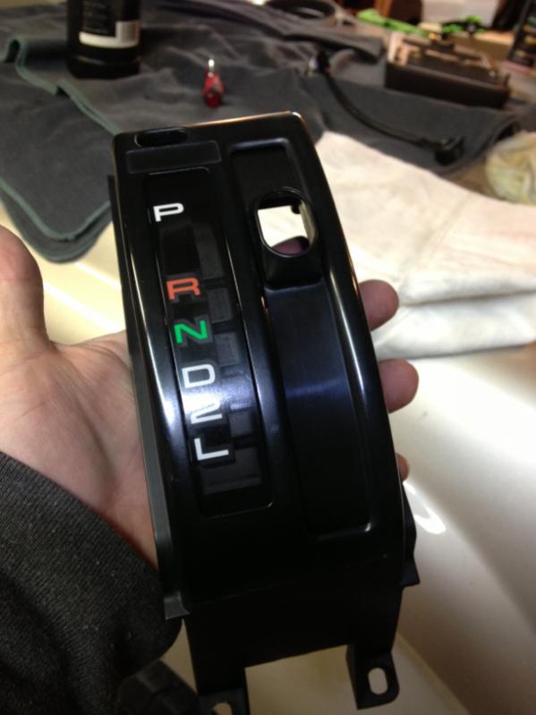

Installed a new leather shifter and e-brake boot.
Factory was rubber and sticky, had to go.

Because some said it was a good idea to clean the heater box (Darkness) I still can't figure out how that stupid thing comes apart. HELP PLEASE But I remove the fan and cleaned it up, also re sealed the housing and replaced the foam on the blend door. I know, it's a sickness.
Hey, looks like it was a good idea! I actually just meant the round part. The square part is the AC heat exchanger. You can reach in there with a shop vac from the blower. Sorry I didn't see this in time to help!

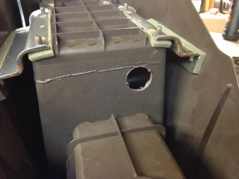

Any help getting into that box would be huge!
I accessed it just like you did in your pics. Scraped and pulled everything I could off of the coils with my hands. The carefully used a small attachment on my shop vac for the rest.
I gave up after 5 min of trying to completely remove the cover for fear of breaking stuff.
I can only open it a few inches. It's going to be tough as I don't have anything small enough to get in there. Now I know it's full of crap and I just can't let gooooooo.
Odd that you can open three sides and not the rear. Makes no sense to me.
The AC cooling lines connect to the heat exchanger through the firewall. I don't think you can get that lower part off without disconnecting them. Unless you open up the AC system I think you're as far as you can go. There are products you can use to clean the fins with the box closed:
https://forum.ih8mud.com/80-series-tech/92253-cleaning-ac-system-evaporator.html
I think getting the leaves out is the main thing so they aren't rotting in your vents.
