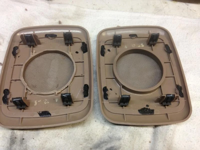

Installing the rear speaker covers required material to be removed. Once removed they fit like a glove.

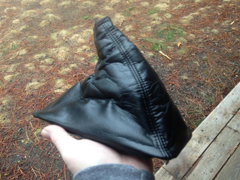

Does your shifter boot look like ass?
It's vinyl, so mild soap and water to clean and then grab your favorite lotion from your night stand (non scented is best) and lather it up. Let sit in the sun light or warm place for a few hours and then buff with cloth.
