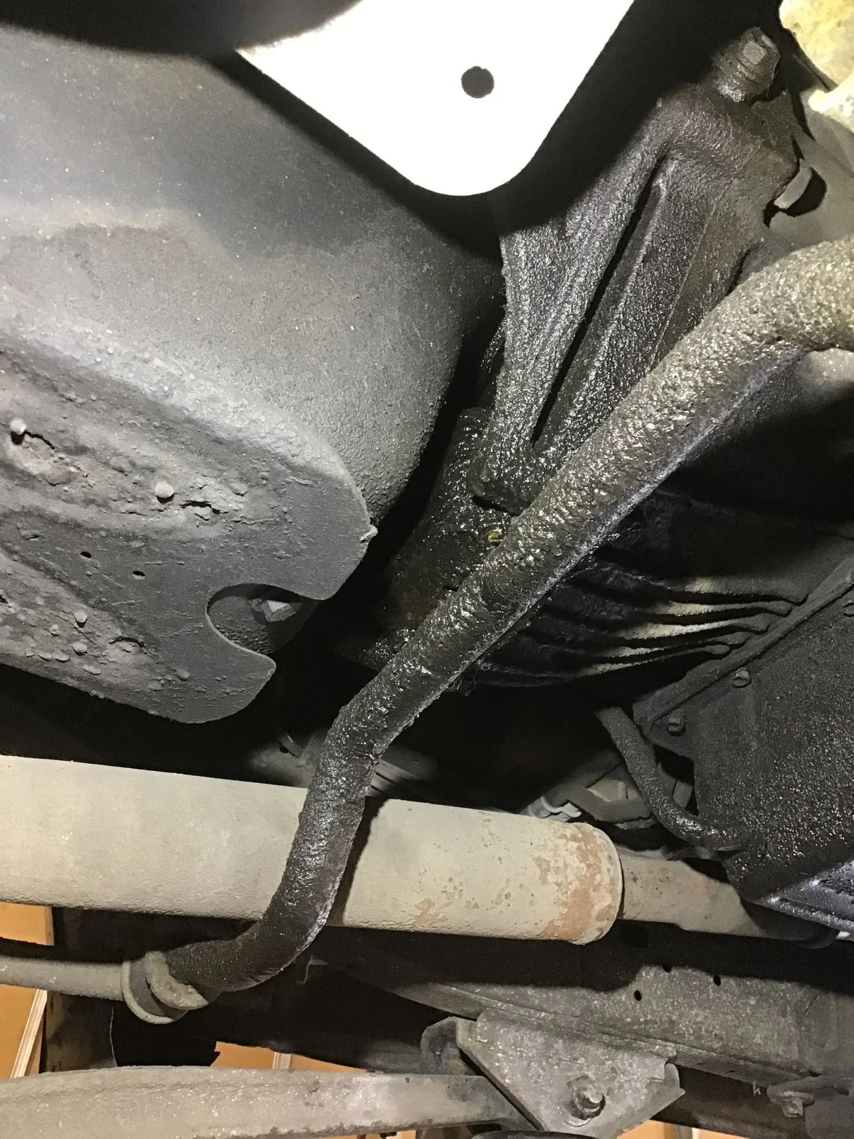

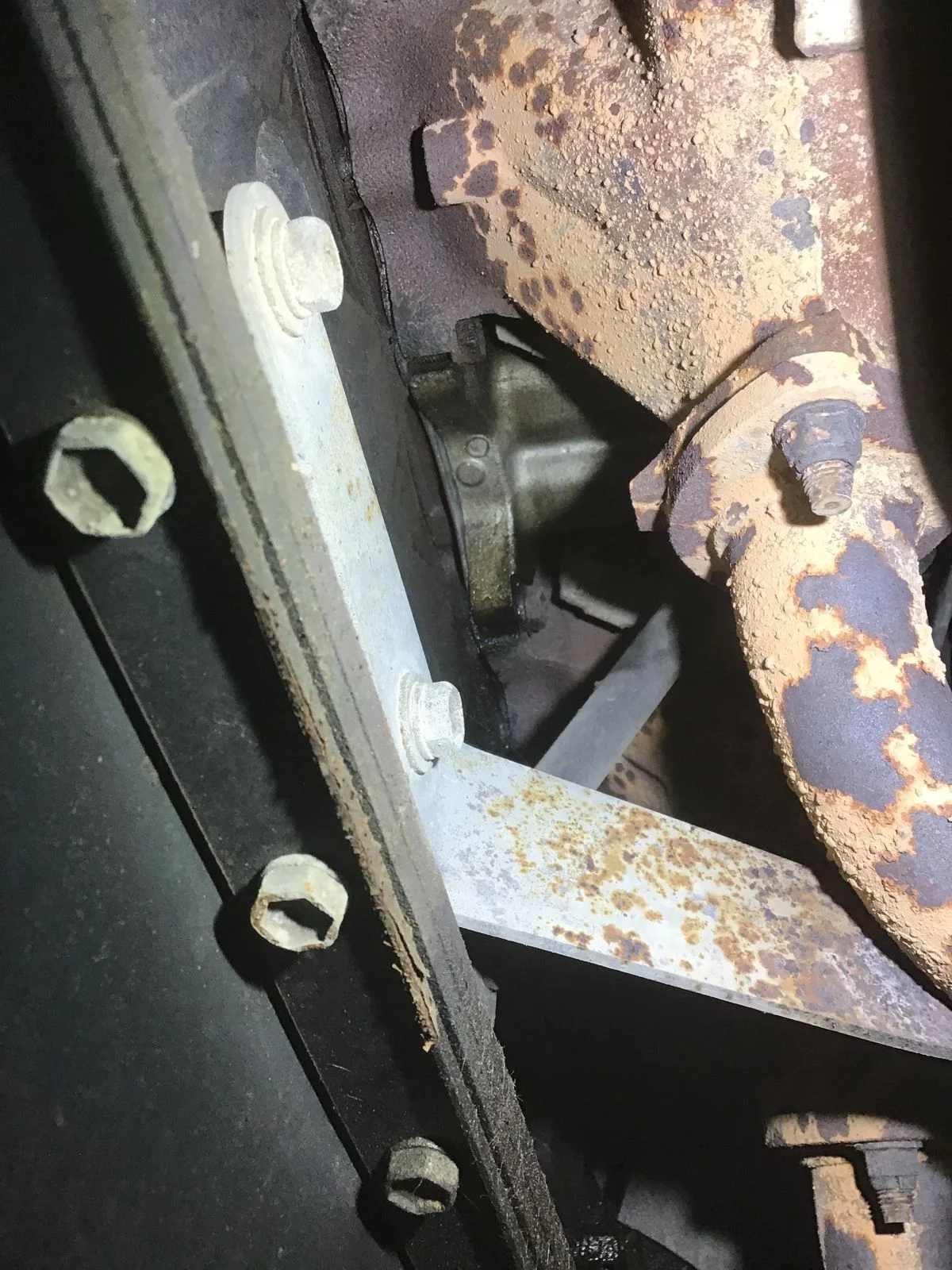

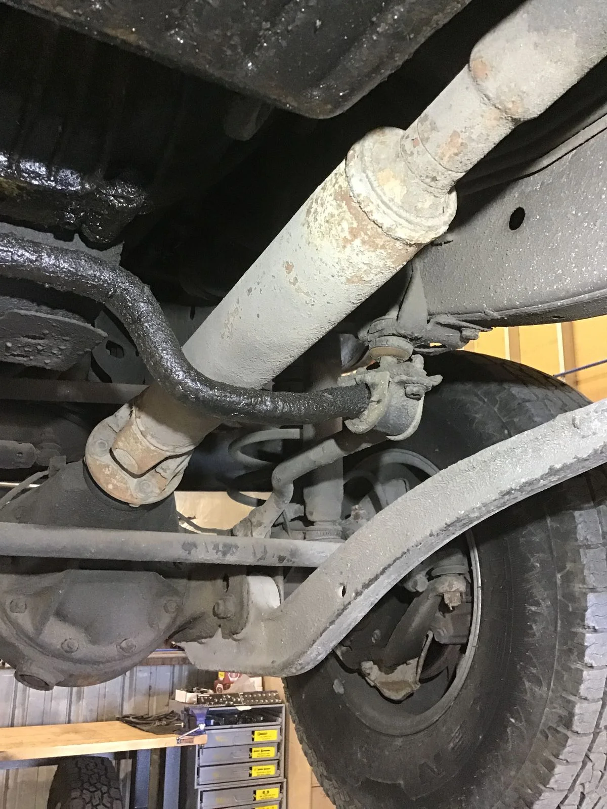

What are your thoughts on this undercarriage though? I keep reading how if there is rust just let it go, but since this car cost me $0 I have some money to put into it. Just not sure if I should. I am attaching photos from the report I got today and they didn't mention the rust to me (this was the mechanic not the body shop) so I am not sure if that means anything?
Thoughts?

Just want to say thank you everyone for the vote of confidence and also note here that I apparently have no effing clue what rust looks like :geek:, but glad to hear that this old gal is rust free.

Doesn't look terrible. Just the typical oil leaks. How is the rest of the truck. This forum requires much more pictures! What are the stats? Mileage, locked, mechanical history? Everyone is going to be dying to know these details! Lol.

I don't see any rust save the exhaust pipe which frankly looks normal. Rubber bushings look like they are on a 20+ year old truck. Should replace as you need to but if funds are short you can do only the ones causing problems. If it runs and drives ok then they will last a bit longer. Oil leaks look pretty standard.

It's not bad from what you are showing us. For $50, you should replace the way bar bushings: 80 Series Swaybar Bushing Kit
The shocks and springs should be replaced, but you can certainly drive it as is if you don't have the budget for it at this time.
The prop shafts look dry. Get yourself a decent grease gun, like a Lincoln 1134, and a tube of Valvoline Palladium grease. Find the zerks and pump the grease until it starts oozing out of the U-joints (also known as spiders or universal joints). Then find the zerks for the drive shaft slip yokes (also known as slip joints) and pump grease until you see the shaft starting to separate. That should be enough as over greasing it could lock the slip yokes and cause damage.

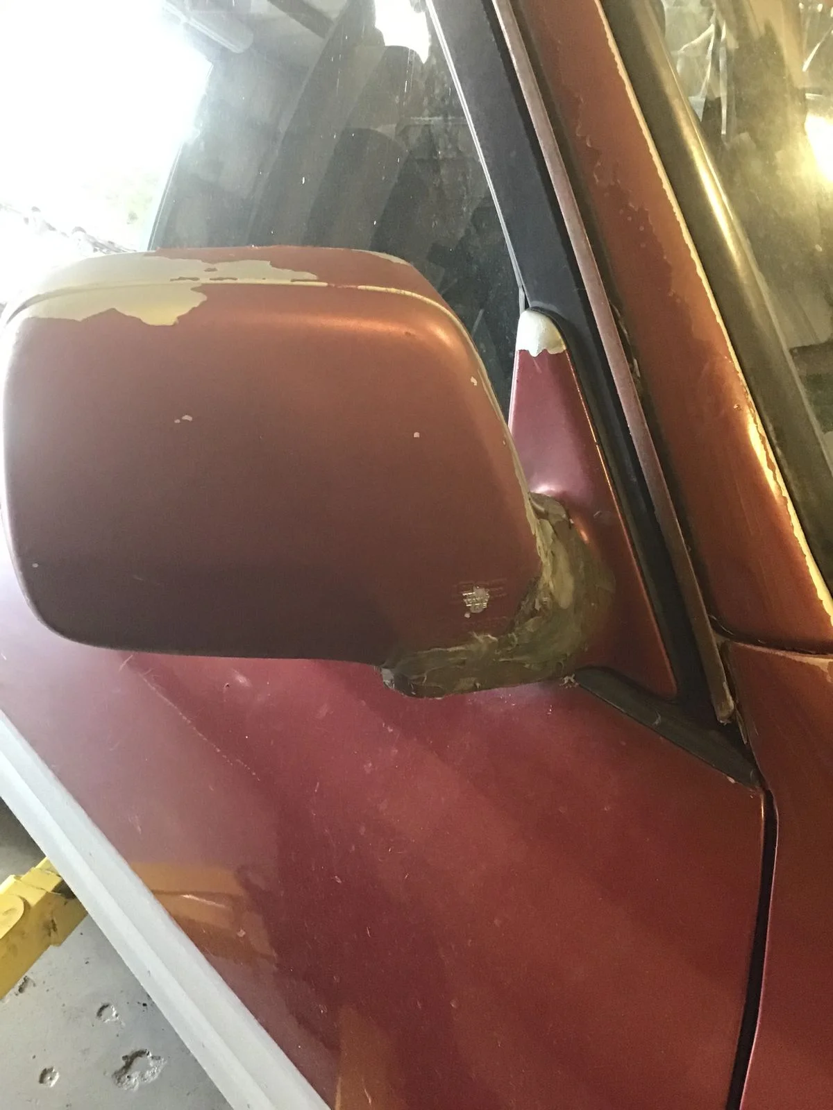

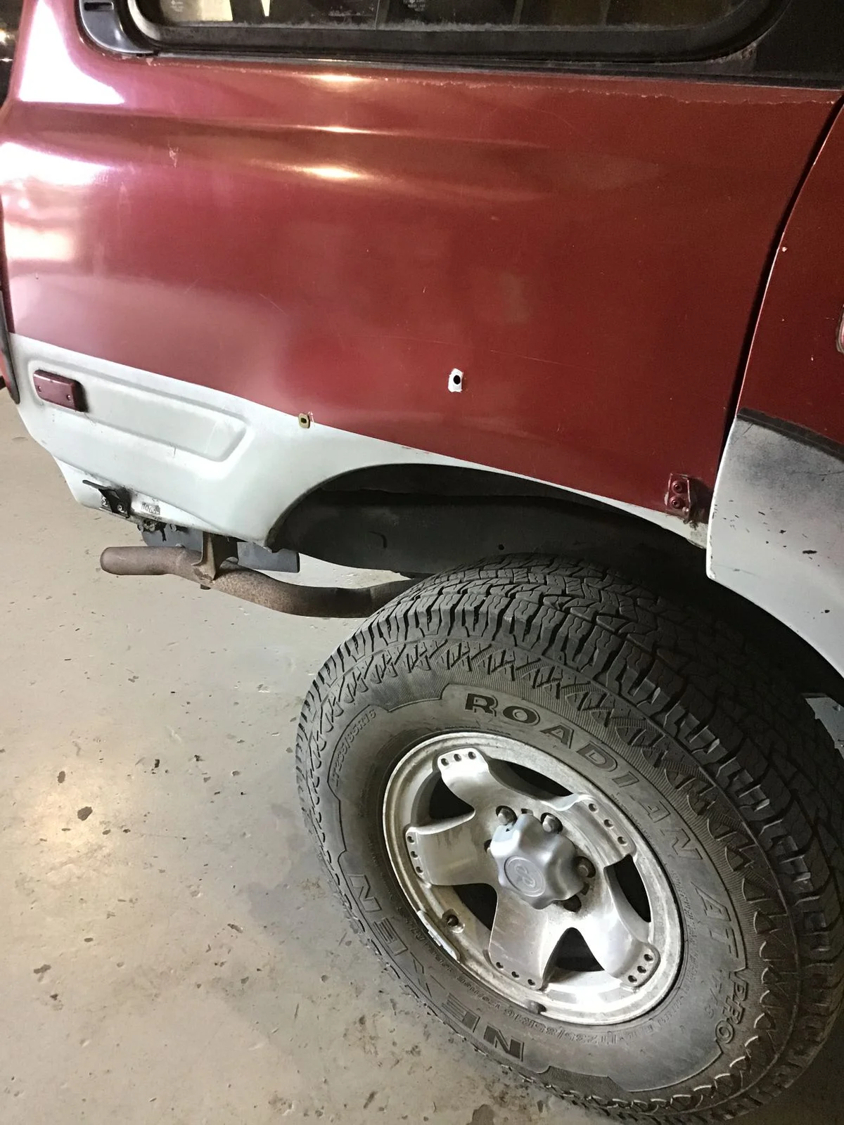

Mirror is an easy fix! You're at a cross road with your flares, take the rest of them off or fix the one you're missing.
With a little sweat and tears you should be able to clean that up!

Dan, would you concur that the front DS is installed backwards?
"Front drive shaft was installed backwards"
As in.....
It should be unbolted, swapped end for end, and bolted back in.
Because you may hear the DS scrape on the sway bar if you drive over a curb at the mall.
