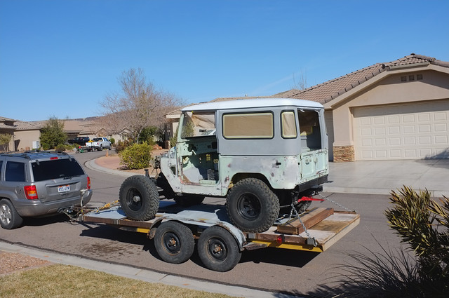

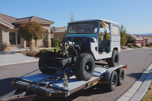

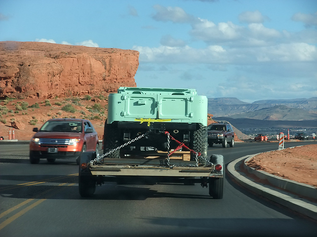

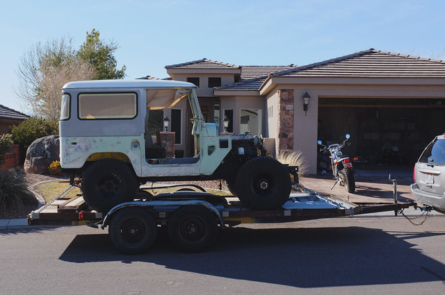

Anyhow, here are a couple of pictures of it loaded up and ready to head off to paint.
You can see a lot of the larger parts on the flatbed and underneath the cruiser. There are a lot more parts inside as well. I hope I managed to keep track of all the little parts!
I've done a lot of parking on g the street with my landcruiser exploded in my garage. It's started to take over parts of my house as well. It will be really nice to have everything back together and only taking up one car space.
Notice the pretty white roof? It's getting sanded back off and repainted with something more durable.

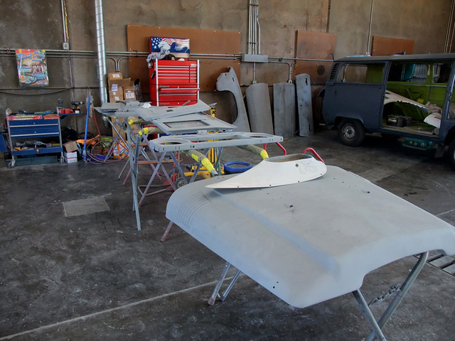

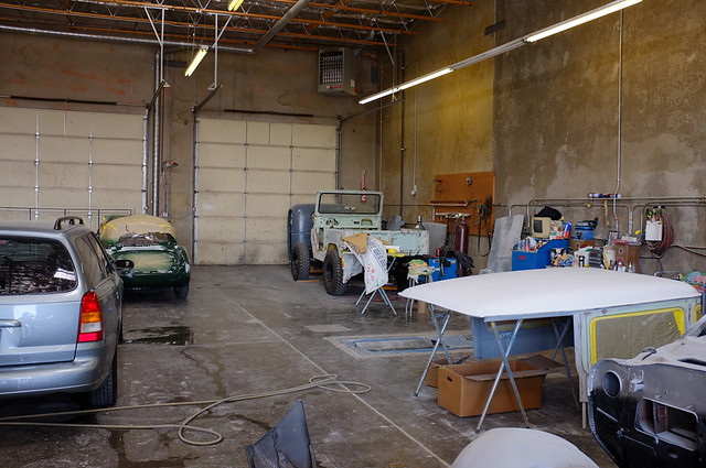

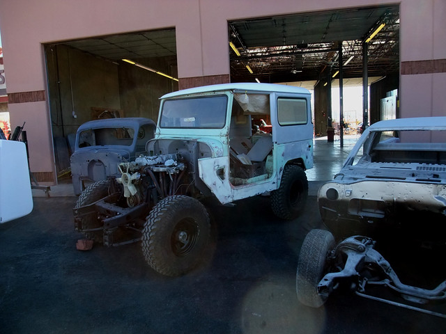

I had a few things to discuss about the paint, so I ran out to the shop this afternoon. They haven't started on the cruiser yet, but I took the opportunity to snap a couple pics anyway. It's going to look sweet when it's done. :D
Here it is outside among some of the other projects.
And here's a couple of the bigger parts waiting for their turn under the gun.

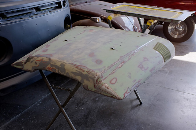

The other bit of cruiser porn has to do with the fact that Crash has been working on my '70 for a little bit now. I wish he was making faster progress than he has been, but it's starting to get there. As you can see, he's had to undo some of the work that I did. Here's my split-less split hood as it get's ready for a final skim-coat and prime.

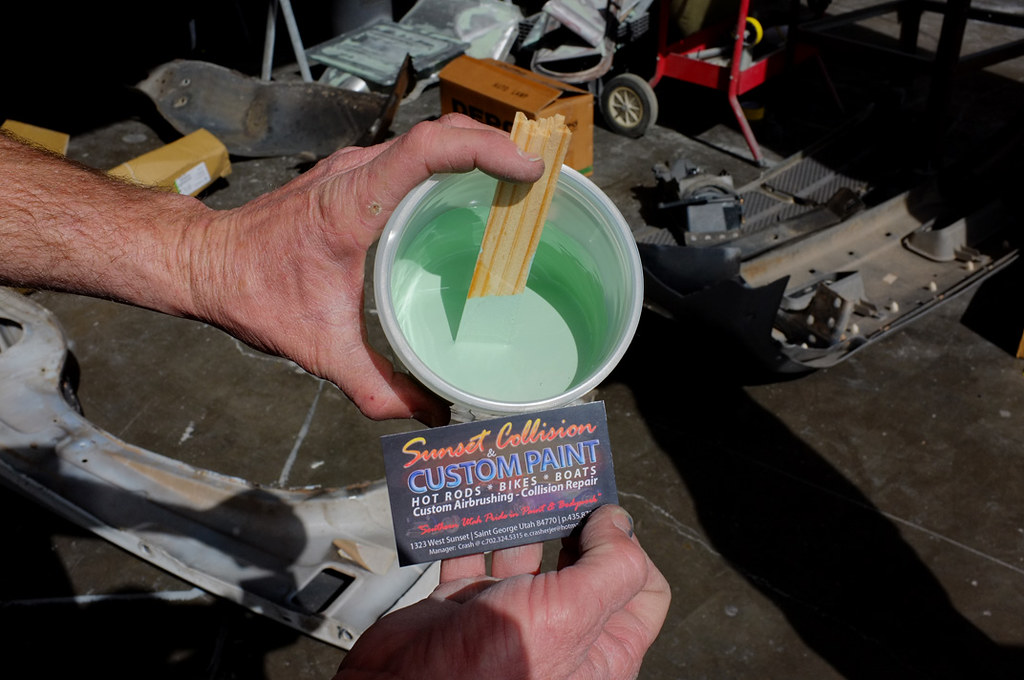

Here is the color I'm going with. It's basically spring green, but I'm sure a purist would take exception to the fact that it is based of the 40+ year old faded and dirty paint left on the cruiser, and it's been tweaked a little to not be quite as colorful as what I've seen in other pictures of spring green cruisers. That said, it's a hard color to photograph and have look right. It washes out in the sunlight in pictures, but not as much in real life. Crash wanted to include his business card in the pic for some free advertising when I told him the pics were for the web.
You can see the color pretty good in the shadows of the container.

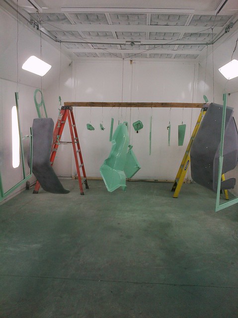

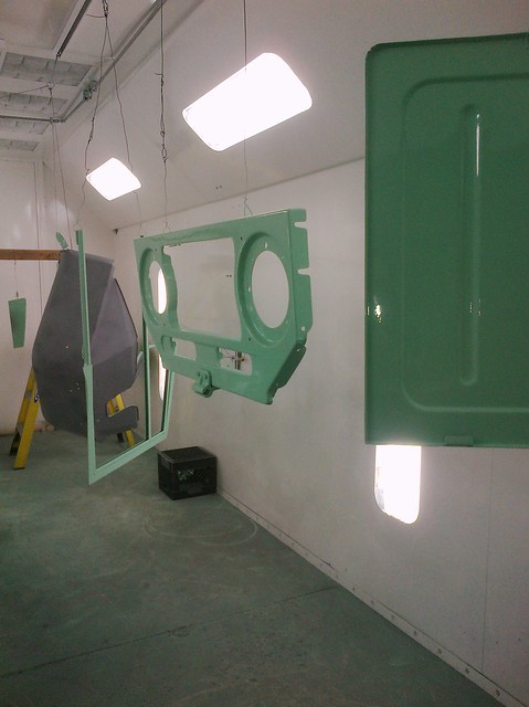

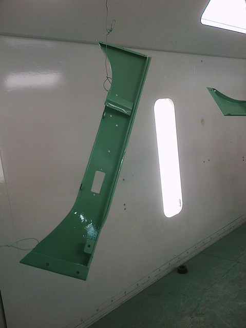

Here are a couple pics of the rocker panels after just being sprayed, under some artificial lights in the paint booth.

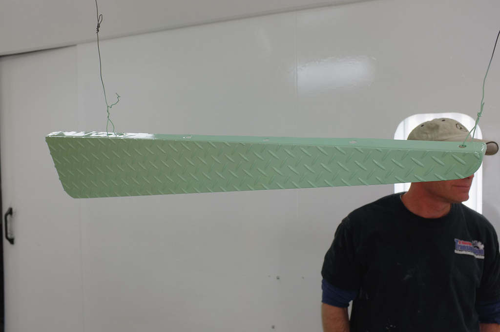

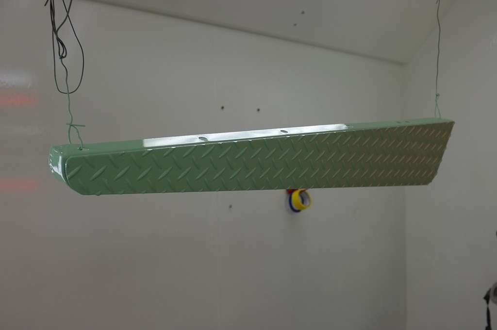

Snapped these pics with my phone, so the quality and color isn't as good as the others. Plus the parts were still wet. I dropped in to the paint shop yesterday because I was on that side of town and I was glad to see some progress being made. It's looking like I'll be getting the cruiser back from paint in another week or so. :bounce:
When I stopped in Crash was working on the hard top, so I volunteered to bring the dolly over to use for painting the inside surfaces and for moving it around the shop. And for those of you who noticed the bezel in the 2nd pic, it's not going to be green. The official word was that the green was just a base coat that could be wetsanded down to perfection before laying down the white. Sounded pretty BS to me, but whatever. I'm jsut excited to be getting it back soon. Time to start cleaning up the garage in preparation. :steer:

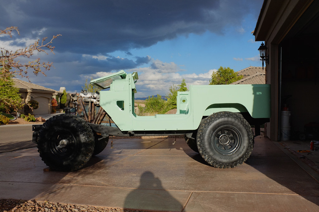

Okay, the race is back on. Cruiser is back from paint and now it's time for reassembly. I just checked and I originally purchased my FJ40 in the middle of July, 2010, so the possibility of wrapping this whole project up in under two years is a real possibility. Actually, it's almost a necessity since I'll be getting remarried before then and I'm pretty sure the new :princess: will want access to the garage. :D

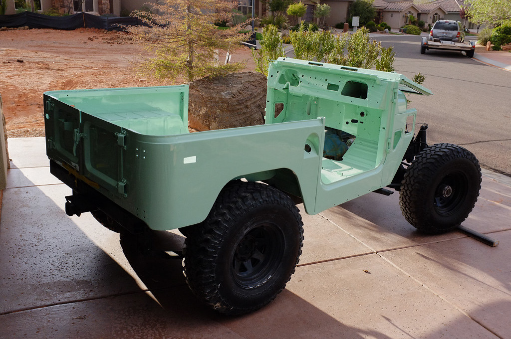

The cruiser came out looking awesome. It was never intended to live its life in a showroom or be a trailer queen, so we left a lot of the ripples and spot weld marks in the sheetmetal. Most of the dents and dings were taken care of, but if you sight down the body you can see that it's far from perfect. But they didn't come from the factory perfect, for one, and I intend to scratch up that shiny paint and get a nice thick layer of dust on it just as soon as I can. This truck has always been intended to be used. It just so happens that when I got it it was butt ugly and needed a makeover, and I'm a little too OCD to just slap a coat of Rustoleum on it and drive (although believe me, in nearly 2 years I could have done a lot of driving). If it had a nice original patina like so many of the ones you guys own I would have, but the peeling canary yellow plus brown rattle can stripes paint job just had to go. But now it looks awesome.

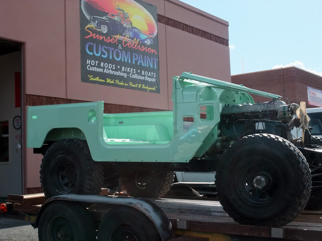

Here's a couple of pics leaving the paint shop.
In the second shot I tried to get a picture showing how the green looks against the native red rocks. It was hard to do while driving, but even harder since every camera seems to photograph this color differently. The color is a modified version of T28 Spring Green, which was the original color as best I can tell. I wanted to do something that was a little less fruity than the other spring green (often called seafoam green) cruisers I've seen. Of course, I'm finding that the "fruityness" might just be from the camera. This color is a little desaturated from the paint that was left on the car that we matched to get the starting point for the color. Lighting plays a big role as well, as does whatever backdrop is behind the cruiser. Sometimes it looks a little too bright, but most the time the color looks juuuust right to me. I'm really excited to see it with the seats in and the front end put back together, but I'm just going to have to exercise patience until I can get all the mechanicals done.
This picture is a pretty good representation of the color, at least on my monitor.
With a sky like this I should have wheeled it out into the street and tried to get a shot without my shadow in the picture.

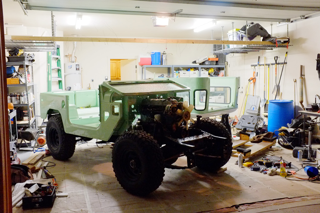

With a little work I was able to clear some space between messes to fit both the cruiser and the hard top in the garage. Part of the reason for the creative parking was that I had already flipped the hard top so I could install a headliner.

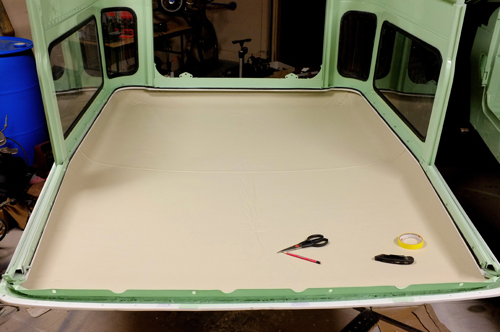

The headliner installation went pretty smoothly. I would much rather do one with the hard top dismantled, because I had to do a lot of awkward reaching to get to everything on the back half. I don't know if this is common knowlege because I didn't search mud for headliner writeups ahead of time, but doing the headliner in sections, alternating between gluing and trimming, seemed to work pretty well. I started by aligning the headliner based on the rear corners, without tucking any of the edges under the top rail yet. Next I glued down about a 2' x 2' section in the center of roof about a foot in front of the seam. Doing this allowed me to work on tucking the headliner up under the rail and "marking" it by poking it with a utility knife. I left the front edge about 3/4" long so I could trim it last, but if you get the sides sufficiently tucked up in the trimming is less critical. After "marking" it, I could pull the leadliner back out and trim it with scissors pretty easily. I trimmed everything back to almost where the seam is, test fit everything, and then glued it all down. Make sure you mask everything off well because when that spray adhesive stuff gets airborn it gets everywhere. I used some 3M trim adhesive for gluing down carpeting that specifically said not for vinyl or headliners, but I live dangerously. :D Anyhow, with the front down it was just a matter of triming and gluing about a 1 foot full width section at a time. I made sure to make one of the section breaks right at the headliner seam. This way I was able to get the seam to all lay the same direction the whole way across, and then for the next section pull everything tight so the seam is as invisible as possible. I'm pretty pleased with how it turned out.
Hopefully the remainder of the reassembly goes as smoothly as the headliner. Yeah right. I've already determined that I'm going to need to rewire the entire truck, after spending several hours trying to undo all of the hack and splice jobs from the previous owners. Unfortunately that means it will be a little while before I can even fire it up, assuming it will even run that is.
