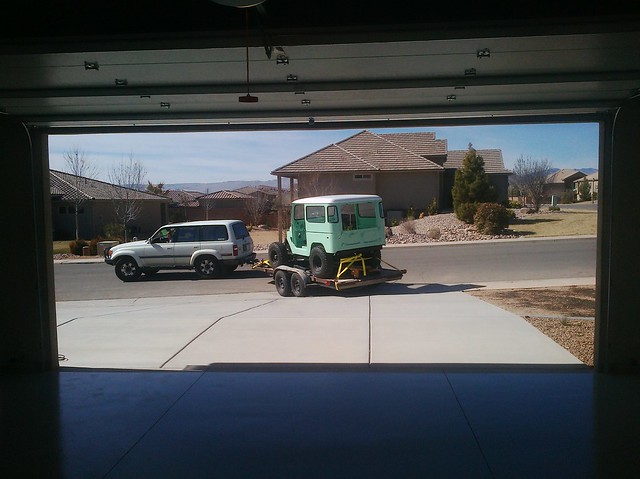

New house is finished and MrPepper is getting ready to close and move in. Im getting ready to help move the cruiser. In May, several guys from the local club are doing a multi-day Grand canyon/Arizona strip 40's only run, should be epic. So we are hoping to have it driving by then. Lots of tech nights at MrPeppers house.

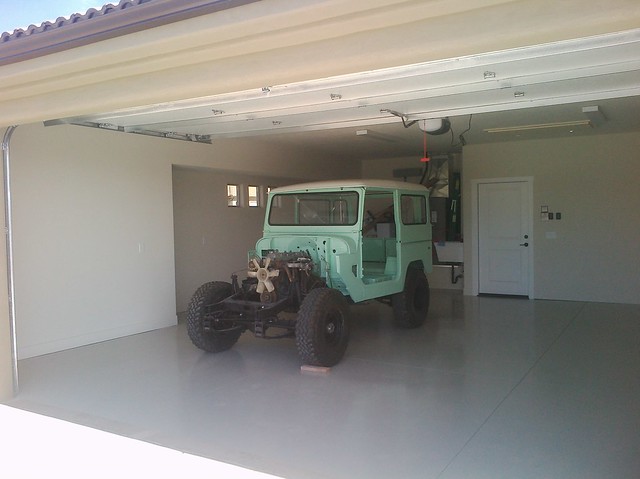

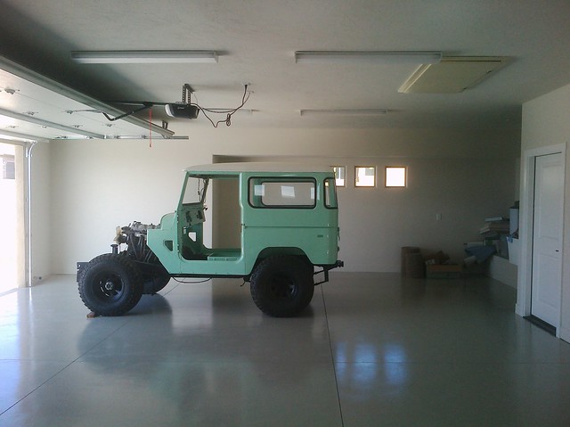

Oh yeah, the new garage is fantastic! Way more space and much better set up than the last one, which actually wasn't a bad garage at all. It's pretty full of boxes from the move still, and I need to spend some time going through everything to find out where all my stuff ended up through the move. I'll post pics. The very first item in the new garage, fittingly, was the cruiser. It looked pretty epic. Definitely got the cruiser juices flowing.
It seems a little selfish even to be sharing these pics, but I wanted you all to know that I had my priorities straight with the new move. (1) Cruiser first. (2) Big garage for working on the cruiser. (3) Cruiser gets the best parking spot, regardless of whether or not it can move under its own power.
Unfortunately now the garage is nearly full of boxes of stuff hastily packed for the move. Lots of work ahead of me to go through everything to find out where all my tools and parts are. I know enough to have been able to get a lot of my steering and some interior parts put together last night. This week I will make a big push to get the garage organized and the rest of my honey-do list taken care of, so that I can start putting some serious hours into finishing this thing. Woohoo!!! It's great to have a cruiser-centric lifestyle again.
