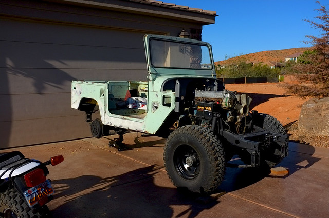

I've welded and ground all the cracks. I probably found 20 scattered between the hood, fenders, doors and tub. I actually just found one more last night. I'm trying to do it right, short of just replacing everything.

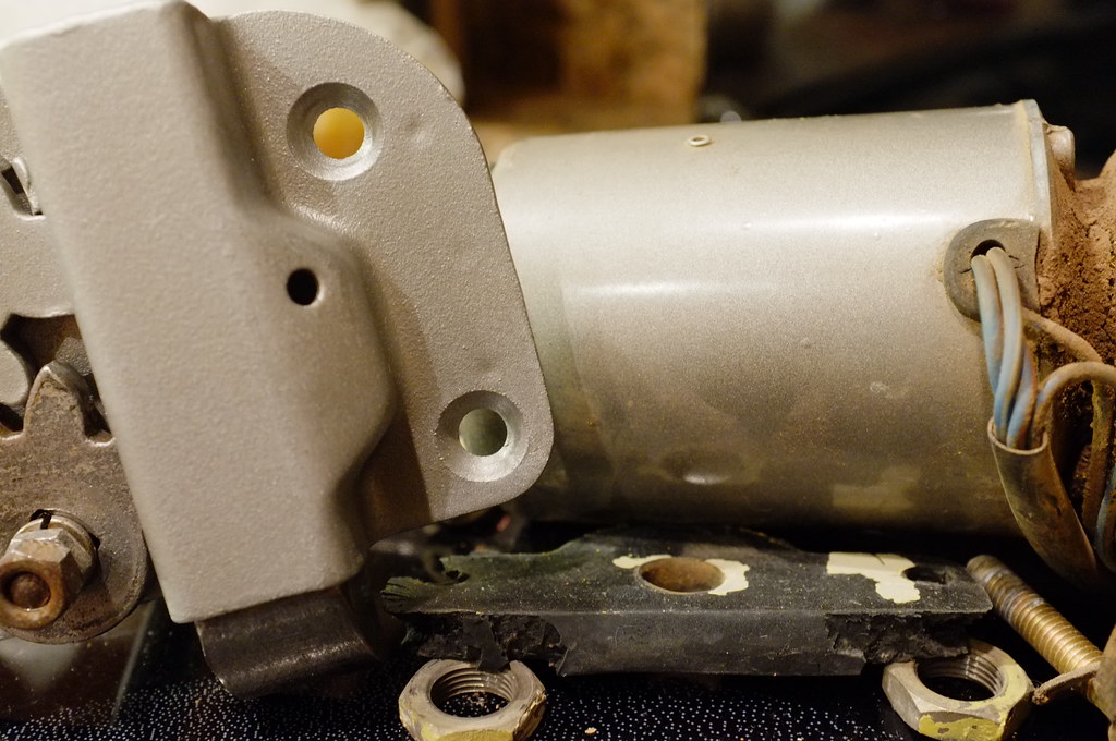

Regarding the heater motor there is another common electrical motor that will fit with minimal mods (4 Seasons p/n #35576, combined with a 50W 1ohm resistor for low speed) and can be had for ~$20 on ebay. The heater isn't in great shape and it looks like they don't command very much here on Mud (best case is probably ebay in the dead of winter). I thought maybe I had enough value in just that one part to pay for the whole lot of parts I brought back (which was only $100 for everything), but I guess not. It might get me halfway there, though. I'm looking forward to the day my cruiser is complete and debugged and I can begin selling off all my duplicate or unused parts and figure out what this whole project ended up costing me. (I'm hoping for under $2k, which I think is reasonable.)
