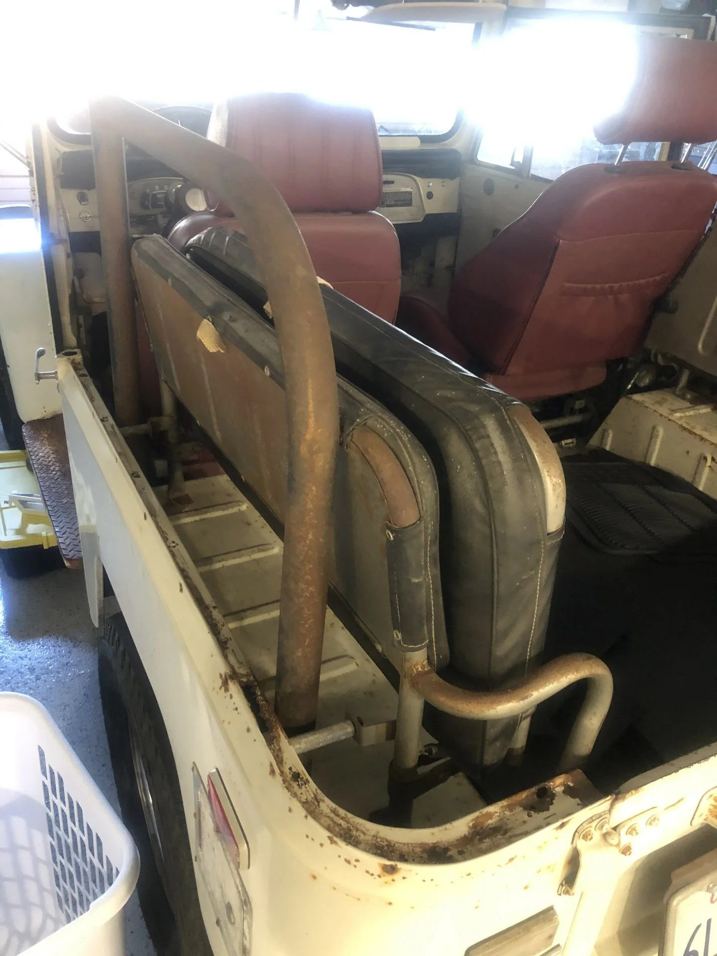

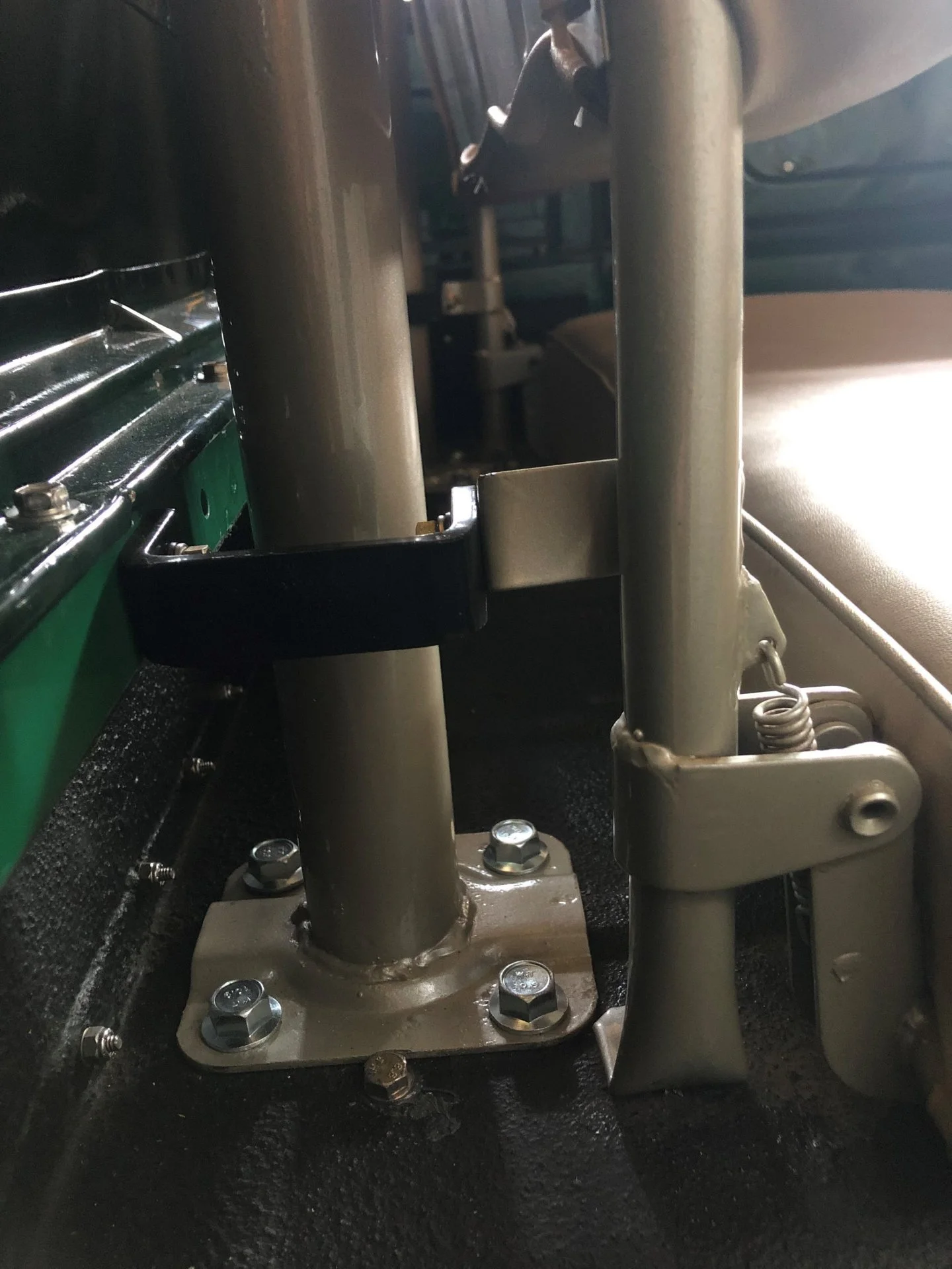

Roll Bar Questions: Hoping some of you can help us out. @3_puppies ?
Was there a stock roll bar that was offered in 1971?
We have a roll bar but thinking it's not stock. Post #69 shows the roll bar in our rig.
Can we fit "long" seats back there with the roll bar we have? Or do we have to find "short" jump seats to go with that roll bar?
Do the long seats fit with any roll bars?
I don't believe that a roll bar was stock in 1971. However, SOR makes a bracket specifically to allow installation of longer jump seats. The seats are moved out about 2" or so to clear the roll bar. New supports are needed for the bumpers on the bottom of the jump seats to land. I recently purchased 3" x 3"x 2" angle iron brackets for this purpose.
Roll bar didn’t come out until late 73, maybe early 74.
Don’t put that in stone though, I’m not old enough to remember.
Here is a photo of the SOR brackets that we used.
Thanks for the pic. That is super helpful. The Prospector and I had a long talk last night and after a lively discussion we're going with stock jump seats in the rear.
Now if I can just find a set of reasonably priced long jump seats...
Your roll bar looks to be aftermarket probably made by smittybuilt. Similar to the one in avatar, except w/o the frt bars. Its dimensions might be slightly different from stk.

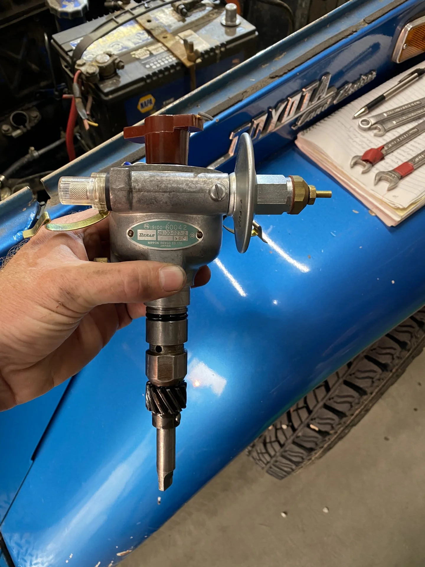

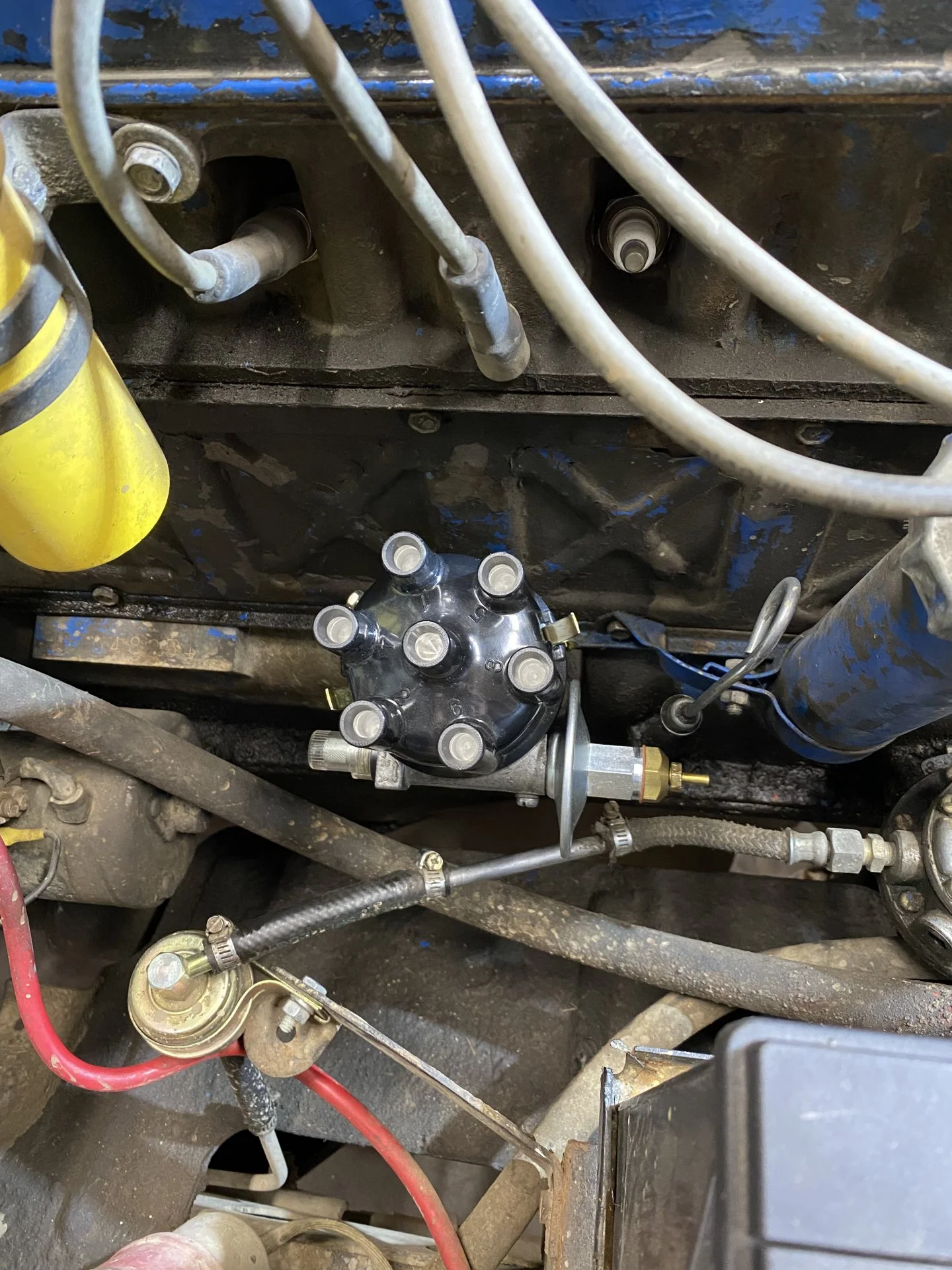

Vacuum what?
To be honest, I hadn’t heard of a vacuum retard distributor prior to having our 40. It doesn’t seem weird now that I know why the vac ret version was installed but just have never considered anything but vac advance was even available.
Relaying this info back my fellow 40 owners, they keyed me in to the dizzy swap for a non-USA spec version which wasn’t worried about meeting “low” emissions. So we’ve been loosely looking for a vac adv type.
We reached out to @4Cruisers who we found through the classified here on MUD. Holy cow! What a find! And now we have this work of art under our hood. A rebuilt early F dizzy with vac advance! Perfect for our Montana rig.

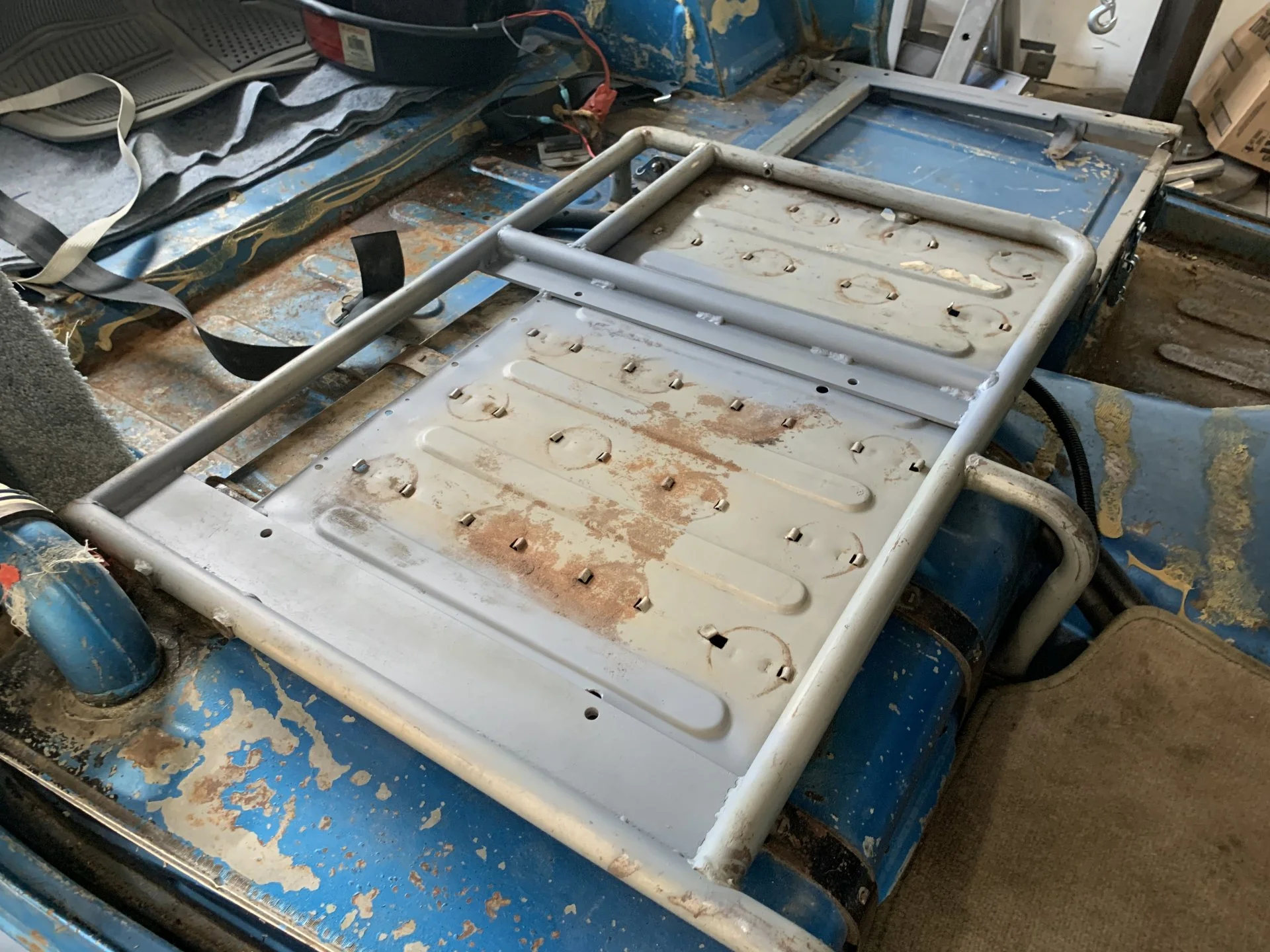

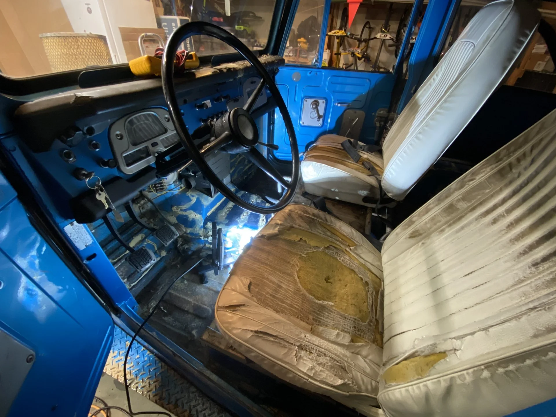

Our 40 didn't come with original seats or frames. The two front seats (from the 70s?) were ripped, stinking and full of more seeds (we had found the mouse previously). We were able to get covers on them to keep the foam from totally disintegrating but it was never meant to last long term. The passenger side was bolted to wood wedges. The drivers side had no slide catch mechanism, which meant the seat slid back and forward depending on hill angle or hard braking. Sketchy at best.
After looking over pics of other rigs and talking to other 40 owners, we decided to wait for something cheap and for something Toyota made to drop in.
Shout out to @hygge who donated some FJ60 seats, @3_puppies for sourcing the seat rails, and to Sailor at Heliarc Design for fabricating the mounts. Both seats recline and slides are operational. Sailor was even able to keep the drivers side tool box functional! I'm sure the seats will get recovered some day, but for now, it's just perfect for us. Smells better, looks better, and solidly mounted. A big improvement.
Before and after:

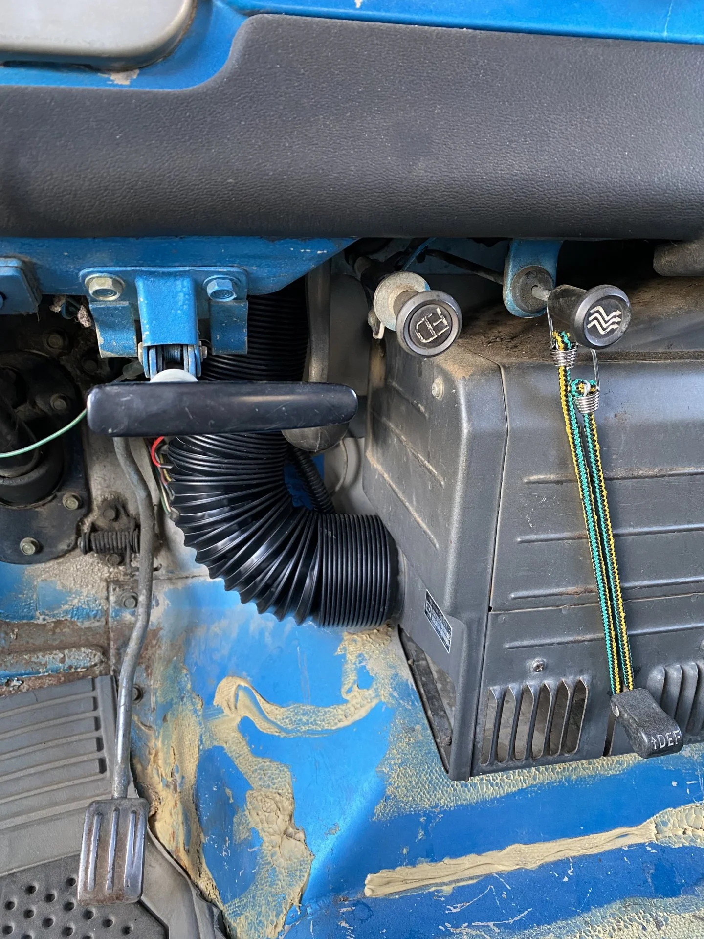

Our 40 was missing the drivers defrost duct. We found some flexible 2-1/2 inch hose meant for dust collection systems for woodworking equipment. Worked pretty sweet and doesn't interfere with the e-brake or transfer case shifter after a little massaging. Added a defrost lock-out device too. :hillbilly:
