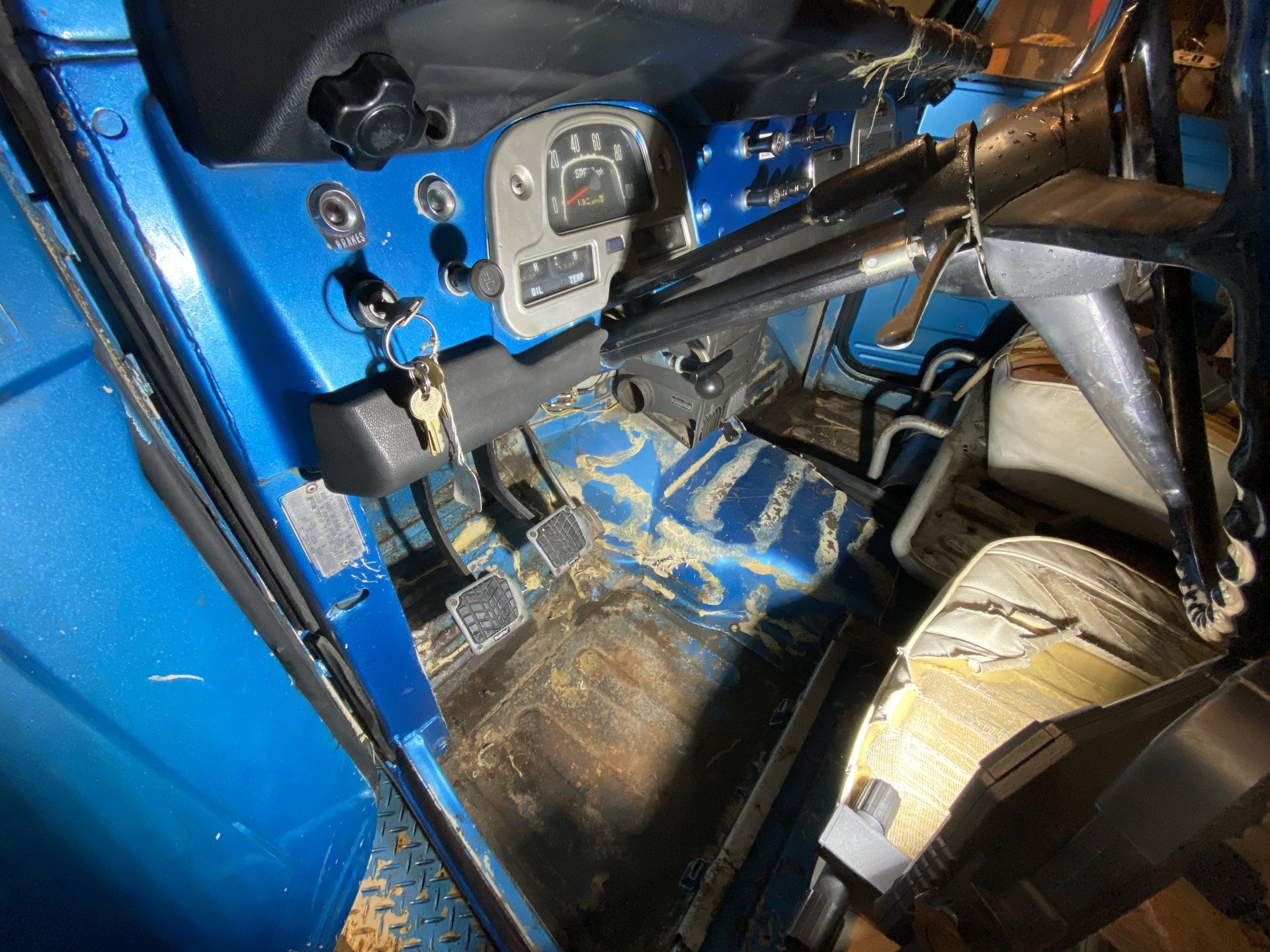

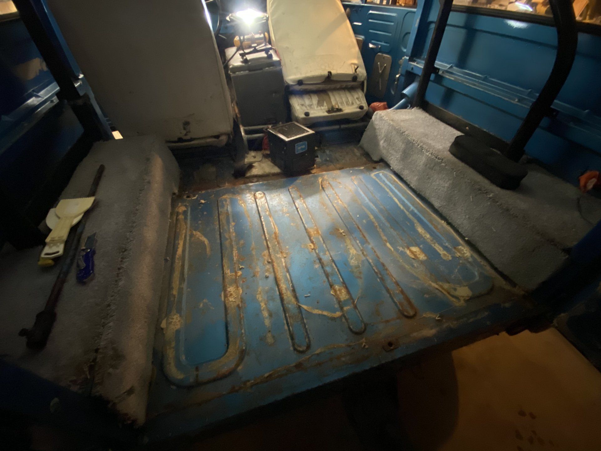

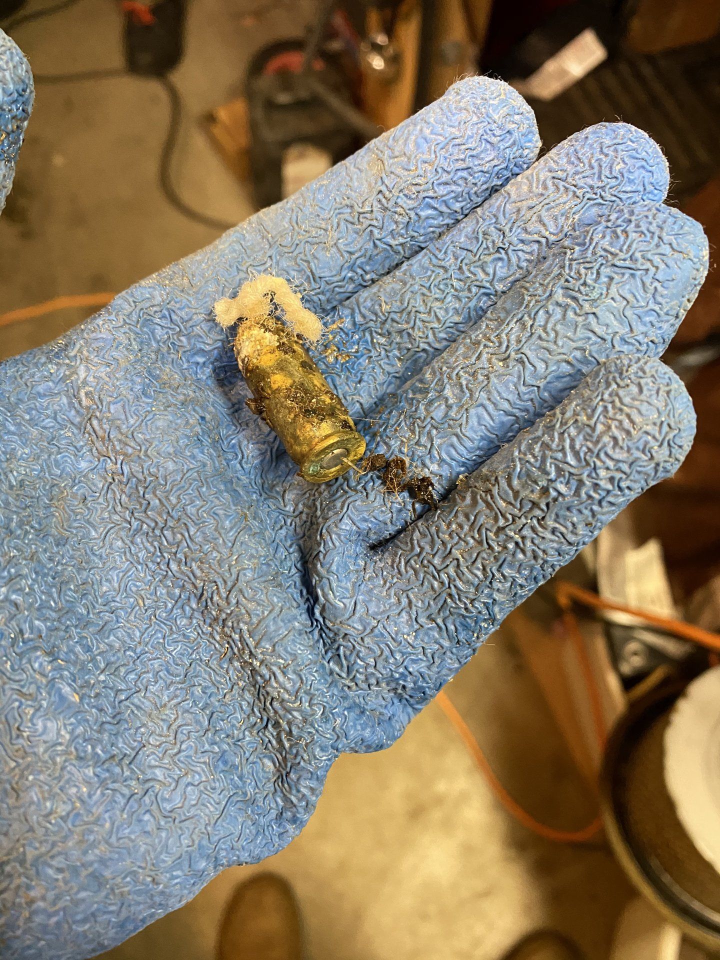

Clean up went pretty good this weekend. The Prospector could hardly wait to tear out the carpet. Found a few unspent cartridges, lots of seeds, and the mouse that was storing them. He was dead. Must’ve been some bad seeds.
The floor pans look good. Saw lots of holes missing bolts though. Gonna need a lot of fasteners.
Looks much more solid than mine!

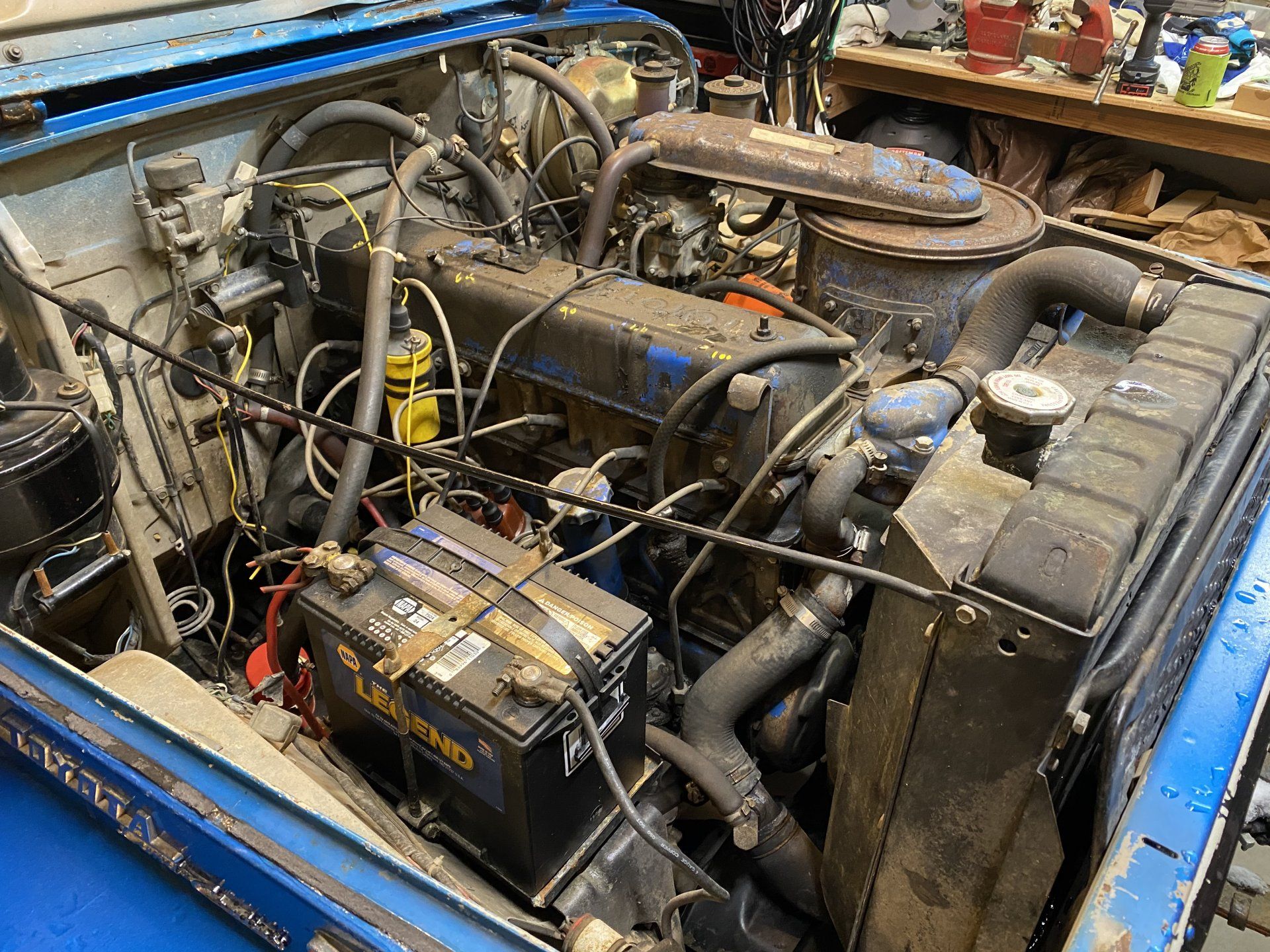

Looked over the engine a bit more closely. Seems in order except for the carb still not quite right and we've got a substantial oil leak. We replaced all the vacuum lines, and now it will idle without the choke. But any slight increase in throttle makes it die. For the oil leak, looks like timing cover. How much of a pain is the timing cover gasket? Anything out of the ordinary for that?
That timing cover gasket is a cinch, hardest part will be cleaning the old one off. Torque on those screws are low, keep that in mind.
There's some good info in a thread about the oil pan gasket in the FAQ.
timing cover is easy, the back plate is a bunch of work if you need to do that.
be cautious when installing crank seal
Oil leak= rust protection. I try to let everything leak a little.
Old unspent cartridges are worth quite a bit in todays culture = Cruiser parts.

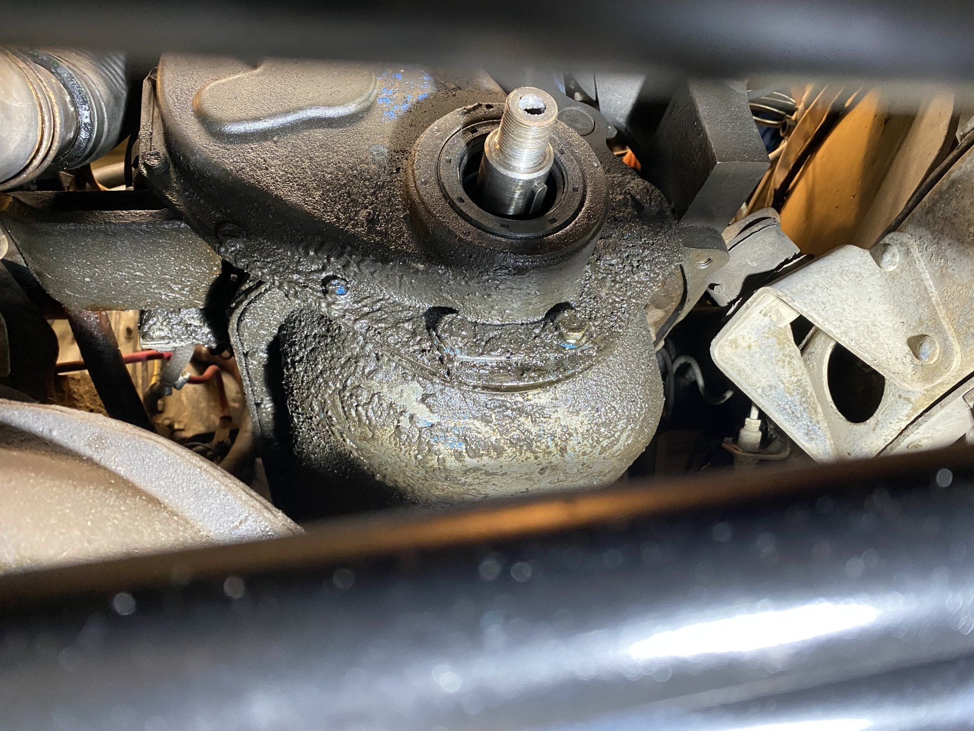

Unfortunately I've got to address this oil leak though. My brief pre-purchase inspection in the PO's garage showed a (un)healthy amount of kitty liter under the engine. I figured I'd be into it a seal at some point. We drove it about a 100 yards before purchase, just checking all the gears, 4WD etc. Maybe a total run time of about 20 minutes. When I got it home, prior to driving it off the trailer, i noticed quite a bit of oil on the trailer deck. I checked the oil and it was almost 2 quarts low. :oops:
This week, I pulled the rig into the garage, from the street. About 12 hours later I had an 8-10 inch diameter oil puddle underneath it. The majority looks like it's coming from the timing cover gasket. Fresh oil on the front and bottom of the oil pan, but not the top or sides. And the tranny and transfer case looks like it has been thoroughly sprayed down with 10W30 from being trailered at 60 mph.

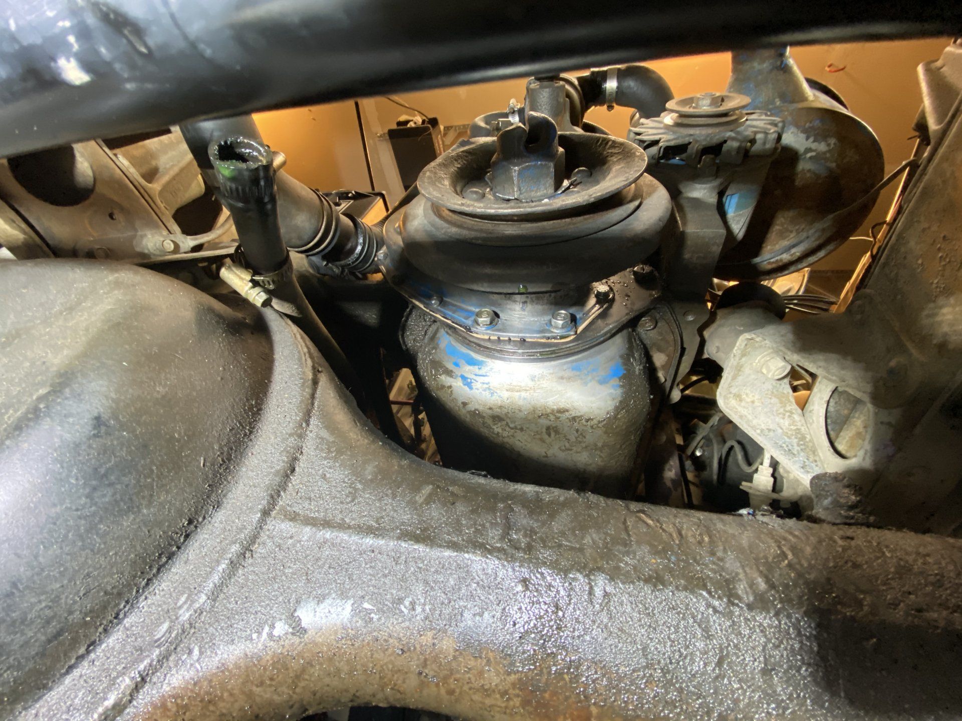

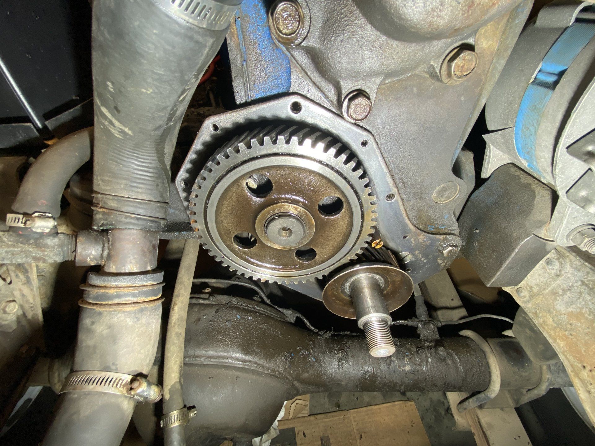

Chasing our oil leak, we went after the timing cover first. Everything took a little longer than expected. But since this is our first 40, we had a little learning curver figuring out what needed to come off and what didn't. We opted to remove the radiator, but leave the grill bolted in place. I'm guessing you can actually swing the grill down for some more room? We tackle rusty bolts only if backed into a corner. I hate rusty bolts.

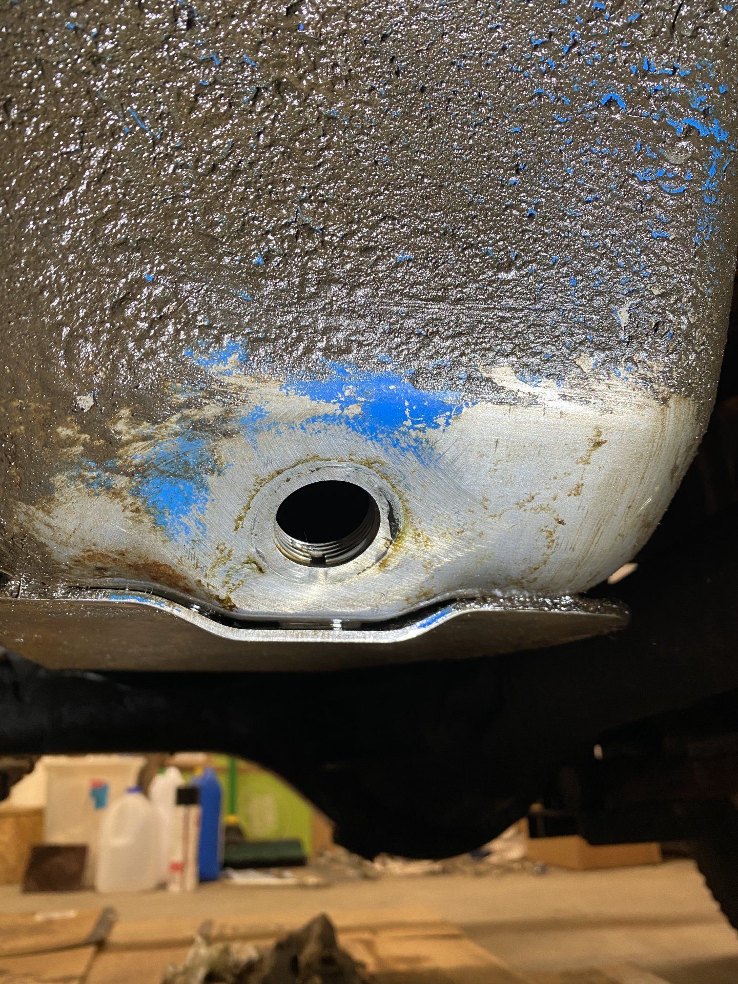

Draining the oil should be no surprises right? I bet the oil pan plug was in there about 70-80 ft lbs. What the hell? When I removed the plug I saw why they reefed it down so much. Threads all busted out. (Surprise!) Glad I got a new drain plug and washer on hand.

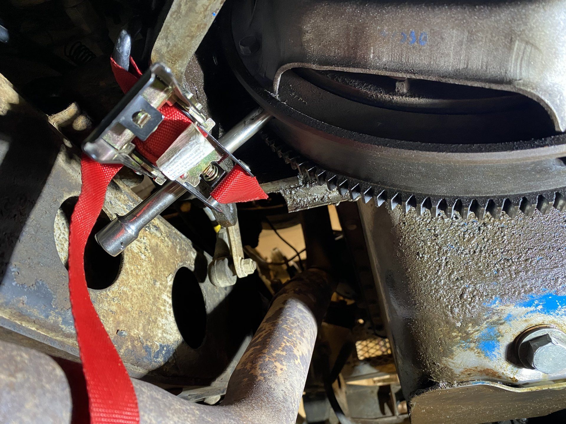

Our method of spinning off the harmonic balancer nut used a socket extension shoved up in the flywheel. Held the socket extension, wedged against the bellhousing, with a ratchet strap. Easy. Got the big ol' breaker bar ratchet handle and my new 46 mm socket. Gritted my teeth and hoped to get that big nut off and...that thing darn near fell off by itself. It was probably torqued down to 15-20 ft-lb! (Surprise!)
Now looking at the the Timing cover I notice it was missing two bolts. (Surprise!) The rest were all 8mm long except for the two big ones. Spent an hour at our local ACE hardware stocking up on metric bolts. They are obnoxiously shiny when compared to the others. We replaced the timing cover front main seal too. It was dry and not pliable.
Install luckily had no surprises. FIPG and new bolts for the win. Appreciate MUD members posting up torque specs and FSM pages. An excellent resource.

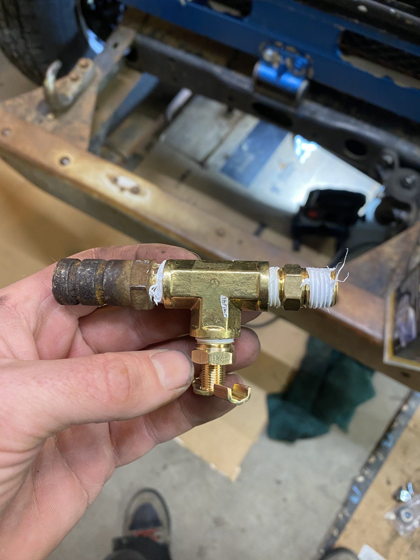

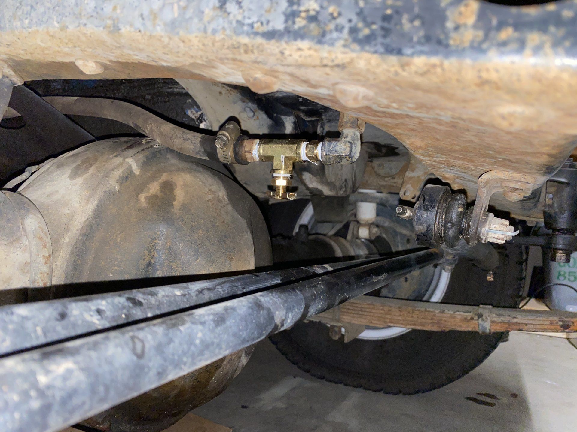

looks like the hose is already rubbing the diff.
hope there is enough clearance when the axle moves
that doesn't look like a hose barb fitting, looks like an air chuck type fitting
Good eyes! I totally missed that air chuck fitting. PO installed that bit.
Is there a bracket or something that is meant to keep the heater hose off the diff? Seems like it's out there exposed.
I might have to rethink this.
