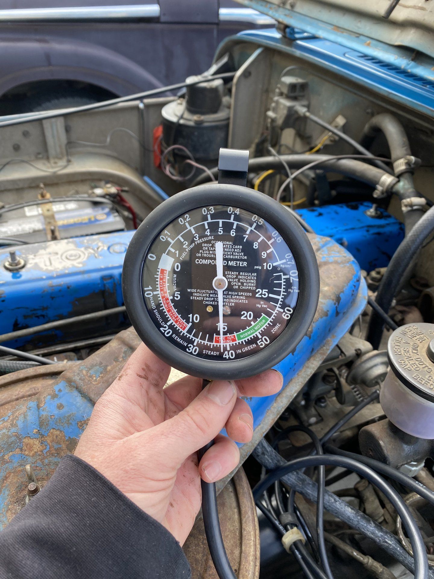

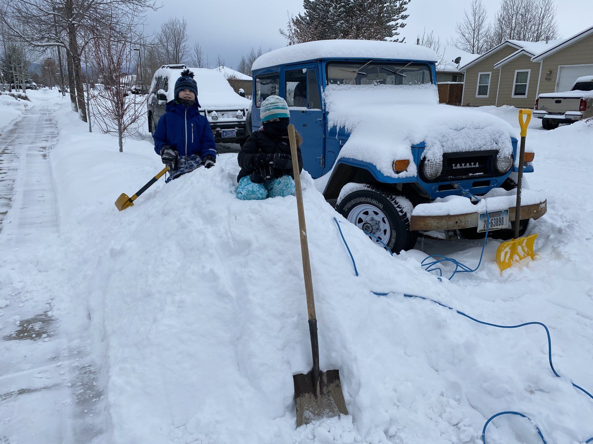

Finally got some free time to check my work. It's 5 degrees and full on winter Sunday. Mrs 90WT gets the garage for her car, so the 40 is chillin' outside for a while 'till this snow and cold go away.
Plugged in the coolant heater for about an hour while I shoveled snow and helped the kiddos build snow forts. Replaced the distributor rotor, which I broke last week. Pulled the choke, hit the key, and it started right up! After setting timing, idle mix and speed adjustment, I was super happy to see 14 inches of vacuum! I'll take it.

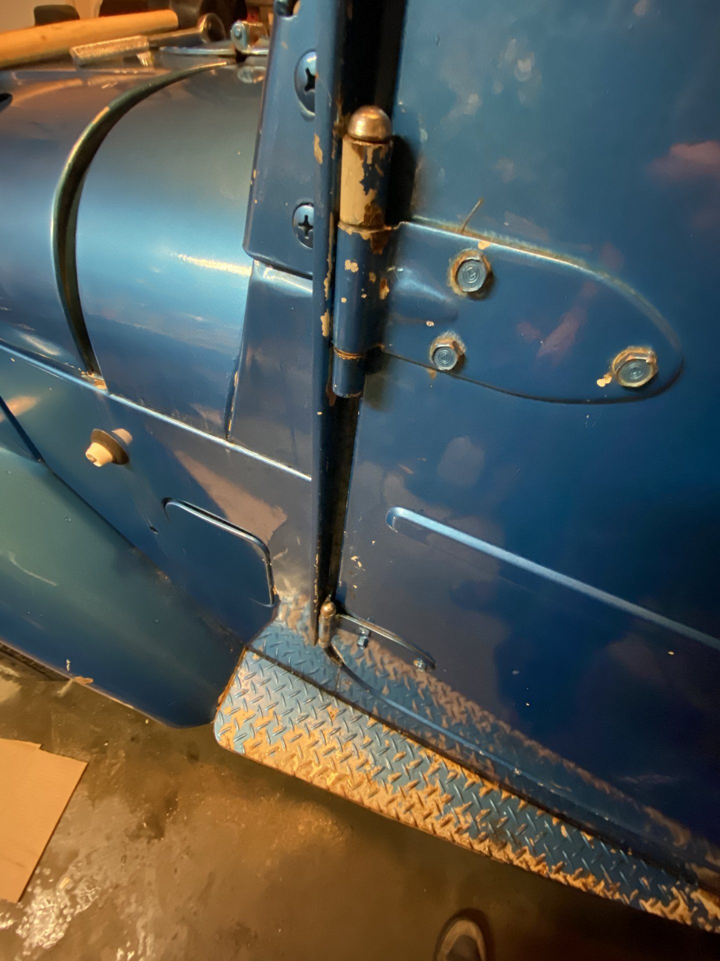

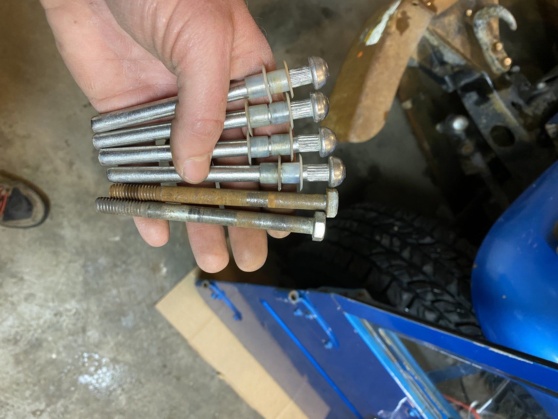

Replaced the grade 5 bolt hinge pins with proper hinge pins donated by @Purpleaction (Super cool! Thanks again!) Only got to the Driver's door side and it solved the rattle issues. Now you can really tell the passenger side is rattling at both hinges and the strike plate. Just used the plastic bushings for now. Got some bronze onces too, but will most likely wait until summer to dig into cleaning the hinges, repainting, and re-aligning the doors.

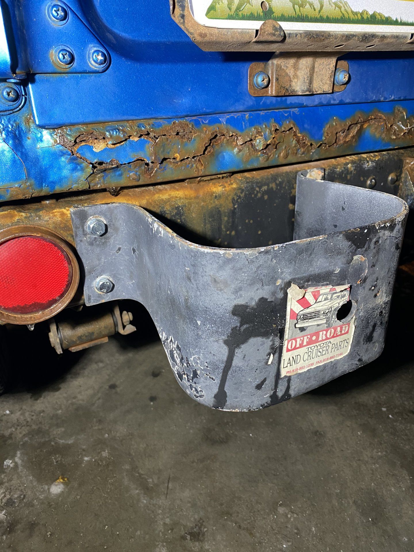

Installed some used bumperettes we picked up from @3_puppies a few weeks ago. We were hoping to pick up some vintage looking ones since our rig really has no shiny parts. I'm diggin' em. Required tapping the old holes since they were all rusty inside. I find cleaning rusty bolt holes oddly satisfying.

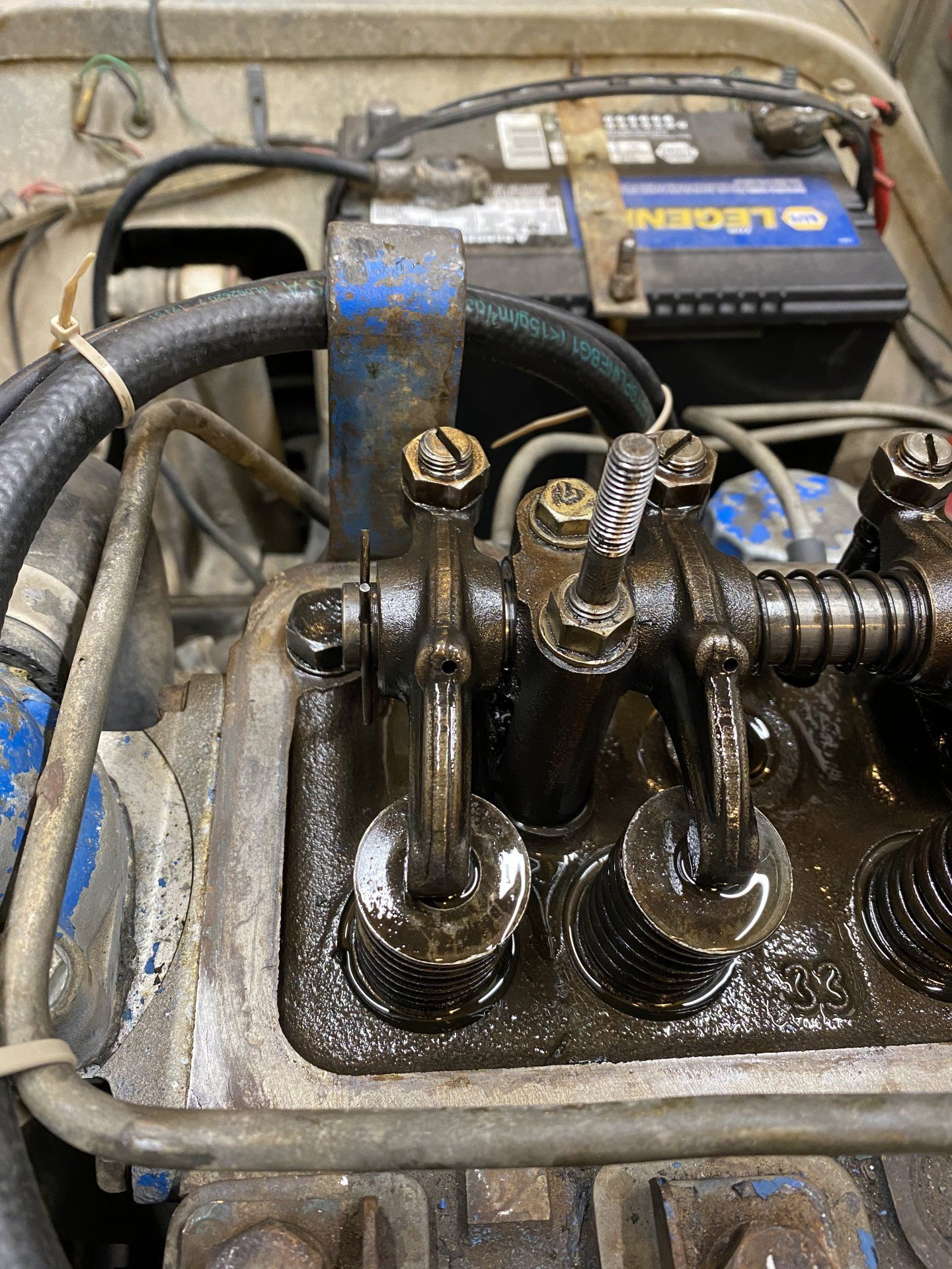

Back in the garage this weekend to adjust the valves. A little bit of a pain to get the cover off since the threaded studs from the head are long, and I've got a coolant line above the valve cover which restricts how much room I have to work. 9 of 12 valves needed adjustment. Several exhaust valves had no lash. Easy enough to adjust.
It was the install that took me on an adventure. In addition to the coolant line making it a pain to reinstall the valve cover, I had a engine lifting hook that was bent over the valve cover edge, just enough to pinch the valve cover between the lifting eye and valve rocker above the No 1 cylinder. I put some aircraft gasket sealer on the valve cover side of the cork gasket. And for the life of me, that stuff would not hold the gasket to the cover, and as I would try to thread the cover into place, the gasket would drop off. It was frustrating.
During this frustration, I decide the lifting hook needs to be straightened out of my way with a BFH. Easy enough. After a couple of whacks, from the corner of my eye I saw something go shooting off into space. I looked at my hammer. It looked at me. Back to work we went. (I should've paid a bit more attention).
With the lifting eye out of the way, and waiting overnight for the aircraft gasket seal to get more tacky (garage temp was 40), the valve cover went back on in minutes. While connecting the battery terminal, I noticed the retaining clip for the end of the valve rocker assembly. :doh: . Everything apart. Clip installed, Everything back together.

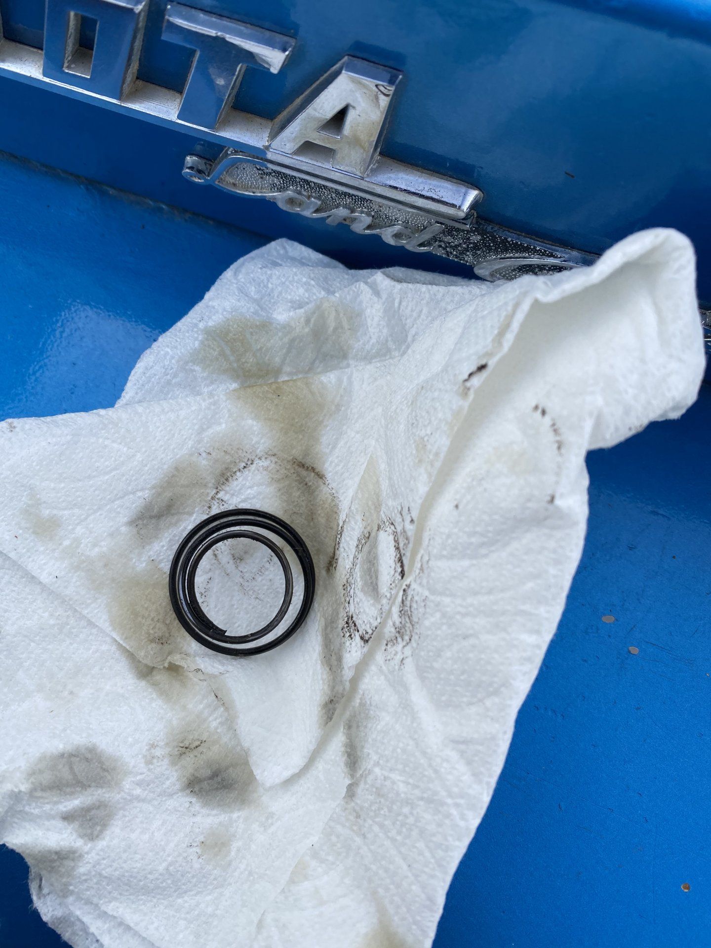

Now for the startup. Engine sounded smooth, except for a new knock. Definitely a new knock. At the No 1 cylinder valves. A long crowbar for sound transmission confirmed a tink valve sound above the No 1 cylinder. As I stared dumbfounded at the block, I noticed another valve spring hiding out on the water pump. It was the round one to go between the valve rocker arm and the retaining clip. :doh:.
20 minutes later (I'm getting faster, like nascar pit crew faster). Engine is purring again. No valve knock. Adjusting the valves gained 1 inch of merc, for a total of 15 inches vacuum. Hell yeah! (Beofre we started the tuneup in January we had only 7-8 inches vacuum!)

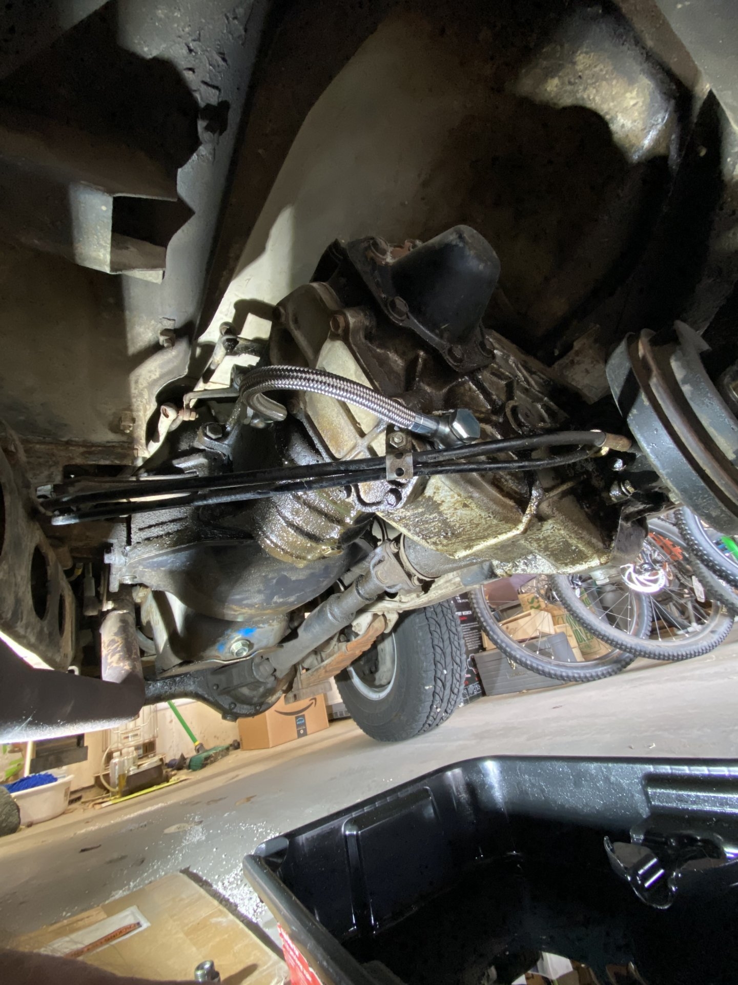

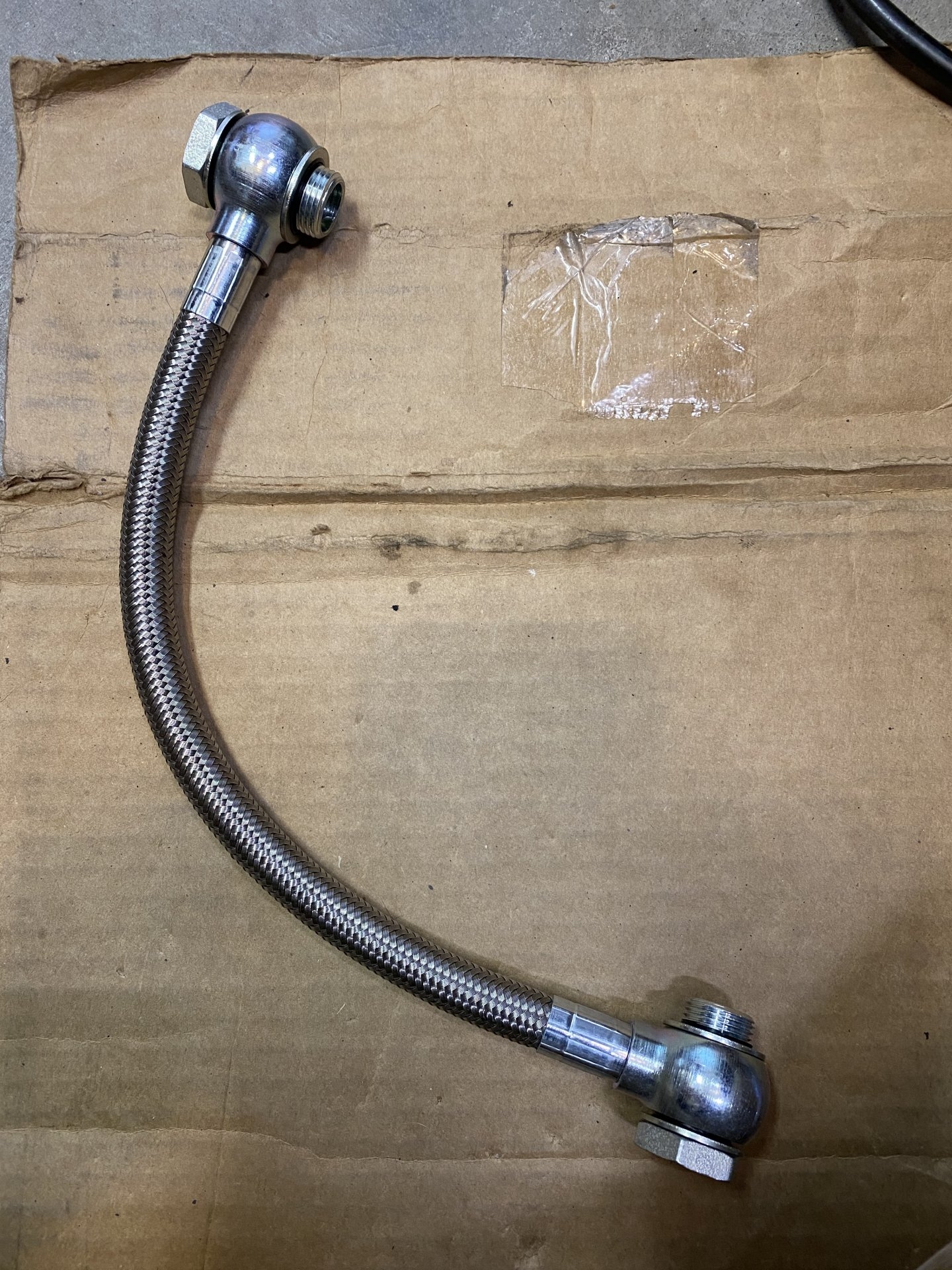

Our transmission is a lush and insists on stealing from the transfer case.
Super trick hose from @shipmag should help even things up.
If we can keep the 85-90 wt in the cases, might even clean down here too.

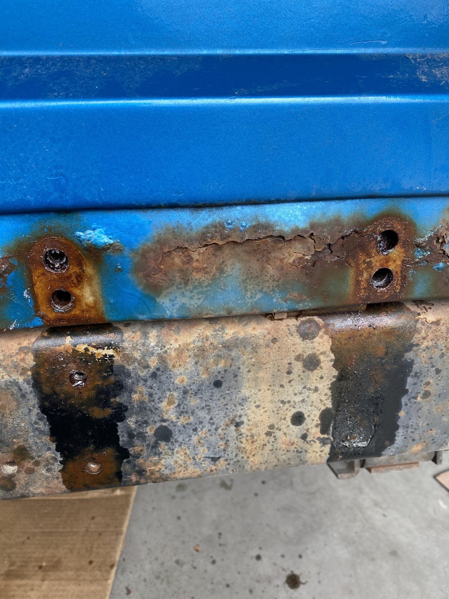

Got a used tire carrier hook we're trying to get on.

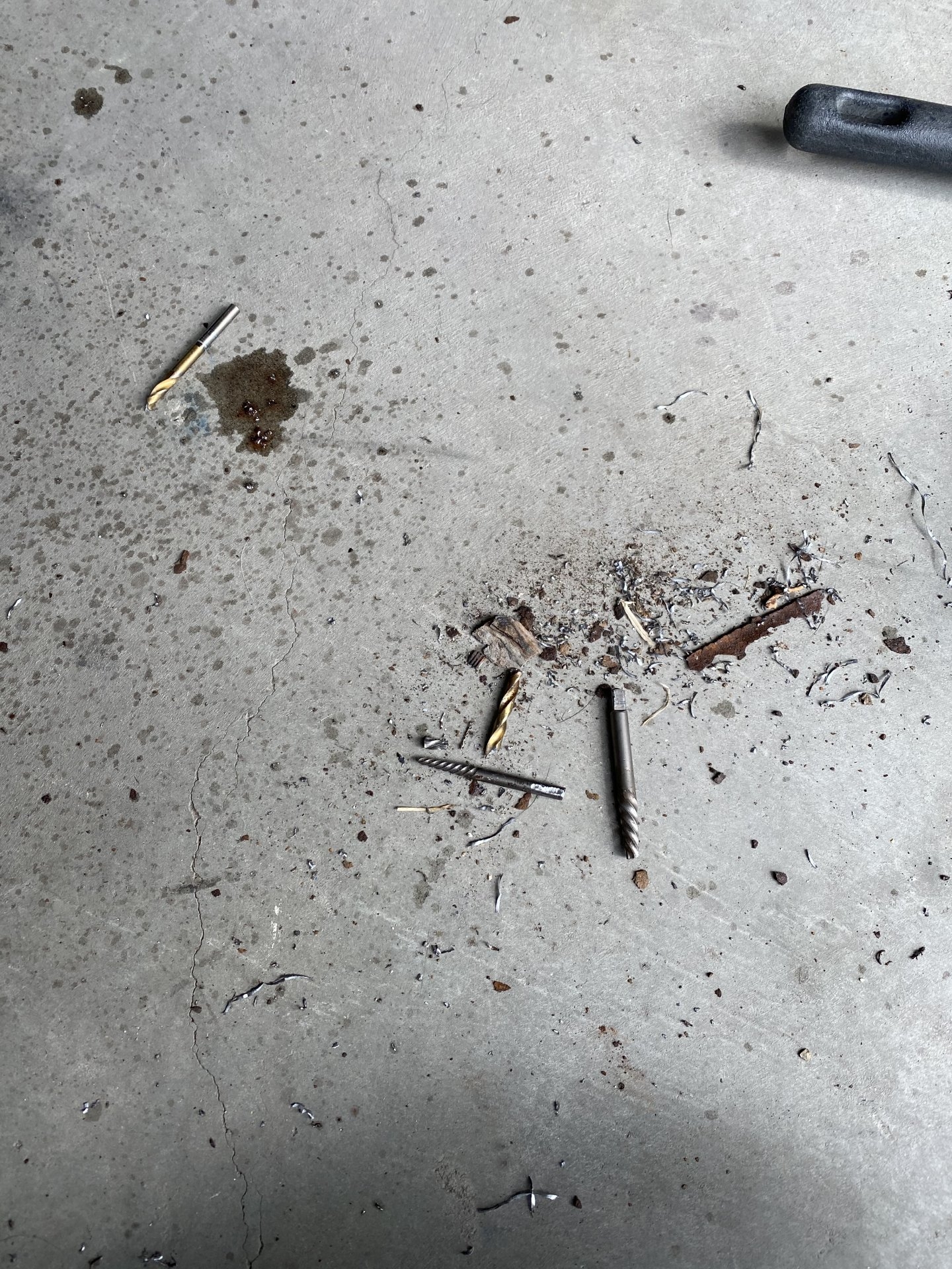

3 rusted bolts busted by someone long before us, and one body nut that we could thread tap.
The sheet metal behind behind the area is pretty wasted. We'll end up with 3 bolts, two will be through bolted with washers on the back.
Gotta hit up ACE for some longer M8s.

Thanks for the plug still have both sizes in stock. Looks like a excellent install on the hose.
