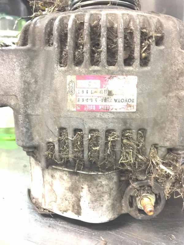

Yeah they left the ALTERNATOR for that. ;)
Put it at the lowest point they could find. Right below the Power Steering pump/reservoir....so IF that leaks (as they all do eventually) it gets oil soaked and ruined.
And where is an alternator most susceptible to water, dust, dirt, debris intrusion? Why right at the bottom of the engine of course.
Yeah.....a Soccer Mom will never care where those two items are located....but if you Off-Road your vehicle and have an issue, it can be something less than convenient to change out/repair when you're way out in BFE.
