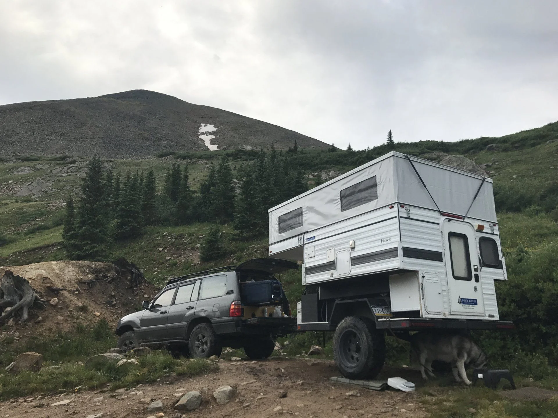

A four wheel pop up camper that’s on a flatbed trailer. We love it and it works well for us. Here’s a picture camped at an old mine site halfway up Hancock Pass out in CO last summer.

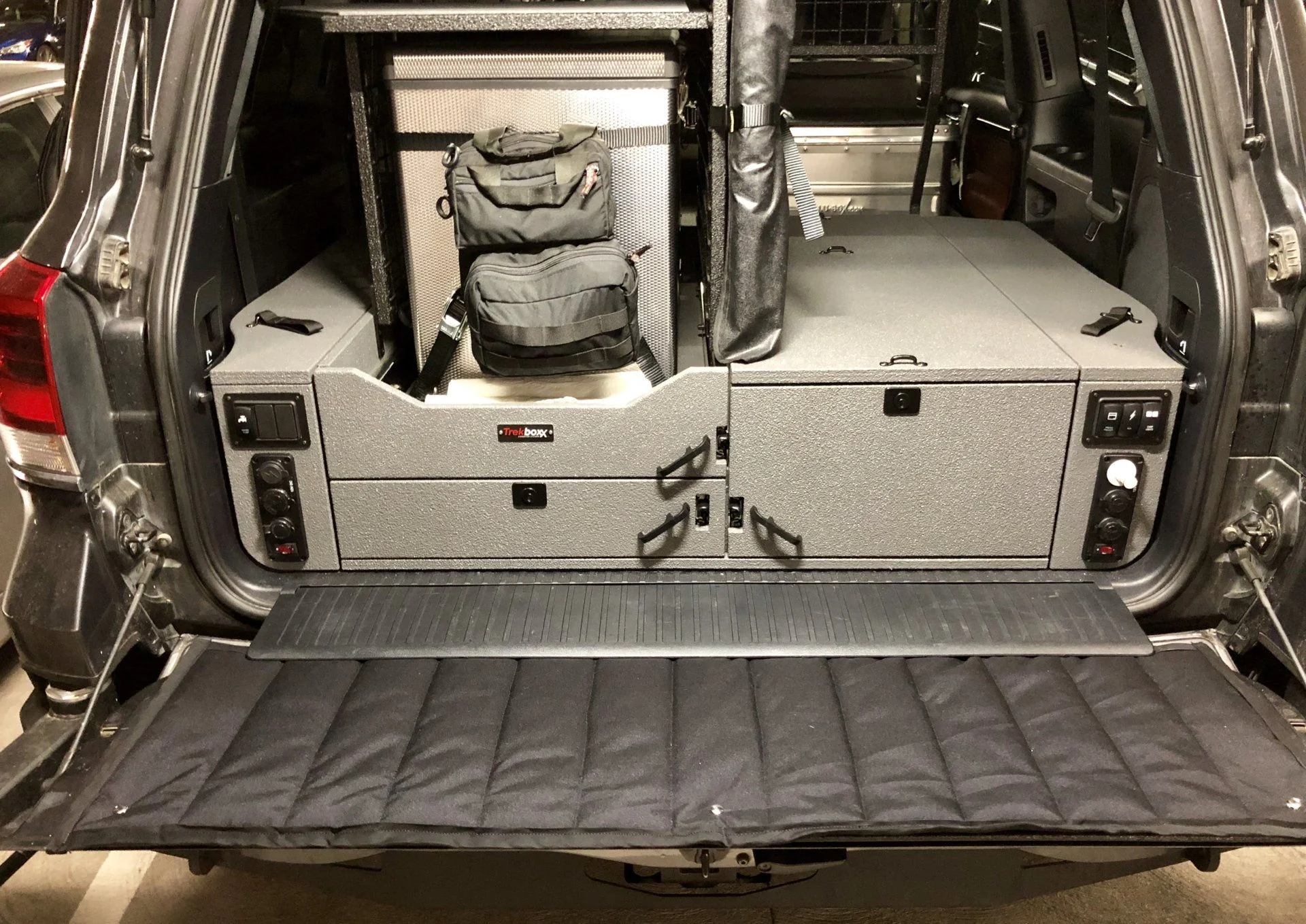

I'm only storing lightweight, soft goods in the tailgate... right now there's a tow strap, a kinetic rope, a Cgear Sand Mat, and a tarp. You lose the torsion bar with this modification so the tailgate requires more effort and care to open and close.
Hi Cole, with the new tailgate storage mod and added damper (w/ out torsion bar), how does the tailgate open now? Does the damper slow down the fall at all? Thanks! -chris
I'm sure it helps a bit but it's hard to tell. I probably have 10-12 lbs of stuff in the tailgate so most of what I'm lifting is the cover and tailgate itself. It feels pretty heavy compared to the stock tailgate with the torsion bar.

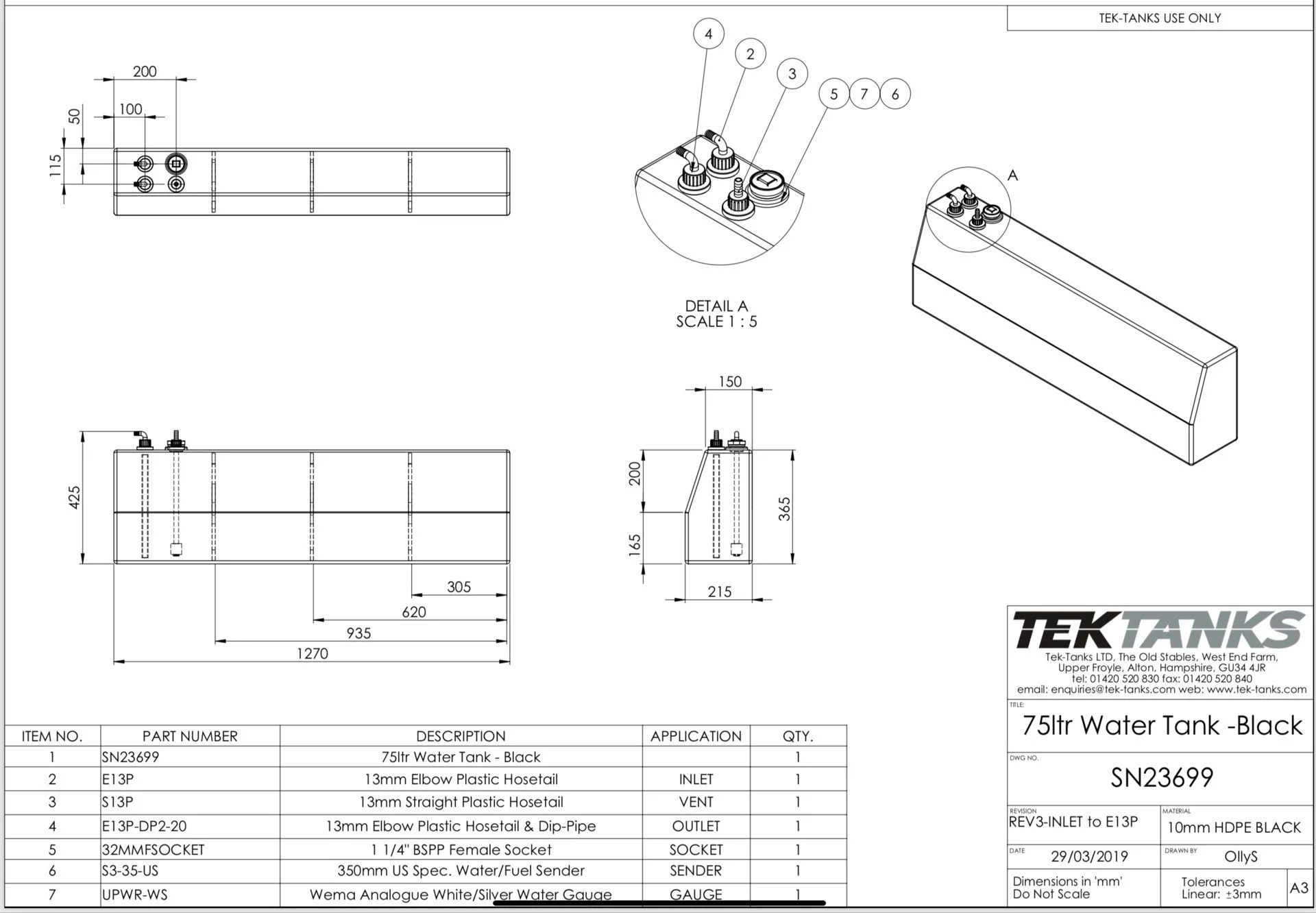

I've gone ahead and put an order in for a custom welded plastic tank complete with baffles and all fittings on top (using a pickup for the outlet) for the footwell. I made a cardboard version to test out the sizing and then reduced the dimensions a bit just for some margin. The total capacity will be 20-25 gallons. I'll also need to make a simple platform to accommodate the hump in the middle. I did not want to design around the hump because it makes extracting all the water difficult. With this update I'll also be adding a sender unit along with a water gauge. If there's enough room, I'll also place Dynamat and perhaps a layer of bootliner around the tank to help with noise.
This tank helps me do two things: 1.) get as much water as far forward as possible, and 2.) open up the area below the middle row for storage of my heaviest items (mostly tools, the Cook Partner stove, and spares). After shifting stuff around I have about 15 lbs of gear in my left drawer and around 20 lbs of gear in the right drawer. Both side cubbies / wings are empty. Of course, there is as 65 lb refrigerator that will house 50 lbs of beer on one side. Overall, it looks really clean. I added some more tie downs as well (guess I should take some photos).

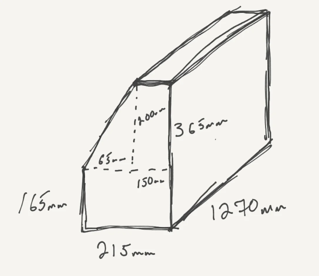

Official drawings of the new water tank. IMO this is the most water you can cram in the second row footwell while using a platform or potentially even keeping the seats in for dogs.
Looking forward to replacing the two current tanks with this one. Plus, it’s black instead of grey like the existing tank so it won’t stand out as much. In preparation, I also ran an additional water line to the rear drawers along with a switch. It should be a nice additional access point while cooking.

I'm curious about cleaning the tank; are you planning to add a removable access panel for cleaning? Of course you always have bleach and other chemical options, but IMO a mechanical cleaning is best.
I'm being lazy, what volume are you looking at? Looks to be a bit under 26gal?
It’ll be about 20 gallons. The funny thing is that I used to carry 4 Jerry Cans in the same spot with just about the same amount of water. Of course, there are some benefits to having everything in one tank but with the time, energy, and money I’ve put into OBW I’m not sure it’s that much better than the old Jerry can setups I had. We’ll see!
I’m also picking up a couple inspection hatches but am not convinced that I’ll install them. The bleach method has worked well enough with the other two tanks and many, many years with jerry cans.
