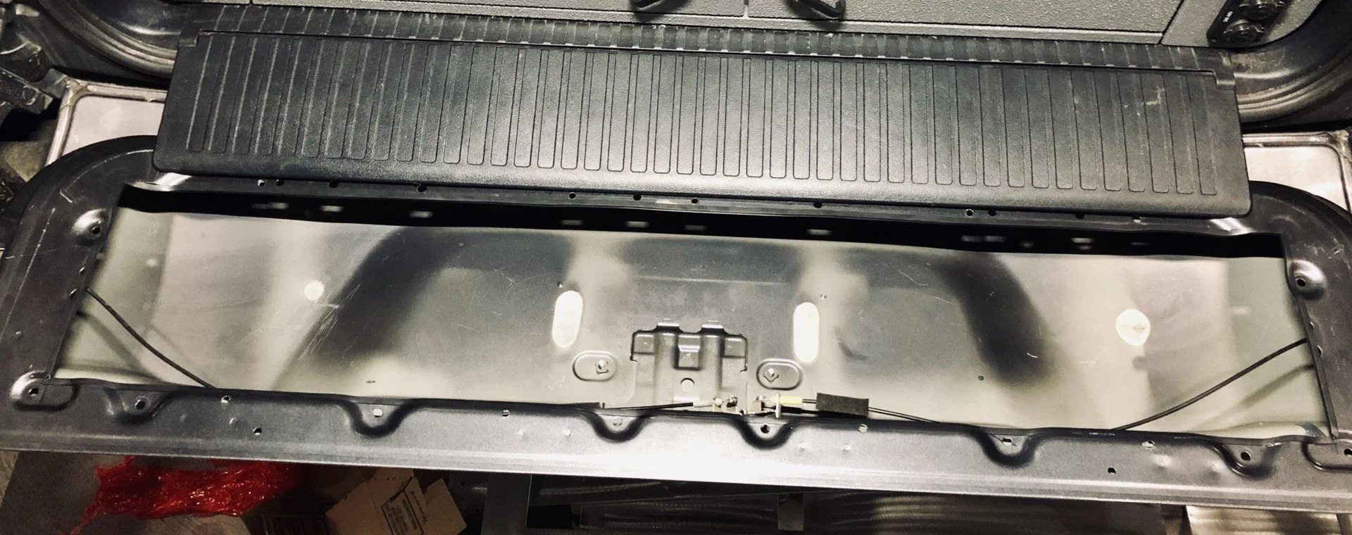

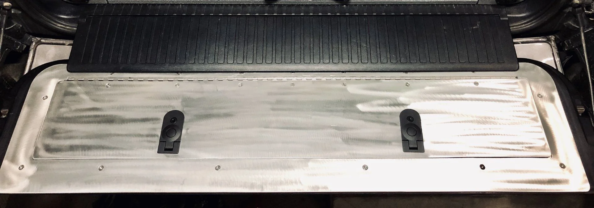

Yeah, the cover itself will receive LineX and the interior will have a layer of Dynamat and covered by boot liner / truck liner (whatever it's called). On that note, here are some photos of the installation today. I wanted to go ahead and install it prior to LineX to get all the preparations out of the way. Also, more importantly, I was going crazy after just one day of not having a functioning tailgate.
I cleaned up the inside of the tailgate, plugged a couple areas with silicone sealant, touched up the cut areas with paint, secured the control cables with wire guides, and installed some rubber trim along the edges.

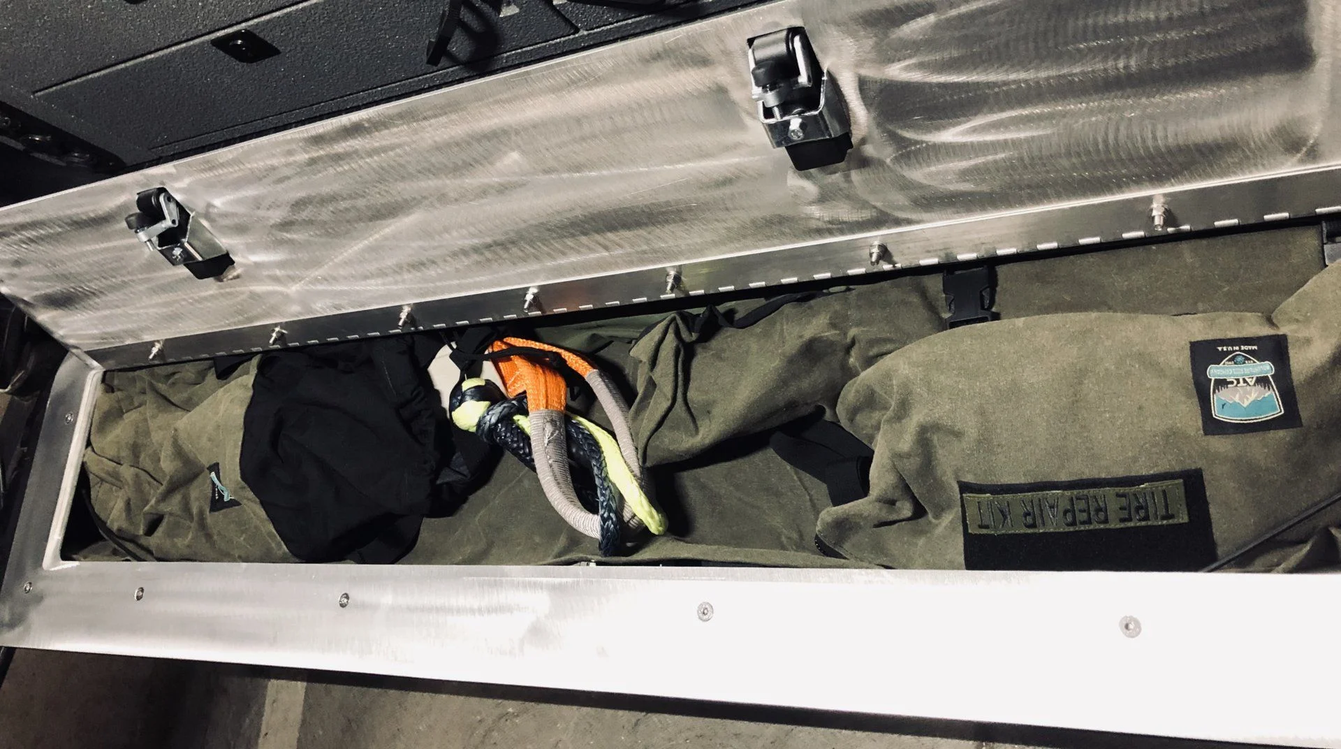

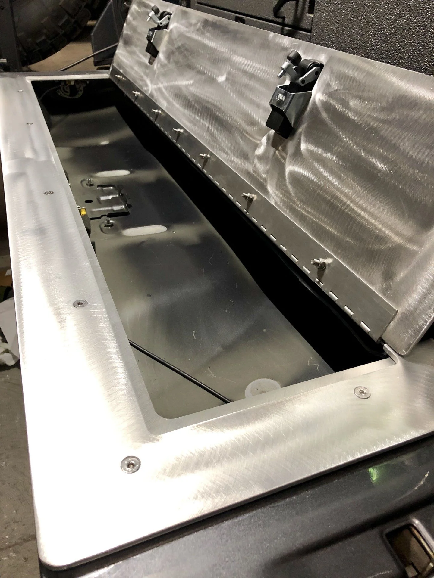

Here's the raw aluminum cover all finished up. I need to take a pass on checking/aligning some but I'm not in a rush since I'll be taking it all apart again soon.
Side photo to give you a sense of the amount of storage space within the tailgate.
For now I placed a canvas tarp in within the tailgate while I wait for sound deadening and carpet to arrive.
Tailgate loaded with lightweight, bulky stuff.
So far it's an interesting mod and opens up a lot of extra room in the tailgate. The Trail Tailor kit is really well thought out and works well. More to come soon on this one.

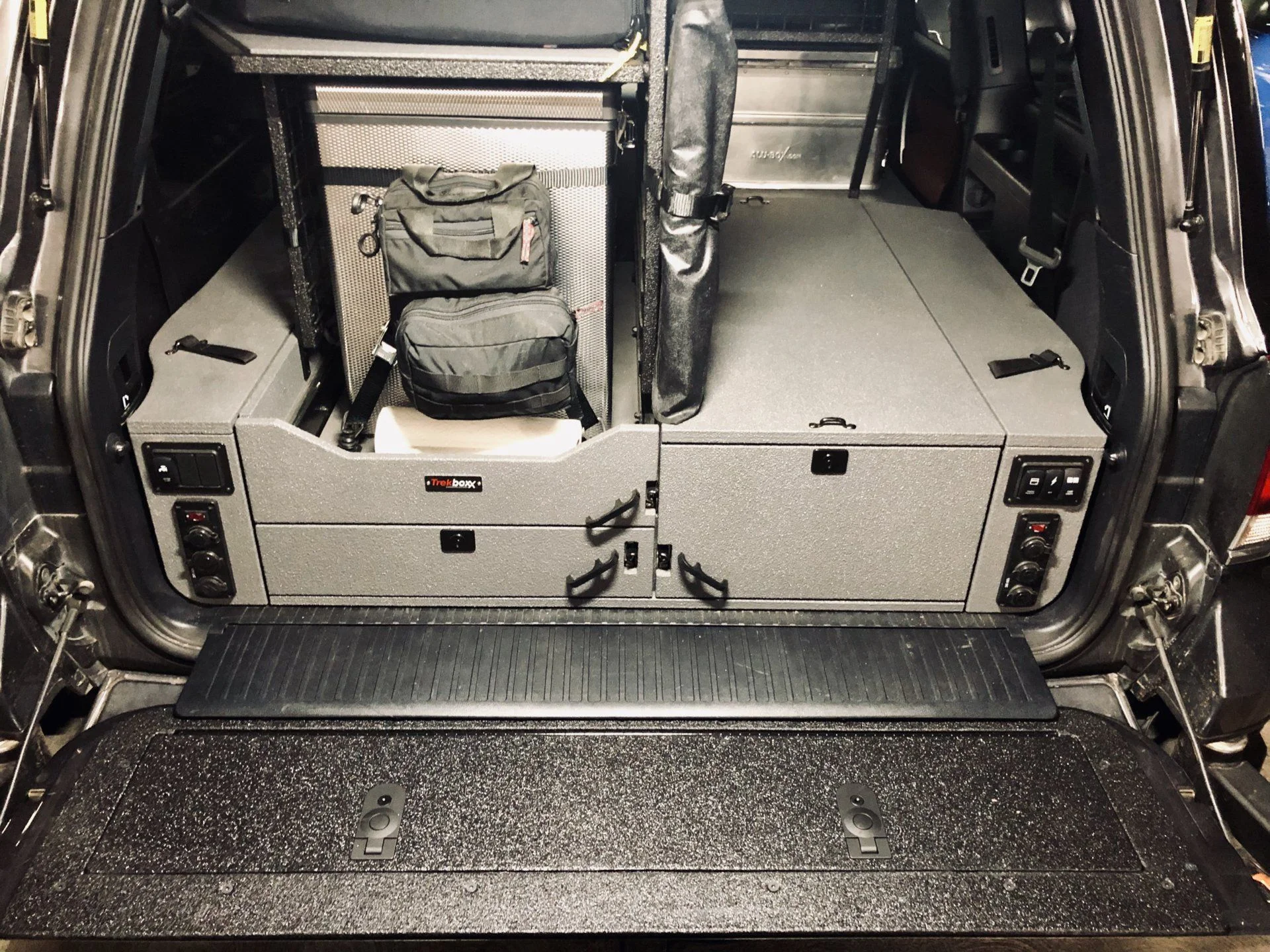

Finally crossed the tailgate cover and the bumper storage box off the list this weekend. The process was trickier than I'd planned as the LineX shop applied the coating to some edges that I'd requested to tape off due to tolerances. For the tailgate, this meant that I needed to shave off a couple edges, tape everything off, and reapply primer and paint while the cover was on the truck. Otherwise, the lid would not close. If you want to LineX a tailgate cover, I highly recommend only applying LineX to the top surface and exterior edge of the top panel.
I'm only storing lightweight, soft goods in the tailgate... right now there's a tow strap, a kinetic rope, a Cgear Sand Mat, and a tarp. You lose the torsion bar with this modification so the tailgate requires more effort and care to open and close.

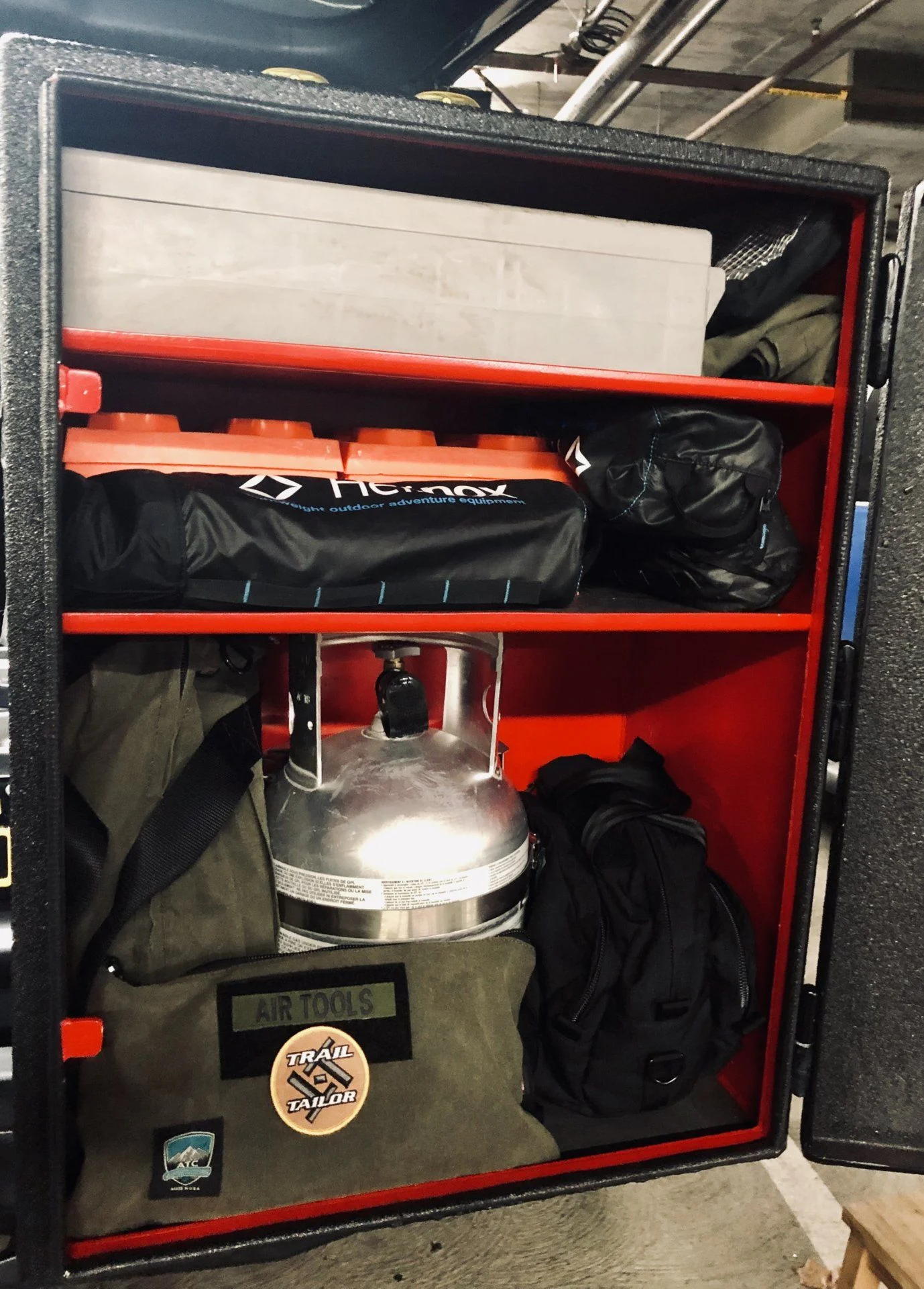

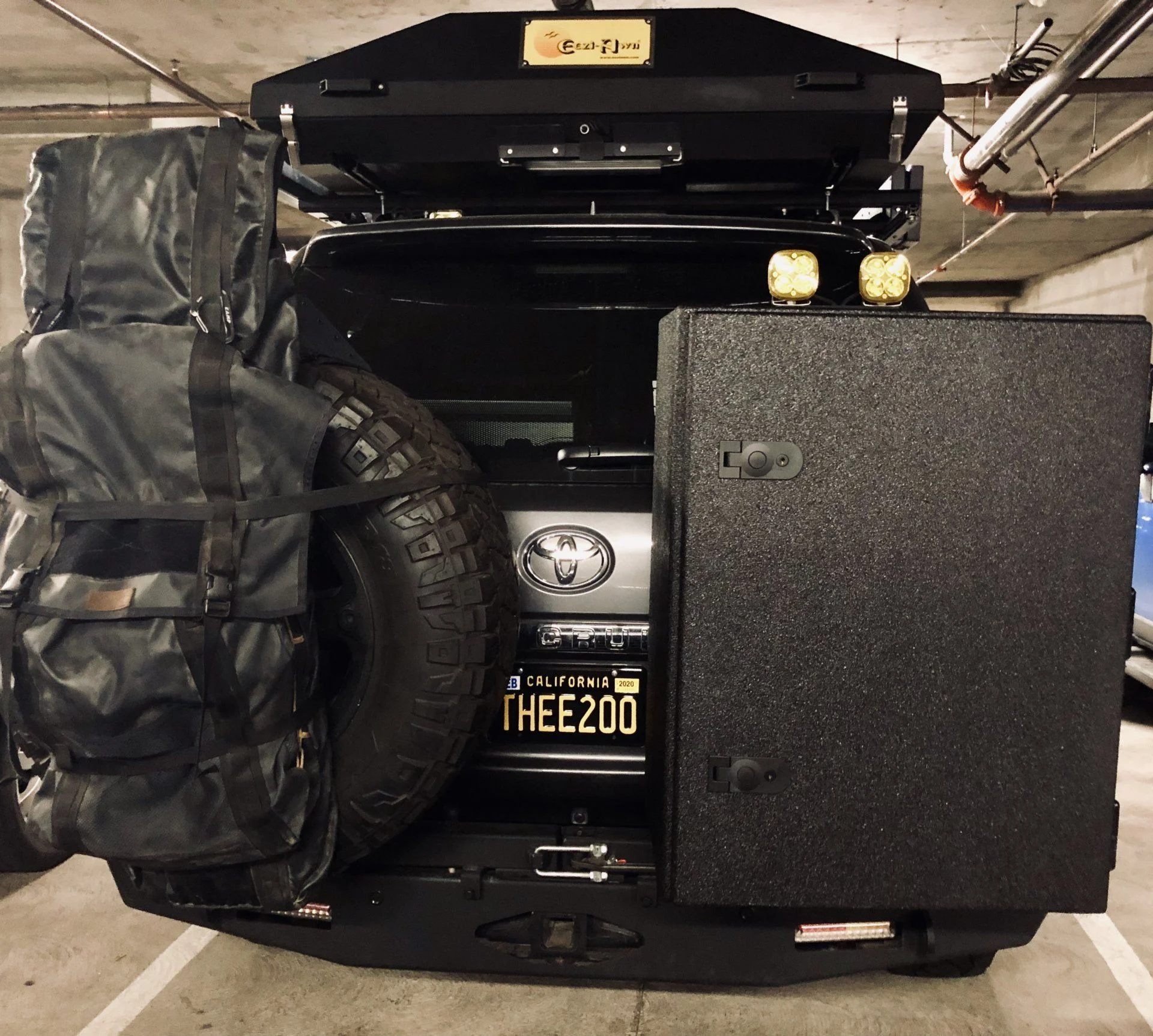

I don't think I've posted any photos of the rear storage box? This is a 30 x 22 x 15 box secured to the bumper swingout. The box and contents weigh in at about 100 lbs (just a bit less than the spare tire + stuff I kept in the Trasharoo). I decided to try out a box on the bumper to provide convenient, secure access to some bulky camp/recovery items that also can get dirty.
The outside is LineXd black and the inside was painted with red Rustoleum. There's a neoprene mat on each shelf and the propane tank is secured with a Powertank propane mount. The propane mount has 2 screws that are mounted only to the box and 2 screws that go through both the box and the swing arm ladder. There's a sacrificial mounting plate and a layer of neoprene between the box and the swingarm.
I did hit some snags getting the box finished. The LineX coating was applied to some edges around the door which made the door impossible to close. I had to grind down the edges then repaint them. I also mixed up my M10 and 3/8s hardware and ended up putting M10 nuts on 4 3/8-16 screws to secure the box to the swingarm. I didn't notice much of an issue until I hit each piece of hardware with the torque wrench and they wouldn't budge. It felt like each one had stripped on the inside. I was pretty confused until I realized that I mistakingly grabbed the wrong box from McMaster. Out came the grinder again and I zipped off each screw head with a cutoff wheel.

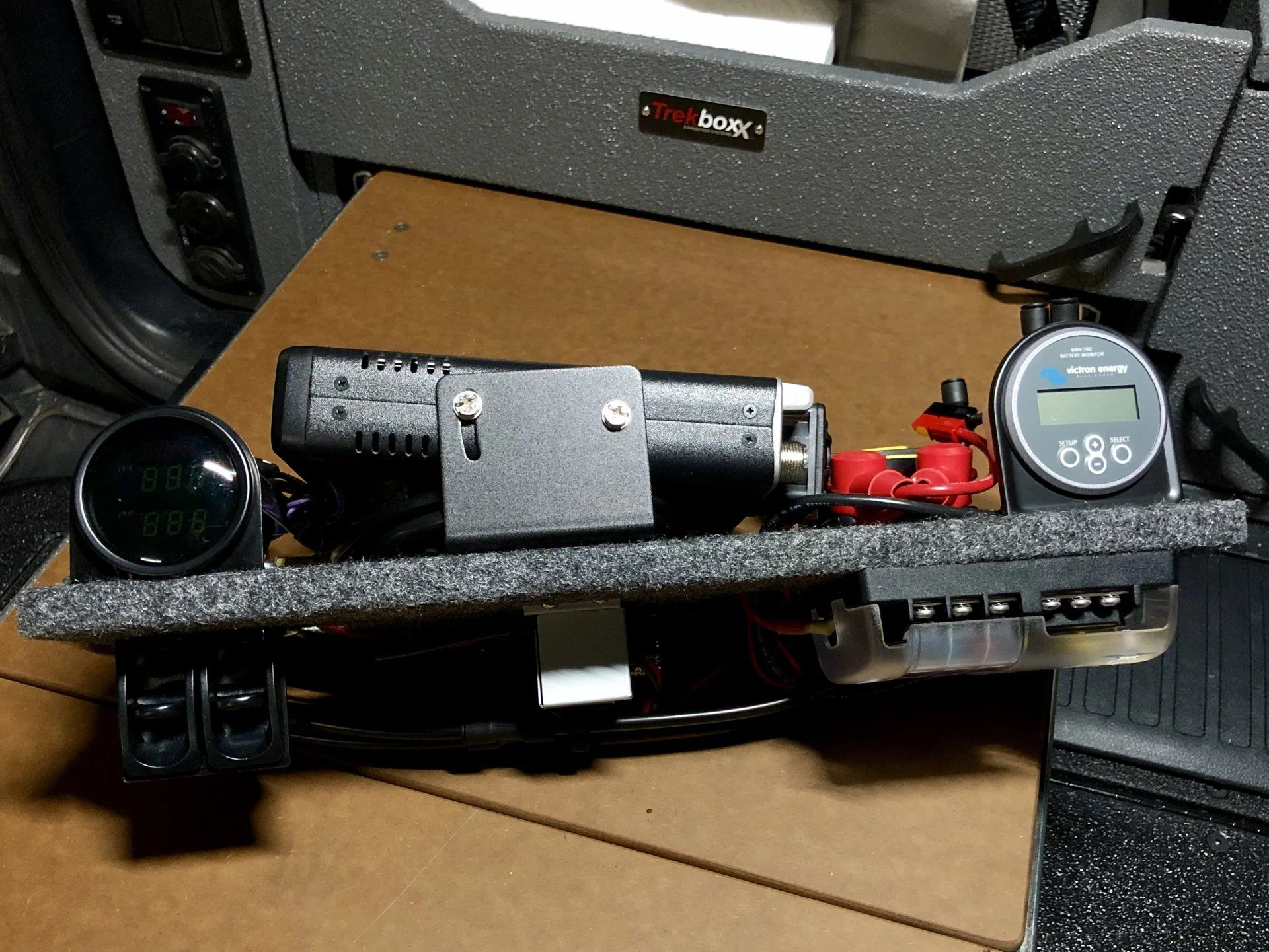

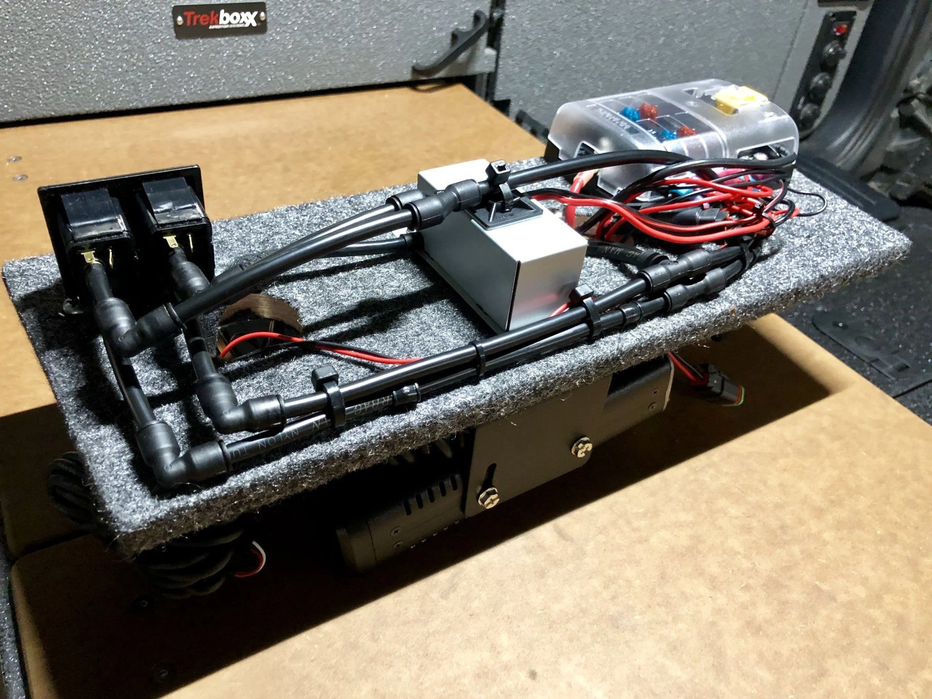

In today's episode of "one thing leads to another" I replaced the plastic glovebox shelf with some baltic birch plywood wrapped in boot liner. I followed the same contour as the plastic shelf and lined the inside of the glovebox shelf ledge with felt tape on the walls and velcro on the ledge itself to keep the shelf in place.
Why? Well, I'm working on installing rear coil helper airbags and went with the full control system to set each bag pressure independently from the cab. I'm hoping to use the airbags for a bit of leveling help for the RTT (though I'm skeptical that I'll get that much height differential). The control setup requires placement of a couple paddle switches (left and right airbags) and a 52mm gauge. A while back I stopped storing stuff in the glovebox and began using it as a compartment for mounting electronics — radio head units, battery monitoring, sat phone, etc.
In order to make room for the airbag control kit, I needed a more flexible mounting surface than the plastic shelf. I also wanted something that was serviceable and easy to disconnect. I also upgraded from bus bars to a fuse block + circuit breaker and replace my two National Luna battery monitors with a Victron BMV-702 that monitors the capacity, amp draw, and instantaneous power consumption of my aux battery (as well as the voltage of my starting battery).
The glove compartment now has 3 air lines running into it, 12v power from the aux battery, dual USB charge circuit, the ham radio, the CB radio (had to reinstall it for Cruise Moab), power for the rear view camera, the airbag control gauge and switches, the battery monitor, and I left some space for a Redarc trailer brake controller. The wires and air lines may look a bit messy when installed in the glove compartment but it's par for the course as they're service loops so I can pull it in and out without stressing the cables.
