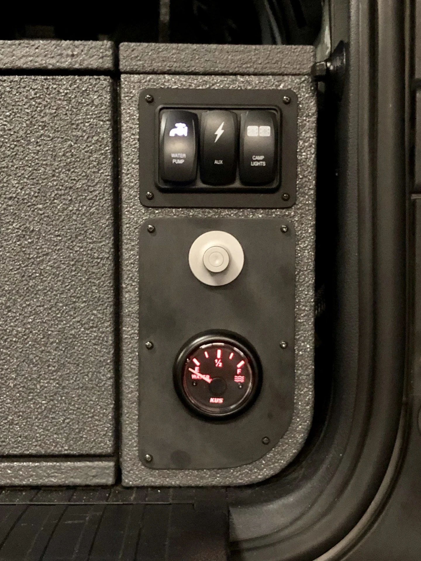

Finished up another chore tonight. I added a Wema (now KUS???) gauge to the main water control panel on the rear. I cut and sanded the mounting plate from some ABS I had laying around. The quick disconnect above is 1 of 2 outlets for the water system. This one will mainly be used for the shower, cooking, and cleaning. The one closer to the tank is for filling water bottles and hand washing.
The gauge features a decent red backlight that is only on when there is power to the water system.

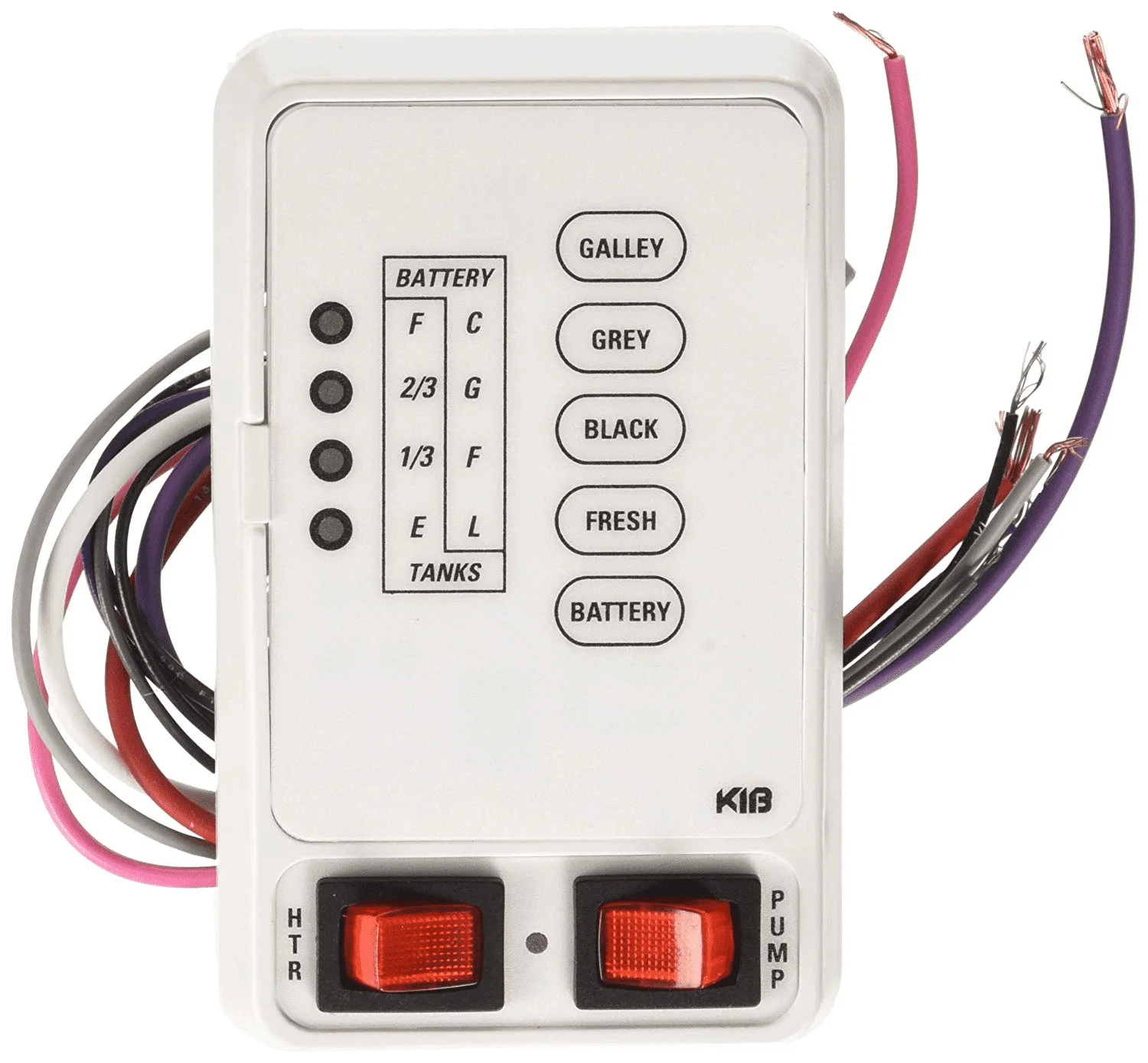

Nice, that beats the hell out of the gauge in my trailer, which has a total of 4 lights to tell me full, 2/3, 1/3, and empty.

How do you determine water level? Did you add a float? Or do you have an external ultrasonic strip on the tank?

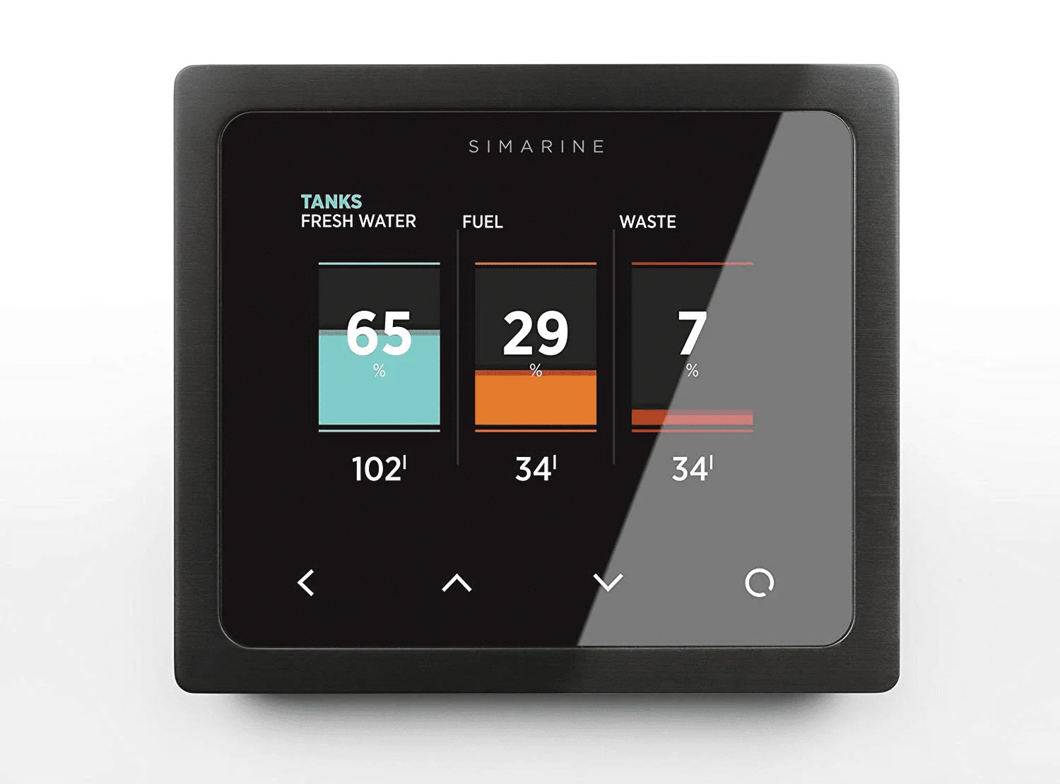

Side note: I picked up the Simarine Pico recently and am going to try it for battery, tank, and solar charge monitoring. It's probably overkill for your setup but if it works well I'll let you guys know as it not only displays real-time amperage use and temperature draws but also stores historical usage (so you can see what your true amperage draw or temperature is of your fridge over the course of a trip, for instance). There are shunts for monitoring things like winch load, inverters, multiple batteries, fuel tanks (aux tank?) etc.
https://www.simarine.net/wp-content/uploads/2018/03/SIMARINE-Product-Portfolio-2018-web.pdf
1951389
1951391
An all-in-one unit would be pretty cool... definitely a good fit for a trailer. I have a shunt on the aux battery right now (Victron BMV-700 Series) and that’s been pretty cool for monitoring usage though I haven’t gotten around to fully calibrating it yet.
I’m using a basic tank sending unit (WEMA USA) but don’t have that piece installed, yet (waiting for the tank to arrive).
I was considering the BMV-712 but I'm a sucker for technology and so I'm going to set up the Simarine Pico. Hopefully it'll be worth the extra $380...

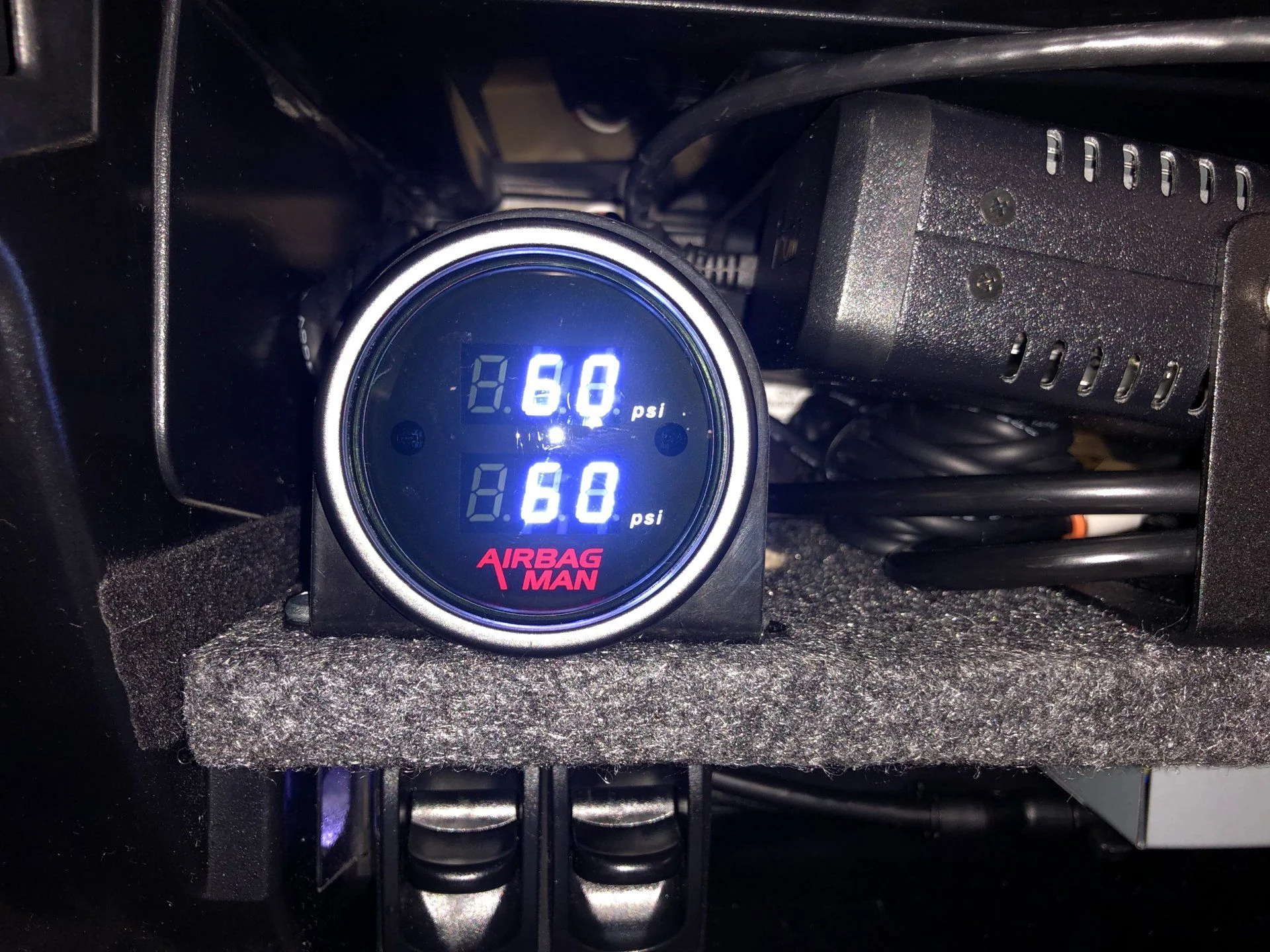

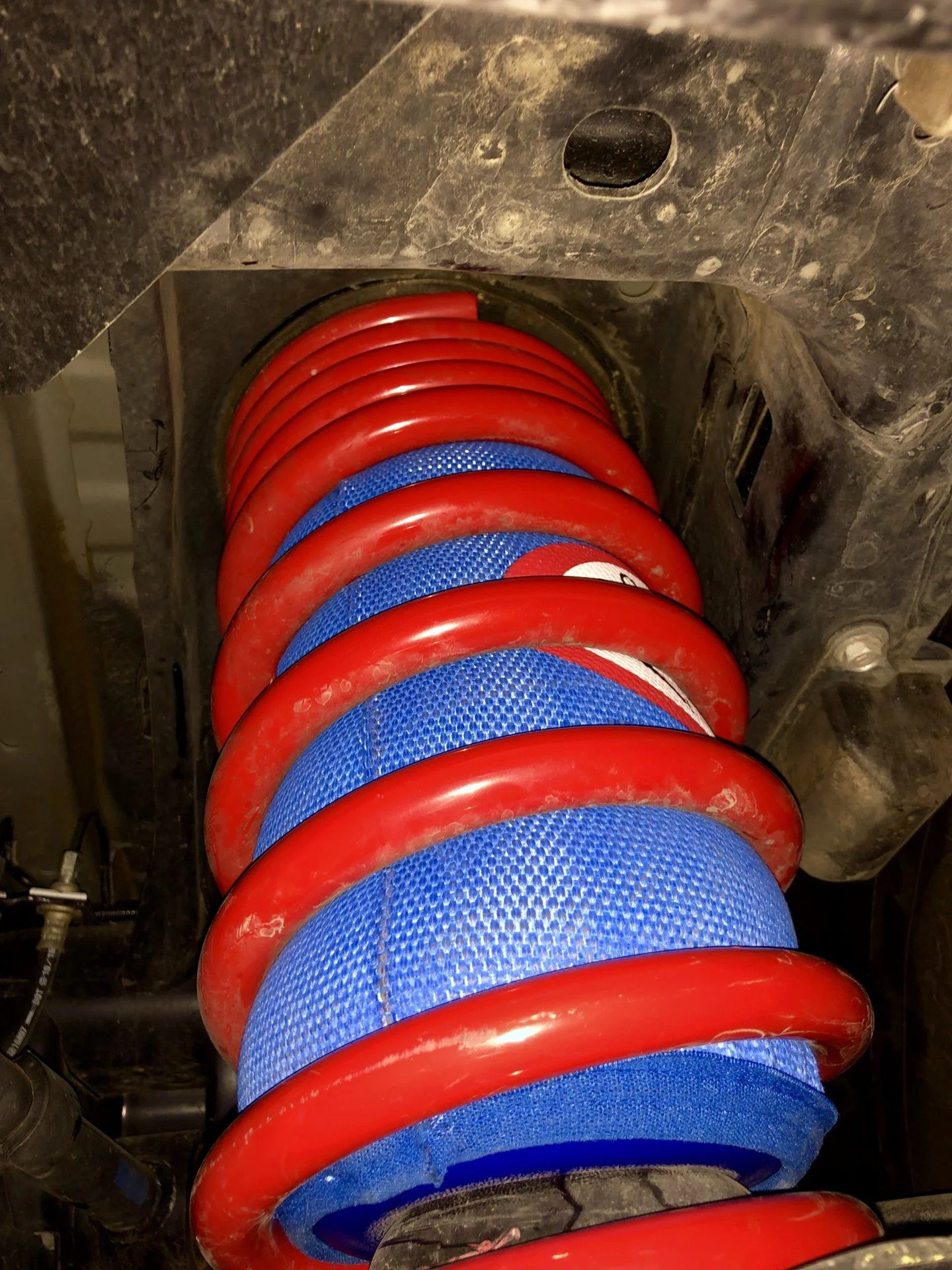

The airbag installation went off without a hitch today. As I've previously posted, I installed the pressure sensors, gauge, and paddle switches in the glovebox and ran the air plumbing to the rear kick panel a few weeks ago.
Airbag Kit - CR5052HP - Air Suspension Helper Kit for Coil Springs - High Pressure
In-Cab Controls - AC1030D - Dual Digital Gauge & Pneumatic Switches with Adapter Kit for Existing Compressor
Add Pressure
Reduce Pressure

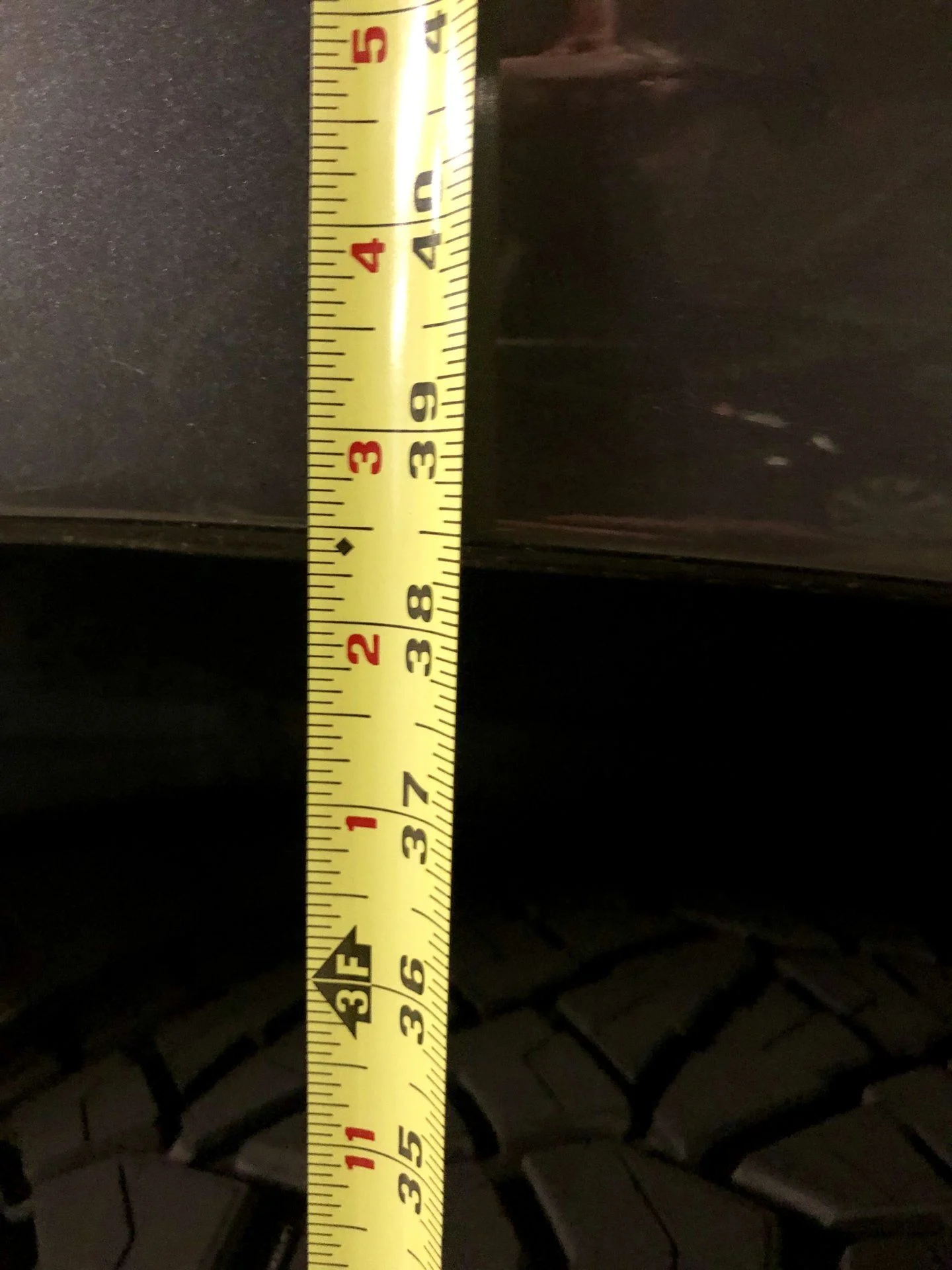

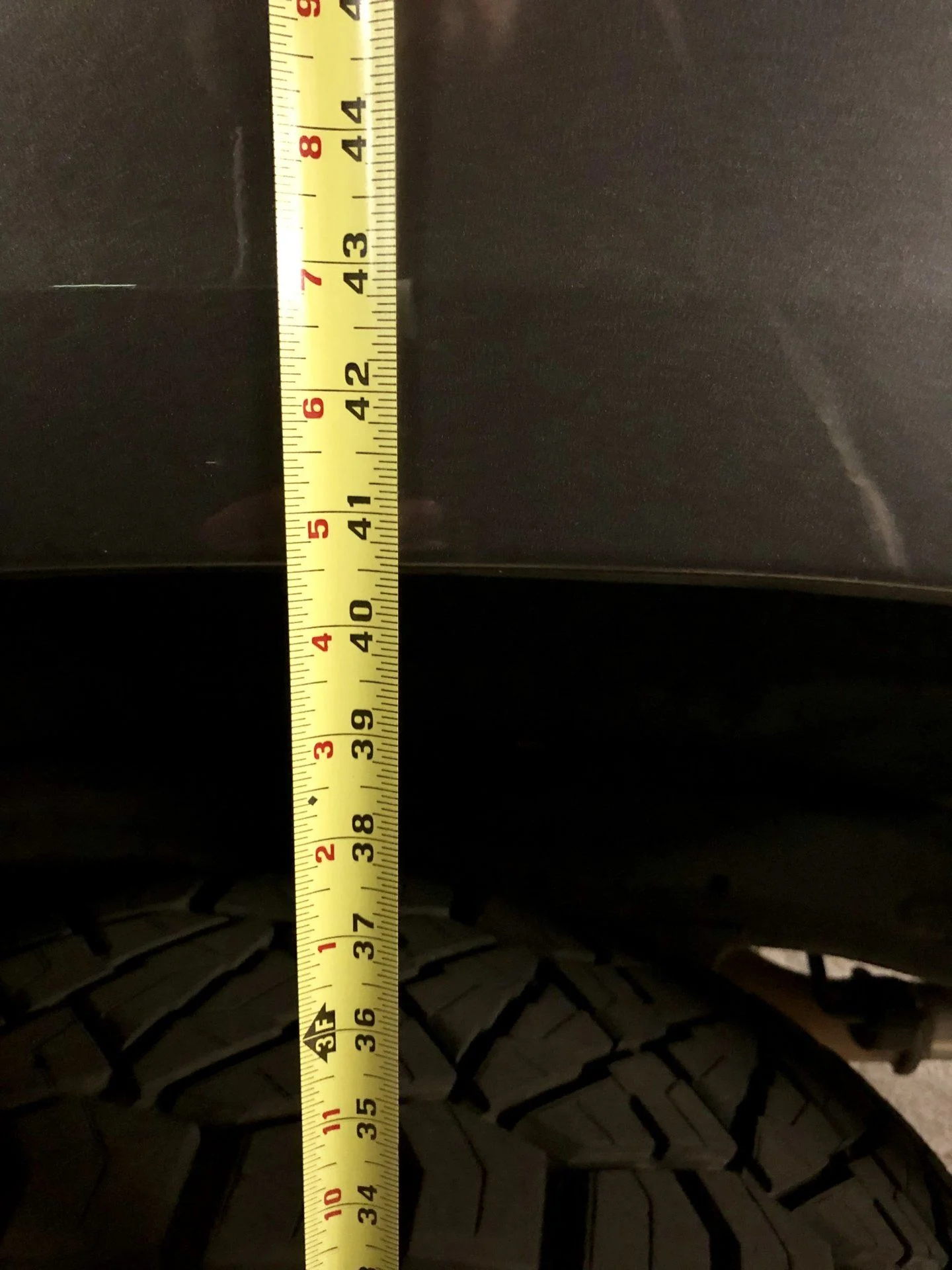

I was too lazy to do center of hub measurements, but I'm getting a relative 1.5 - 2 inch range going from 15 psi to 60 psi. I haven't had a ton of time to test different pressures, yet, but 20 psi seems like a safe pressure for normal use. I could see going up to 30-45 when heavily loaded for trips.
Wow the airbagman ones got to 60 psi? The firestone bags I'm using only go to 30psi (35 for stock height).
Nice setup. Wish I'd put mine in the glovebox.
Thanks! Yeah, I went with the Airbag Man setup because of the control kit and the 60 psi ability. The bags are the same as yours (I think), but Airbag Man adds this heavy duty fabric overcoat for higher pressure.

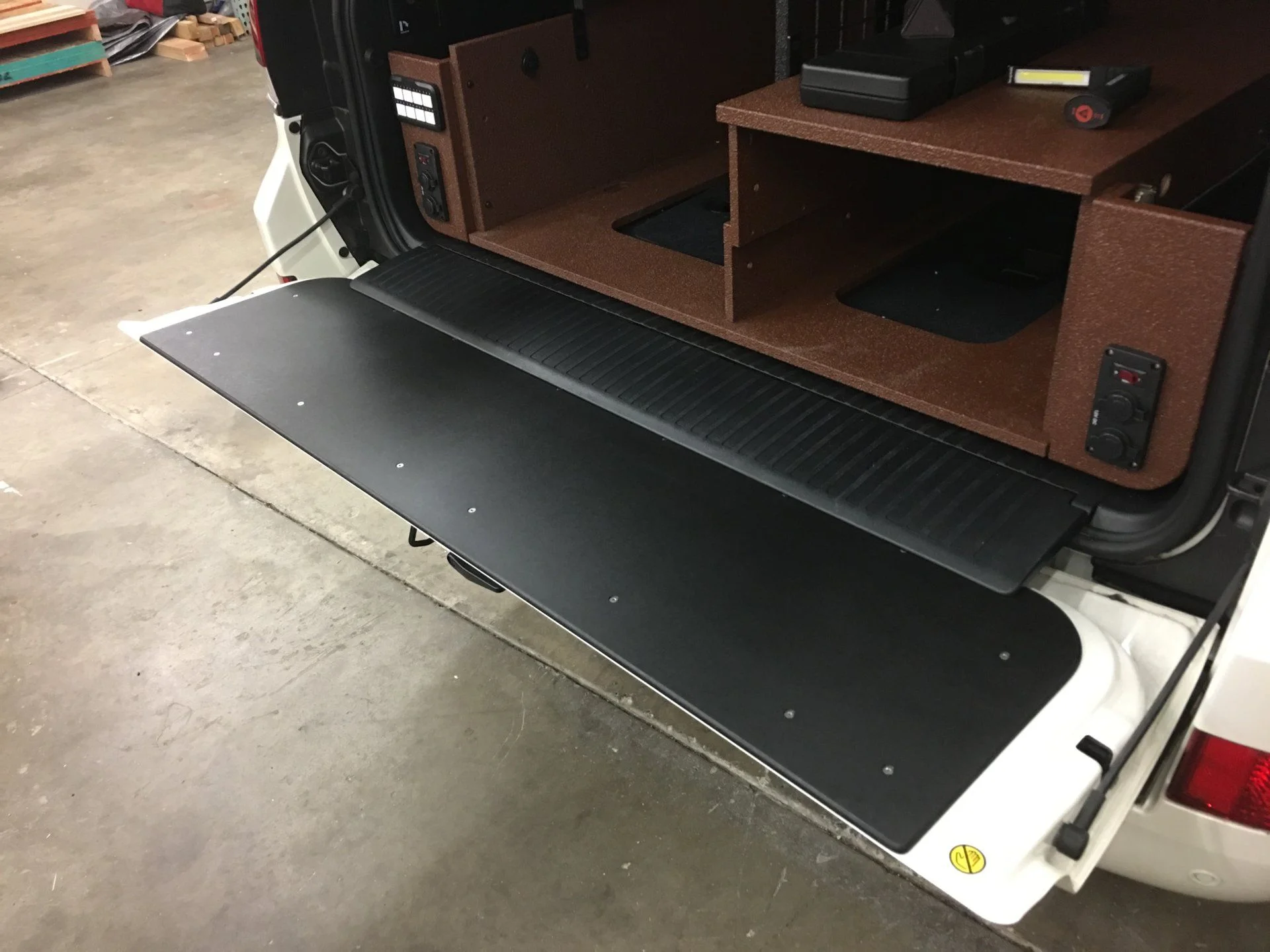

@TrekboxX How does that tailgate cover attach?
