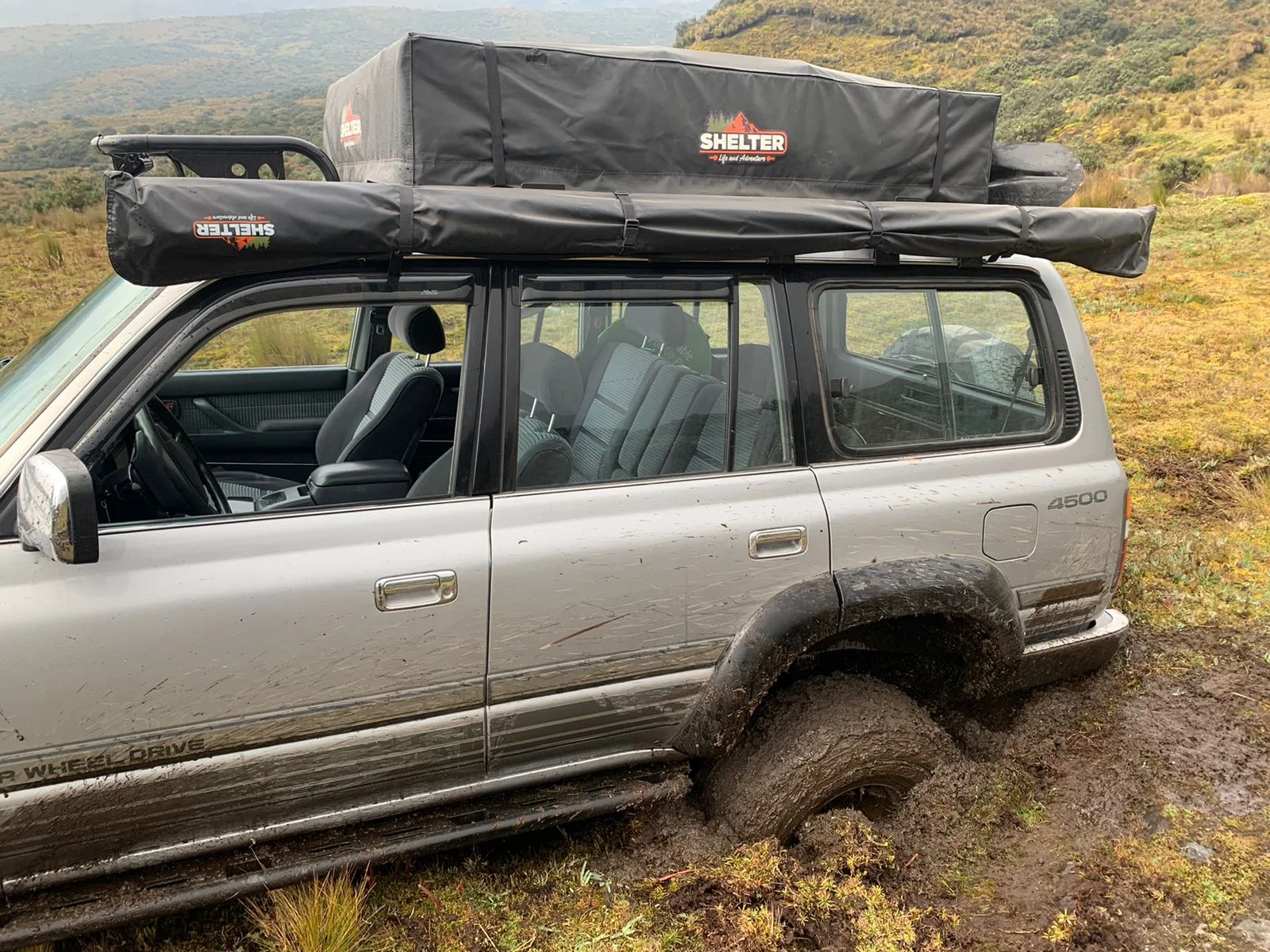

Hello guys and sorry for the delay, its been a hell of a month and now i can get back to you. I have had the springs swapped an placed correctly and now they sit better. I can say that its been hell, but well, I cant do much more. The incline is less, yess, but I think I will let it settle like a few of you said and wait for results and then add spacers.
Measurements are now:
FRONT LEFT: 33.5 cm (13.19 IN)
FRONT RIGHT: 35 cm (13.78 IN)
REAR LEFTL 34 cm (13.40 IN)
REAR RIGHT: 37 cm (14.57 IN)
Front Dif (Left incline 1.5cm, .60 IN)
Rear Dif (Left incline 3cm, 1.57 IN)
With those measurements im more satisfied. In some time I will decide If I add a spacer in the left side.
I wanna thank everybody for your help and support. Not happy with the fact my car doesnt fit my garage and its going to waste outside in the equatorial sun...... I have to get that solved. I'll open an other polemic thread soon! LOL. Thank you all
PS: I celebrated the other day with a trip to COTOPAXI Volacano and fell in this swamp and got stuck for a while, never saw it was like thay... not easy task there!
