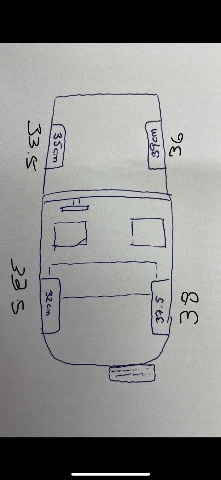

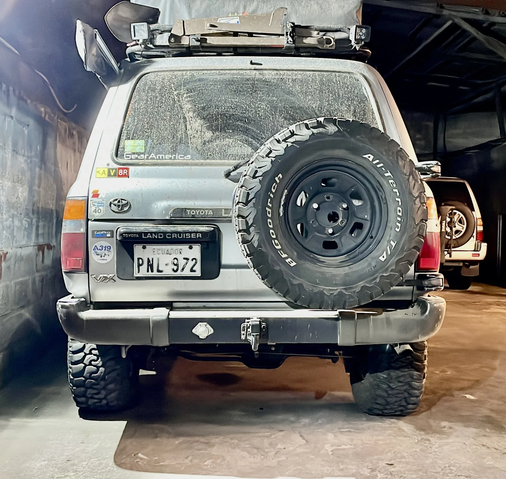

I just read through the whole thread. Since the coils are the same on both sides, that's definitely a huge issue. The designers must not have been aware of the regular difference on all land cruisers, and it gets worse the more it's lifted.
I would suggest buying 1 of each of these 30mm spacers and putting them on the low side.
exitoffroad.com
exitoffroad.com
When you add 30mm to the low side, it will shift some of the weight over to the other side, lowering it, and it "should" balance out then.
