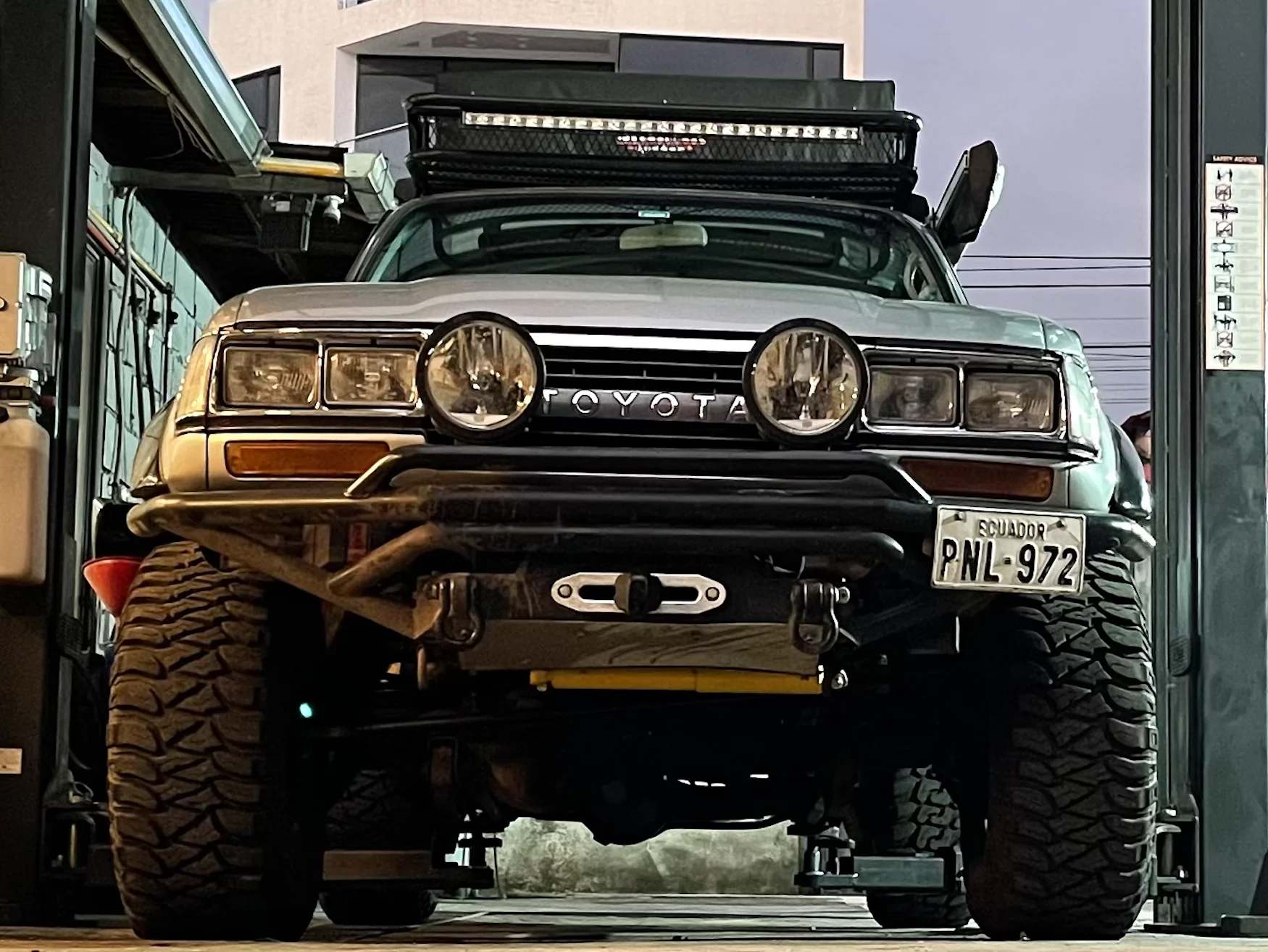

Inclined FJ80
My rooftop tent is permanently on and no choice to remove it. Lets part from there. Its part of the car wherever I go. Fitting and unfitting it could take 3 hours. So no option. This car is only used to go play. Not for day to day stuff. So it doesnt fit because of the tent. Thats exactly why.

Good Call Mike. The ladder is on top, and as a matter of fact, I have to take it apart every time, every time before closing it so the car WAS ABLE to fit in my garage, but not, crap, not even without the ladder.
I like the idea with the rachet tie downs and compressing the springs for it to pass and letting them go once inside. I just dont know how to fit them or where to place them and not mess up my rig. Sorry, I am no expert!

You only need to add them where they are needed. If you want the back taller add them in the back. If you want the front taller to match the rear only add them to the front.
Why not return the suspension and start over with oem height suspension. New oem height will still clear 33" tires for the most part.
So Basically, if its inclined to the left, add spacers on the left respectively in size, and it its inclined nose down, add more size on the front left and right.

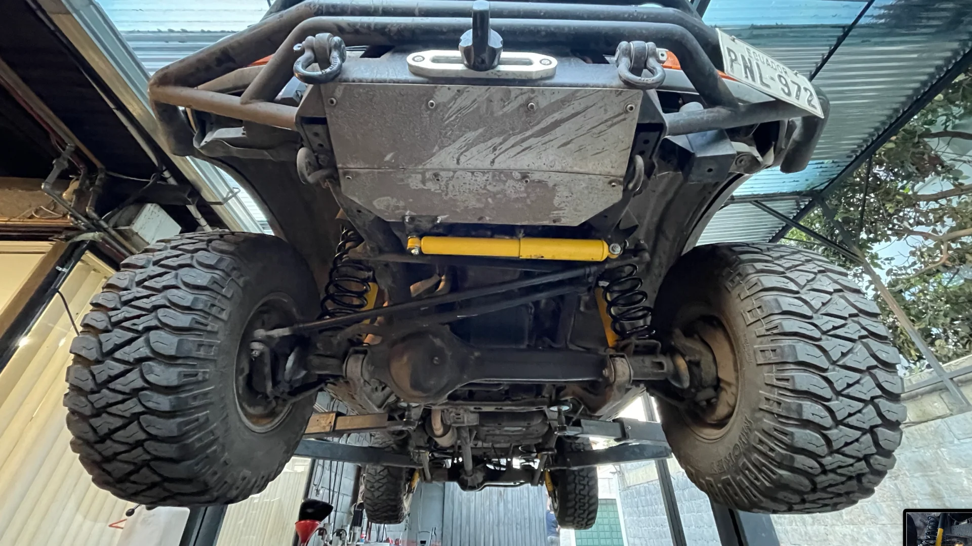

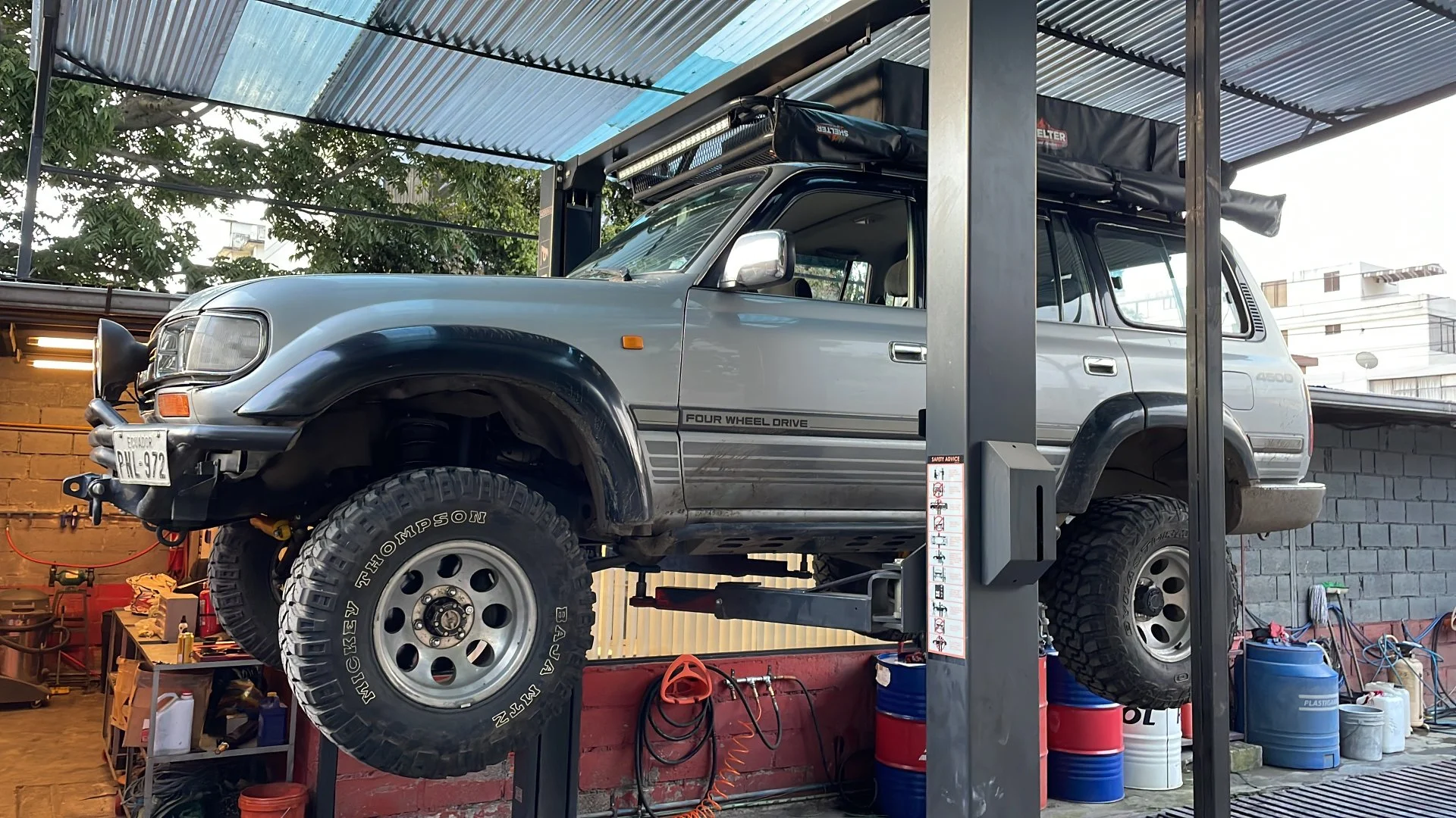

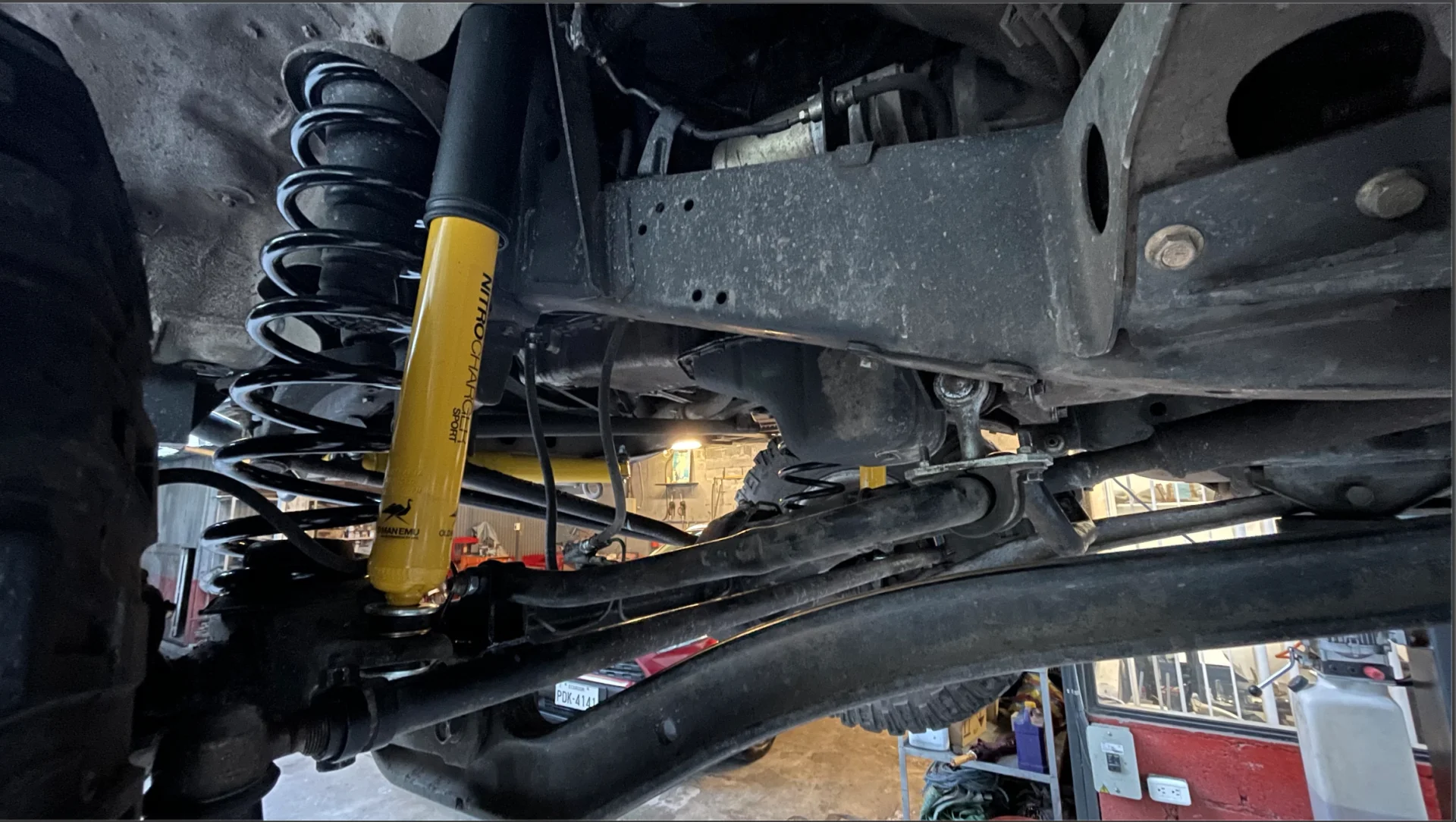

Hello there! Thank you for your explanation. I heard these were ordered from USA, not AUSTRALIA, but perhaps that makes no dif as your observation is logical. I Took these crappy pics the other day when I lifted the car and my mechanic who DID NOT install the suspension, looked for mistakes and probable chasis repairs, and none were found.

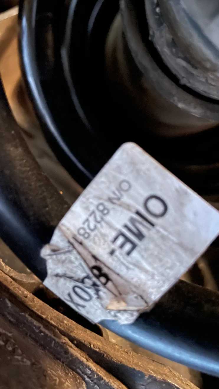

So, this was REAR RISHT SIDE, B is marked there on the tag, the other side says: OME-863X, below O/N 822814

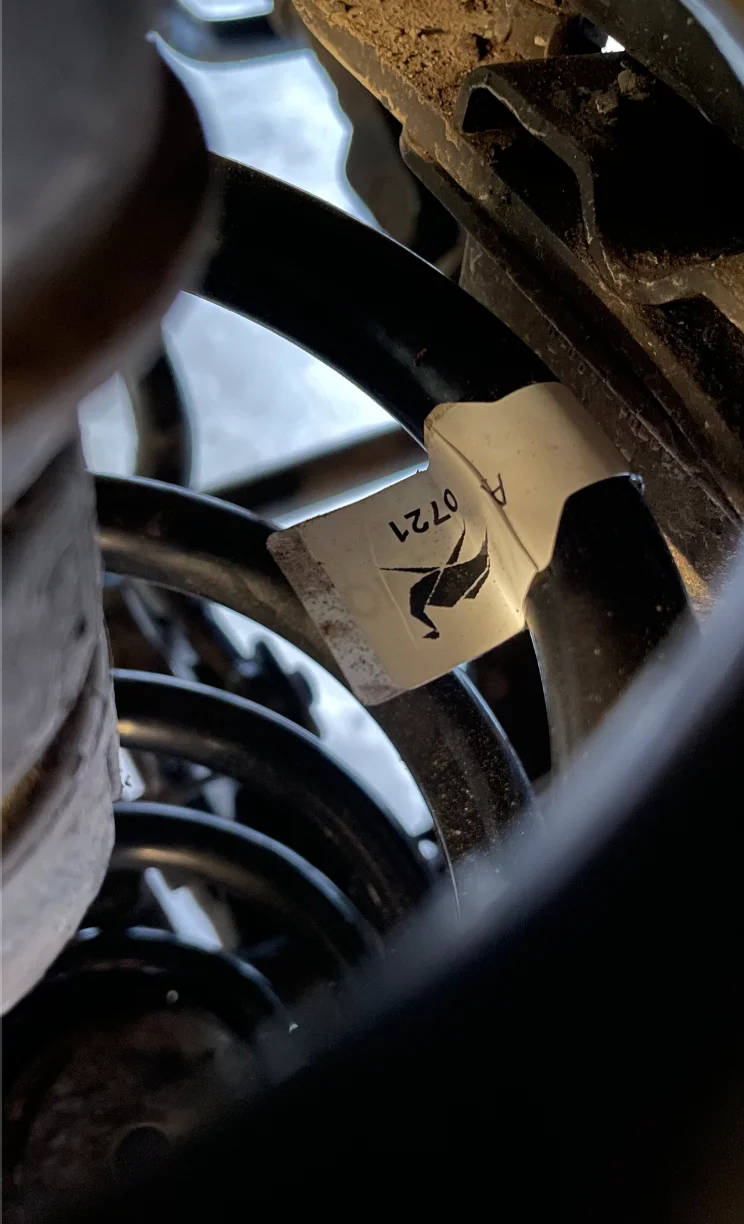

This is the REAR LEFT, sorry for the bad angle, it has an A, the other side says: OME-863X, below O/N 822814

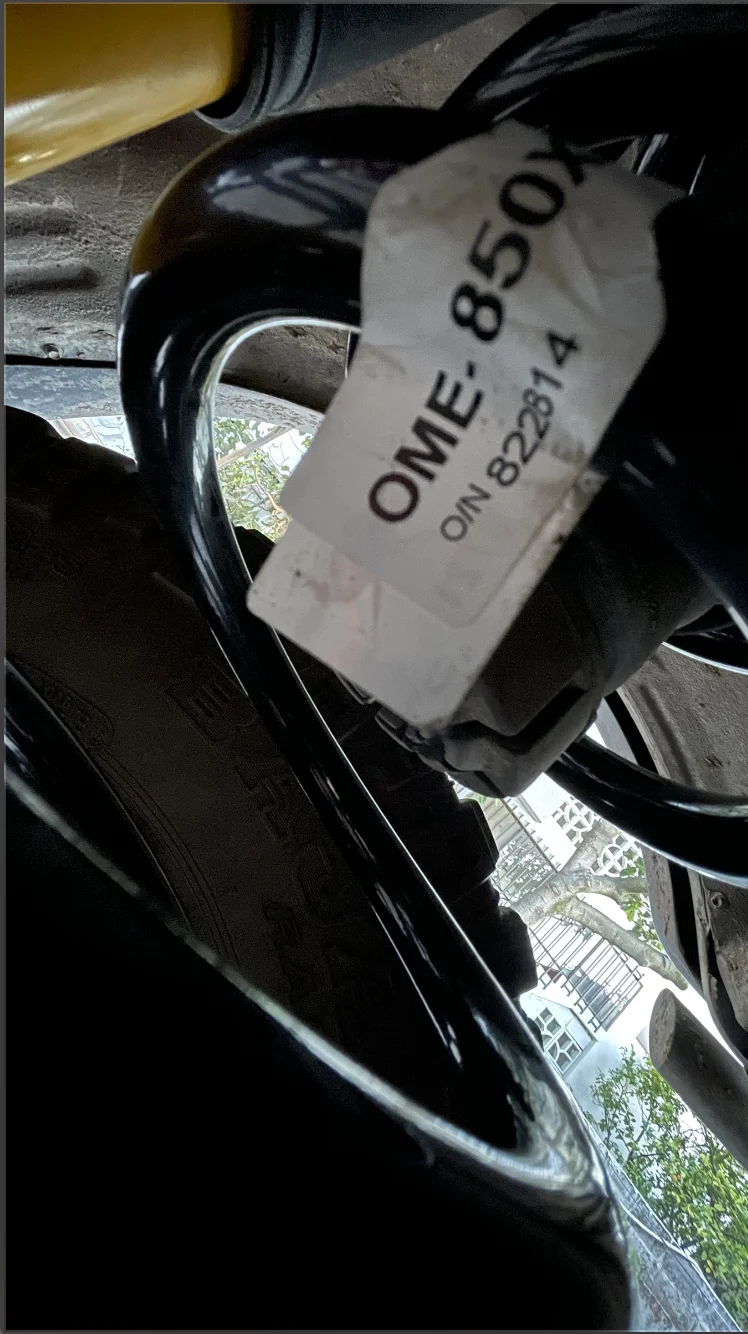

I believe this was front RIGHT Side, Its hard to read, but: OME-850X, O/N 82214 I think and the spring is marked with an A,

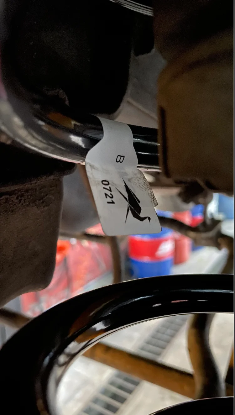

Front LEFT side, OME-850X, O/N 822814 and it is marked with a B
Are these properly built? Of course, I have a LHD car just like the US?

Directly from the link below:
7. IMPORTANT. In the US, with left hand drive vehicles, if the springs are labeled DS and PS, we install the DS (Driver Side) springs on the PS (Passenger Side) and visa versa. The springs are labeled for the right hand drive vehicles. If you can not locate the labels, or you have used springs, make sure you mark the springs that you remove from your vehicle and match long with the long and the short with the short springs.
Lately some springs are labeled A and B. A is for Australian driver side, so in the US this should go on the passenger side and B should go on the driver side
Also, at the bottom, there is a reference to a lean on your truck in the link for Cruiser Outfitters below:
Well, your FRONT springs are in the wrong places. A should be on the DRIVER's side (LEFT SIDE).
Your rear springs appear to be correct, just by a 50/50 chance.

You just made me doubt I got the pictures right, so I went outside, and yes, CRAP....
Front LEFT: B
Front RIGHT: A
Rear LEFT: A
Rear RIGHT: B
This is "no bueno". I just called them and said "Find out where A nd B need to go respectively for a LEFT SIDE DRIVER and now fix my issue. We will see.
Second off, about this A nd B and Australian side or wha not. So, A is for AUSTRALIAN DRIVER SIDE (RIGHT), and B for AUSTRALIAN PASSENGER SIDE (LEFT) and should be INVERTED for us..... so, on OUR LEFT SIDE we will have a B, and on OUR RIGHT SIDE we will have an A....? Correct?
Lately some springs are labeled A and B. A is for Australian driver side, so in the US this should go on the passenger side and B should go on the driver side.
OK, I got a message from the shop , and they forwarded a message from a Venezuelan guy who is the representative from OME for LatinAmerica, based in MIAMI, and says, they need to be installed CROSSED.
Finally the guy in Ecuador from the shop said to disregard that guy and that WE/YOU ALL are right and they're gonna swap the rear springs and fix that.
Yes sir, my bad, I had a confussion with the message these guys sent me, its clear. B needs to go ion the driver side on our side of the planet... This should help the lean maybe in the rear. Even though, the front has a 3CM diff which I need to address.
