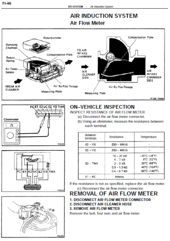

Ok, the two AFM I have purchased, one of them is the correct one for the 91 FJ80. I sourced the same part number you provided to ensure I was buying the correct one. Bolts and seals right up, but the LC won't read it and therefore has no CEL, so no start. The other AFM I have used is from the specific Camry model you mentioned, which I believe was the 1993 model. It fits perfectly, just like the other, but with the same result: no CEL, no start. I also ran across this testing dialogue from the FSM, and they both are good. That's why I am stumped on why it won't read it, but reads the one that shouldn't be on there?
Have you tested the one that came on the truck according to the FSM?
I'm wondering if the previous owner changed the wiring on the connector to match the AFM that he put on.
If you have the EWD, you should be able to verify the wiring back to the ECU.
Yes, I tested that one as well and found it to be good. I just confirmed that it is not an OEM connector, but it has seven white wires that are probably just connected to the harness's wires, whichever way. Would this cause the LC not to read it, as it may not be wired correctly to the specific pins that it's supposed to go to? I also don't have the EWD. I have been trying to find information on this particular wiring in this part of the harness.

You need to realize that a 90's era vehicle is totally different from modern vehicles. Your statement "Would this cause the LC not to read it" is not correct. In modern vehicles, electrical components are connected/communicate together via a CAN bus or other digital standard where the term "read" is appropriate. In early to mid 90's nothing is connected to the bus. Each sensor connects to the ECM, relay or other device via an analog signal. There is no protocol of data transferred back and forth. That makes it relatively easy to step through each connection using the EWD and FSM to determine the problem.
Your current method of throwing parts at the problem is going to be expensive and frustrating.

Without both the FSM and EWD you're blindfolded in a dark room.
If it's not an OEM connector, how did you plug it into the other 2 AFMs?
The connector should look like the one below. Pins w/ pigtail are 82998-12130.
As stated earlier, you should verify the pins back to the ECU.

Sorry I should’ve worded that better. The connector on the LC currently is the correct connector it’s just not original to the vehicle and seems as it was changed at some point in time. The pigtails that this connector has are all white, so I’m sure the previous owner just wired it up however they thought since I’m sure it didn’t come with a wiring diagram to follow of some sort.
