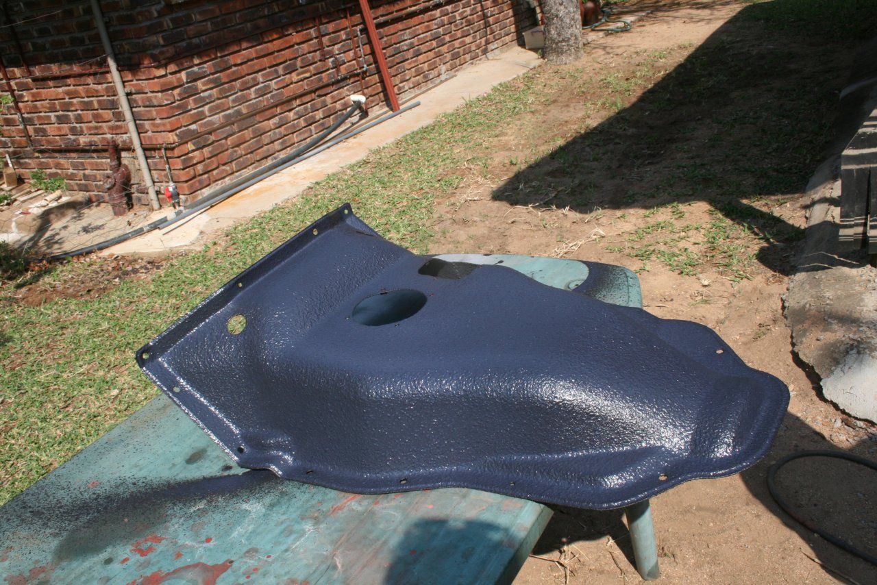

I've been quiet this week, but not totally idle. Temperature has been sitting on 100F since the weekend. I start early around 5:30 in the morning when the temp is around 80F and by 10:00 when it reaches 90 I have to call it a day, so it is effectively half-day working and pretty uncomfortable at that. I finished the transmission cover this morning.
CLEANED UP AND GETTING A BIT OF FILLER.
SMOOTHED OFF AND UNDERCOATED.
BED LINER ON
GOOD AS NEW.
