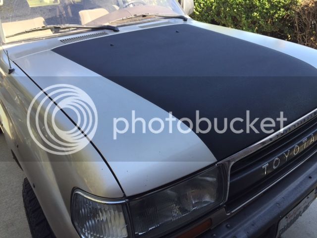

Okay, a feeble attempt at tech for the moment, until I tackle the bigger plans. I taped off the areas I wanted to bed line, and hit them with the sanding sponge. It scuffs the paint just enough, and also burnishes the edges of the tape down at the same time. I sealed the edges of the tape with Duplicolor clear coat, then hit it with Diplicolor Bedliner.
Kind of like using green coolant, I know the Duplicolor product is readily available at any autoparts, so matching, repairing, touch up etc, will always be easy to do. If I can pass on a tip with this stuff, it's let it warm in the sun, shake it for 1 full minute, and clean the nozzle often. Clean it right away with denatured alcohol, and dab any blobs that spray out with a rag, and they blend right in. Oh, and apply with a circular motion!

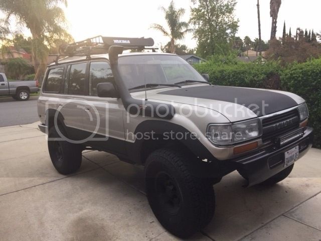

So this is how she sits today. I didn't want a black truck with gold accents, so I tried to keep the horizontal line BELOW the indent, and follow the crease, but I don't think I like it, so I'm going to grab another can, tape it off and correct it, and raise it to the top. I smashed the tailgate in, so thankfully I got a good deal from @Deathvalleypaul , and threw the new red one on, after painting it with bedliner too. I'm going to carry the black around back when I fix the other lines, to tie it all in.
