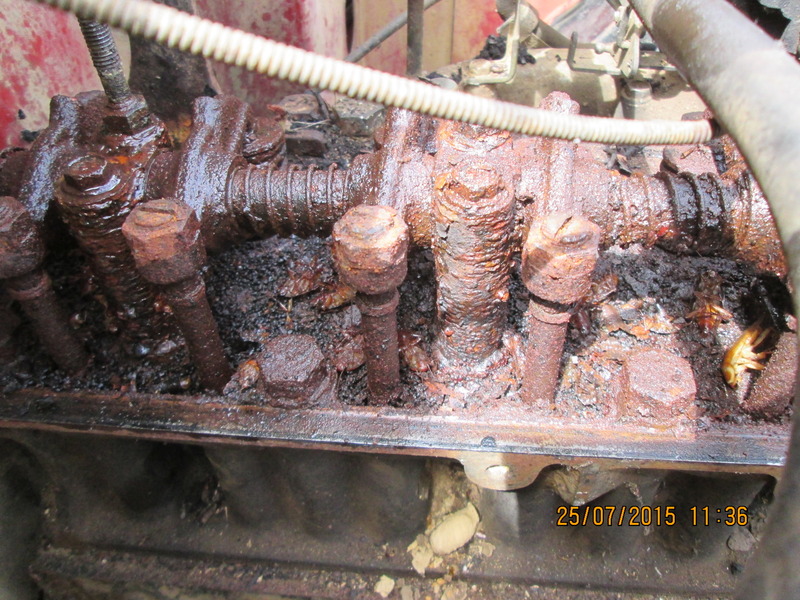

I was glad to see it had the 2F engine (I still prefer petrol/gasoline engines to diesel), but it was locked up. I broke it loose pretty easily, but couldn't get compression on three cylinders. This thing seems to have sat for maybe 20 years in one spot--somebody had stolen the oil filler cap, so when I removed the valve cover, I found this:
And about 50 dead cockroaches, thankfully I had dumped about 15 liters of mixed (filtered) used oil/diesel/petrol, so these little guys were all dead, but over the years they had lived in there, they had left about pound of cockroach poo behind:
Well, I couldn't get 3 of the valves to close, so I had to pull the head, where I found yet another surprise. That's a dead gecko in #3, should I send it to the guys at Icon? :) Also notice the large amounts of rust around the pushrod holes--that combines with the fact that the crank still can't be rotated by hand, even with the head off makes me think that the bottom end should come apart:

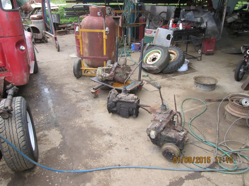

Found a local mechanic who had a big stack of LC corner glass, he let me have 2 of them, complete with the gaskets. He also had maybe half-a-dozen H41 and H42 transmissions, so we snagged one of those too, to go with the 2 extra ones that we got with the truck when we picked it up:

And I'm guessing "broke it loose easily" coupled with "can't be rotated by hand" means the crank does rotate fully but is very stiff (and needs leverage) to turn.
But I'm surprised the engine can rotate at all with all that rust (and those dead bodies) inside..

When I first tried to turn over the engine (with a long breaker bar and a piece of pipe on the end of the crank), it was pretty hard, but it did eventually break loose and the more I rotated it, the easier it got. However it eventually got to a point where it wouldn't get any easier. I got into the head, found the troubles there, pulled it, pulled out the pushrods, etc., and assumed that the stiffness was just from the top end, but no, even now with the head off I can't turn it without a breaker bar. Mind you, it's easy to turn with the breaker bar, I just can't grab the harmonic balancer with my hands and turn it over like I can with my F-135 (which is in running condition). So, I'm a little worried about what might be lurking in the crankcase. I'm guessing a mix of water, oil, petrol, diesel and rust!
