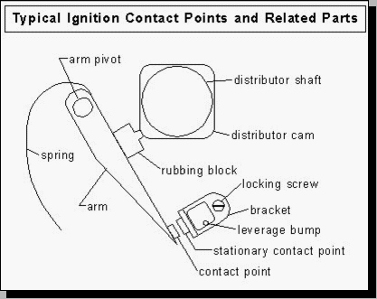

Grime on the points is also possible. Gapping the points should be done with the dizzy lobe like this pic. [i'm sure you did it correctly, just covering all possibilities]
The contacts looked good to me, no grime (has not really been driven since we placed new points in a few years ago) and no pitting. I gapped it to .018 like the manual said. Pain in the ass getting that done with all them moving bits not wanting to stay put. I dont fully understand the LT line in the distibutor, but aint nothing a little google and pondering cant fix

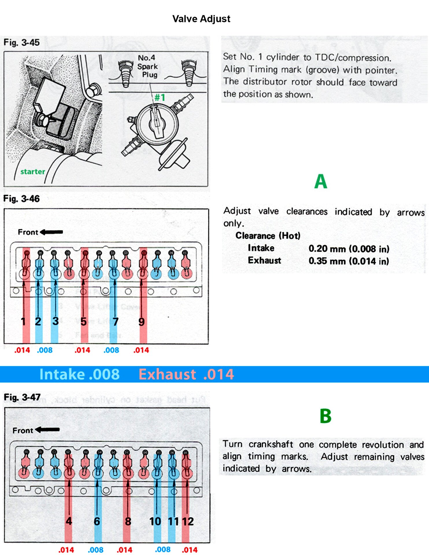

If the truck started before you removed the distributor, and now it doesn’t, I would make sure the distributor was re-installed correctly before trying to chase other potential issues. At TDC on the compression stroke, the rotor should point towards the #4 cylinder, which is #1 on the cap for firing order.

4. installed distributor so that it points to cylinder 1 at 7 degrees BTDC
This is confusing. Read posts by "deliverance"
In case you don't already have this I'll post it.
