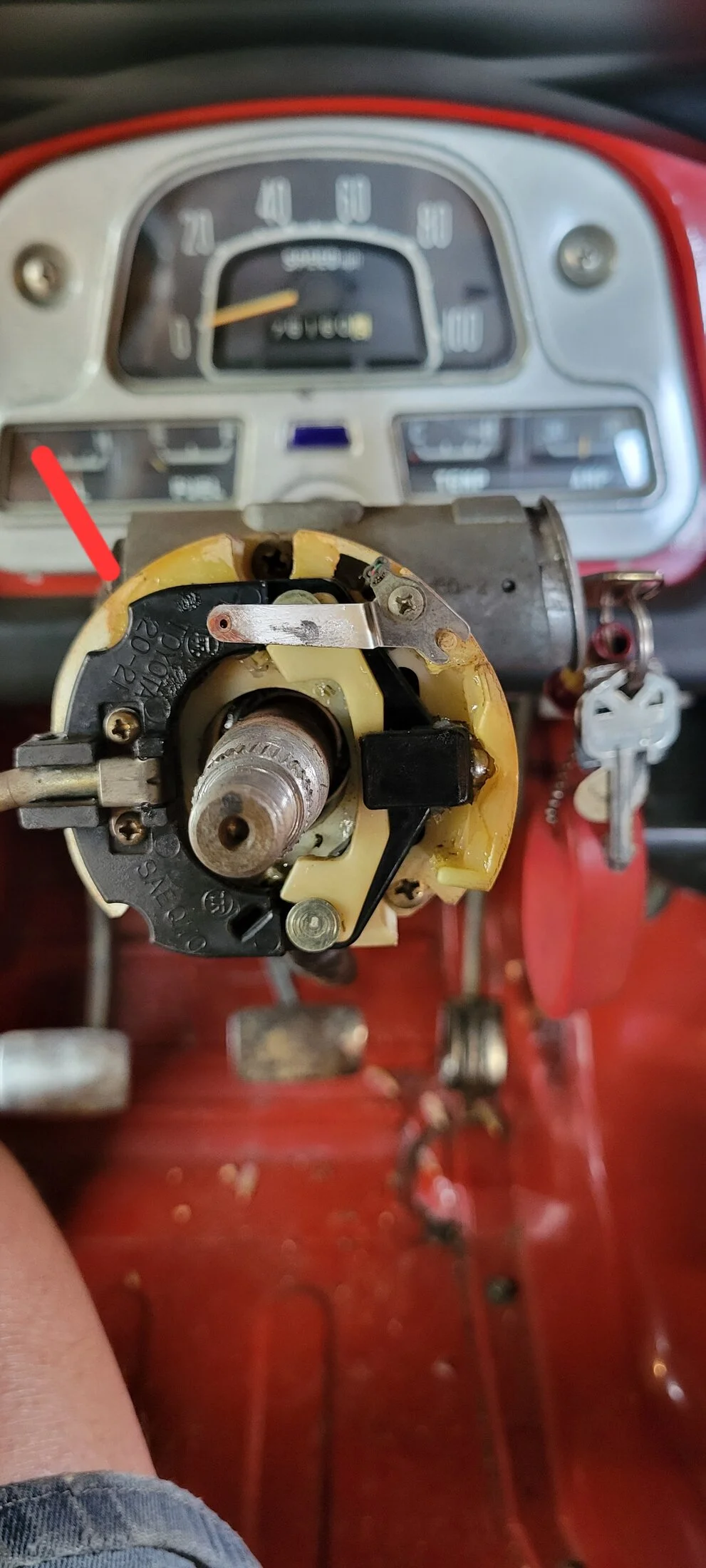

In not sure about a 79/80 switch. I think On 78 and earlier the switch is on the opposite side of where the key inserts. Remove the plastic column clamshell covering the turn and ing switch. There should be 4 screws on the bottom. On the left side opposite the key, you should see the wires going into the switch with a screw holding it in place. That's the actual switch. Maybe someone will chime in on how to pull the key tumbler or you can search.

The red line is where the switch is. You shouldn't have to pull the wheel.
Put the key in and turn slightly, then depress the pin to remove the lock cylinder.
It could be the lock cylinder or the switch itself.

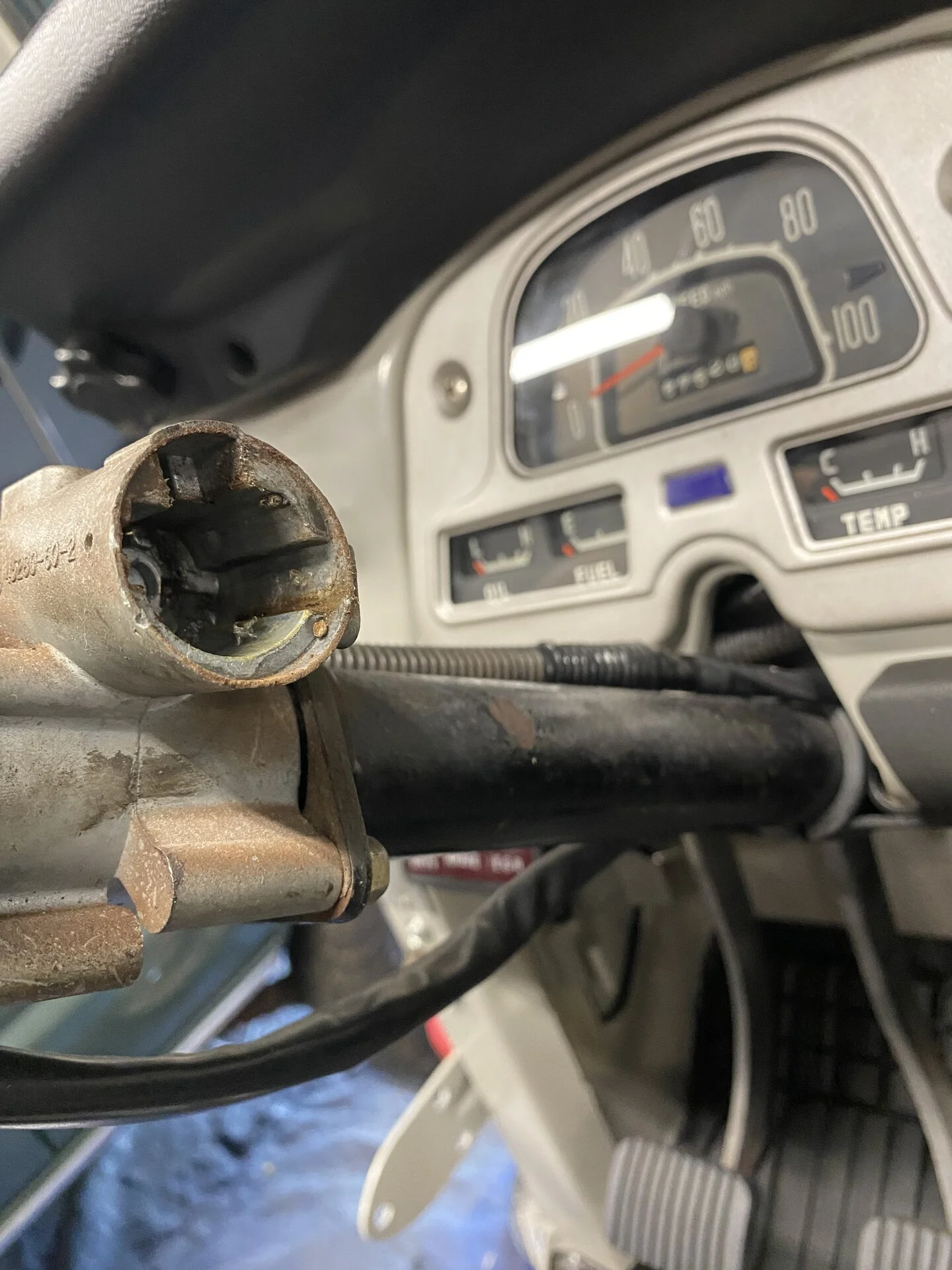

below is what it looks like when a ign lock cylinder is removed for various reasons , including replacement from normal 5 + Decades of use
this and that is why i asked my question above .....
