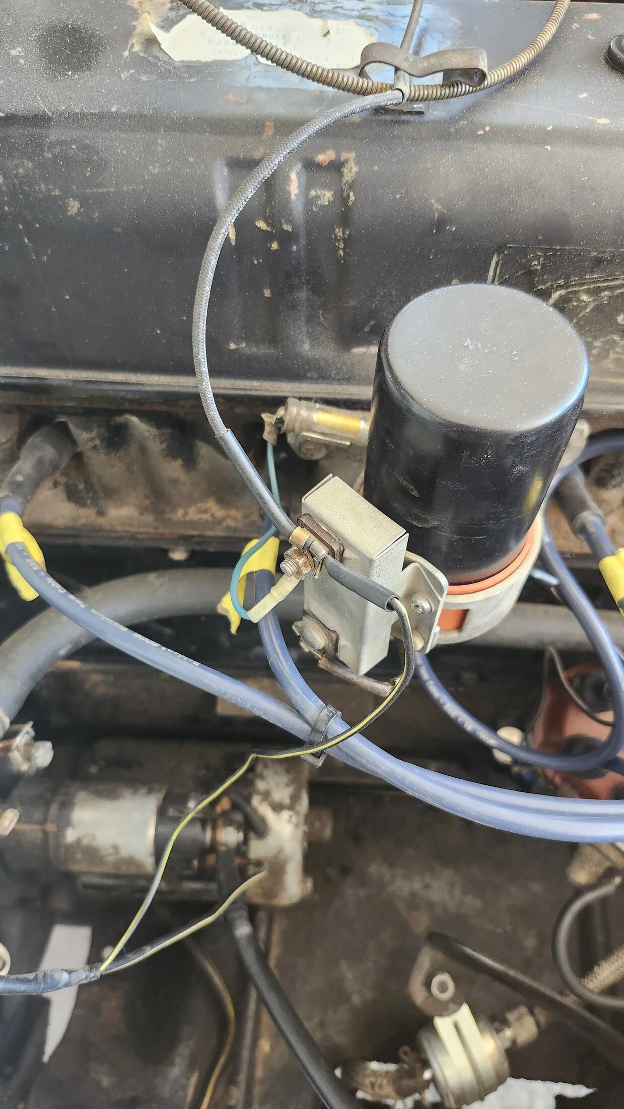

Also, is the "ballast resistor" the one attached to the post with the power that attached to the box attached to the + side of the coil? I couldnt find that in my FSM.
The test I mentioned should measure voltage from the coil (+) to ground, which you should still do just to verify voltage there is adequate, both in the ignition run and start positions.
But, if you see a drop across the coil (+) to coil (-) while in the run position, that would indicate you have some level of power to your coil.
About your ballast resistor question, the ballast resistor might look like a ceramic block. It would have one terminal connected to the ignition switch via your wiring harness and the other terminal would be connected to the coil (+).

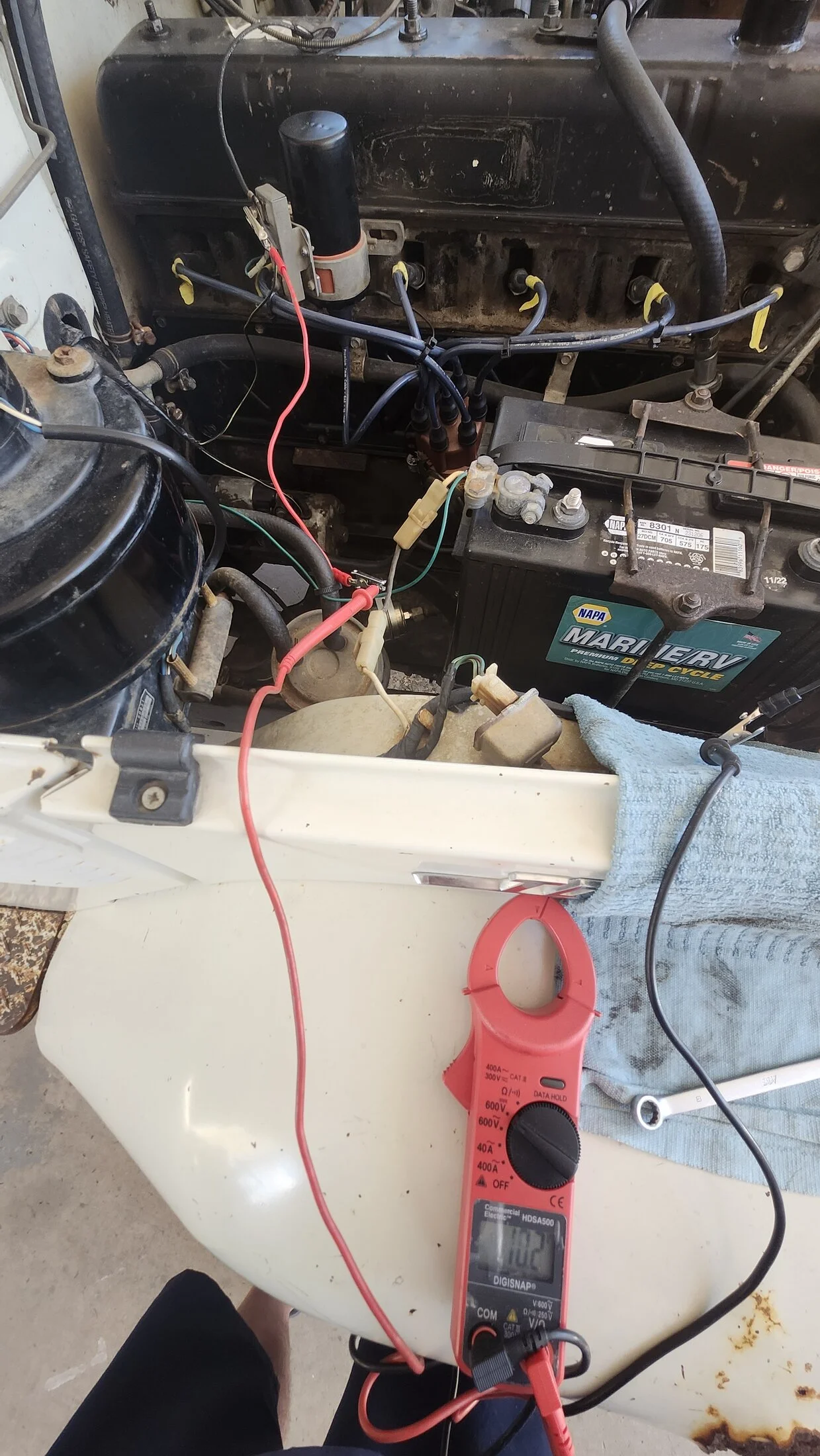

So volts coming into the ballast resistor is 10v and out to the + on the coil is 5v. Is that to low? I don hear the cellunoid click. I did take the resistor off and clean it up a bit and check the wire to the + post. Seems good.
10 volts seems low. What's the batt voltage?
12.2. Getting tired from the fruitless cranking... but still over 12. When I take the harness wire off the top post of the ballast, I get 11.9 volts at the wire. Reconnect and test again at top post and it's 10.5 when points are closed. And 11.8 when points are open. Shouldnt this say electricity it's fine? Could I have not staticly timed it well and timing be way off?
