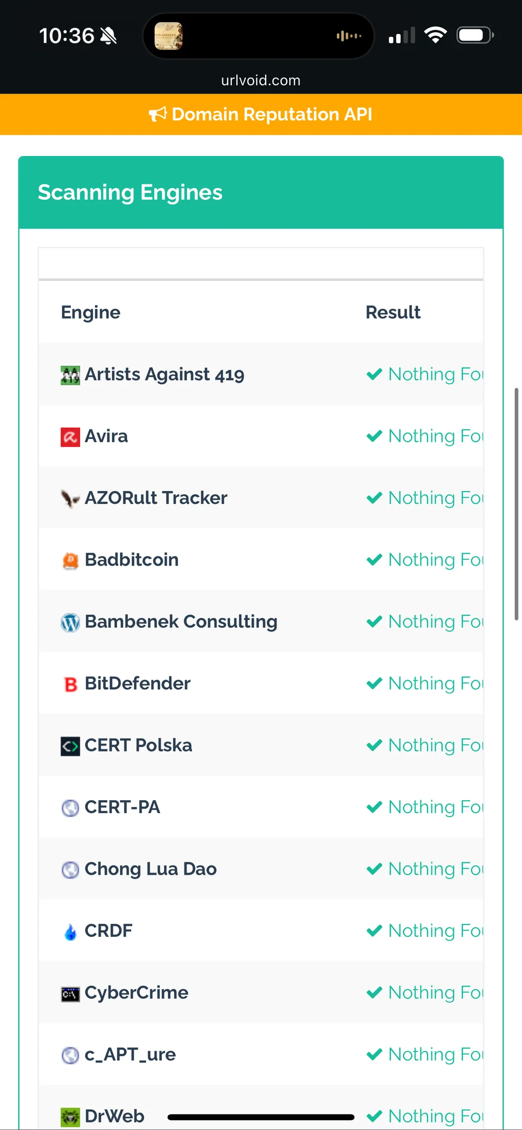

This guy legit? Three posts? .ru program? @linuxgod and other techies please chime in.
EDIT: screenshot from url check below. I don’t know if it’s 100% or not.

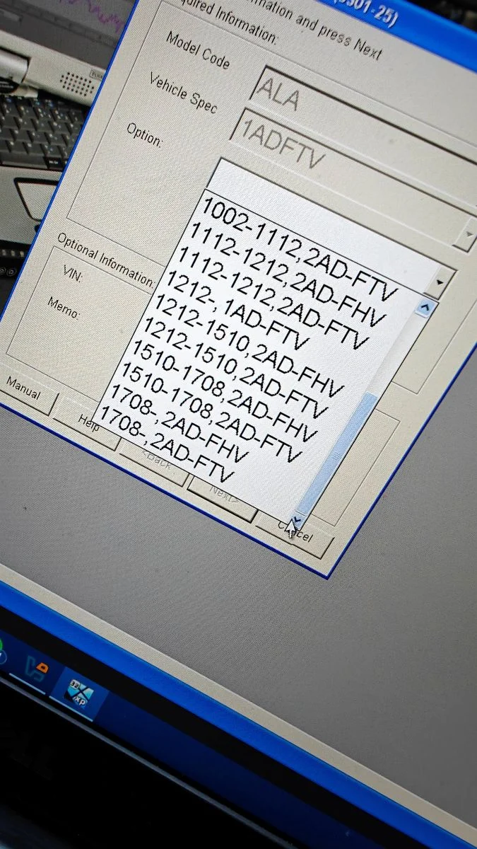

First post from UK - I'm a Toyota RAV4 2014 (Business Edition) owner. I just want to say a big thanks to the OP for posting the working image and to the rest of the poster who have assisted everyone. After some difficulty (mainly with registering the licence key, I've managed to set it up.
However does anyone know how I can figure out what engine variant my vehicle is? It seems that Techstream details the model code and vehicle spec fine, but then asks for a whole list of baffling options and I don't know what to choose. This is the screens I get:

this isn't to say that no one here will know what you need, but this particular forum is dedicated to 100-series LC/LX, so I'd imagine that you might have better luck with someplace that is focused on Rav4s.
Just looking at that list, it looks like your options could possibly be related to production date (numeric part of those codes) and which drivetrain option you have (the FTV vs FHV makes me think one might be for the hybrid drivetrain). If your "1ADFTV" vehicle spec in the box above is accurate, I'd wager that the "1212-, 1ADFTV" would be the most likely option to select as that appears to be the only one relevant to the 1ADFTV. I could also be WAY off here.

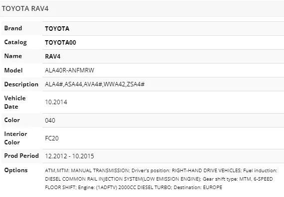

Your best best to narrow down what you have is to go to partsouq.com and enter your vin. That should point you to what you have under the hood. And/or do so on Toyotas website. Also, usually the engine itself has some number plate on it.
Thanks so much @jaewastooshort and @whitec13 for your excellent advice.
Unless I'm looking in the wrong place, the Toyota website only provided very basic info such as model name and number plate. However the partsouq.com website gave the following info:

Did that give you what you need to select the correct option? It looks like the data to the left of the engine model in techstream is the production date code range. With your production period being 1212-1510, I’d say @jaewastooshort was spot on with his wager.

So the date is baked into that number. 1212 being 2012 December and 1510 being 2015 October, which partsouq indicates as your production date range. I would assume the open ended 1212-, indicates it is a to the end of production run. I would say you are safe to click on the 1212-, 1ADFTV option.
That was my impression as well. Assuming those were date codes, the second number would refer to when there was a change in production that would have had some change impacting how TechStream interfaced with that particular model, and so an open-ended date code would run through the end of production.
Glad you were able to find more info on partsouq, and also glad that it seems to validate my guess. I hate giving bad advice.
