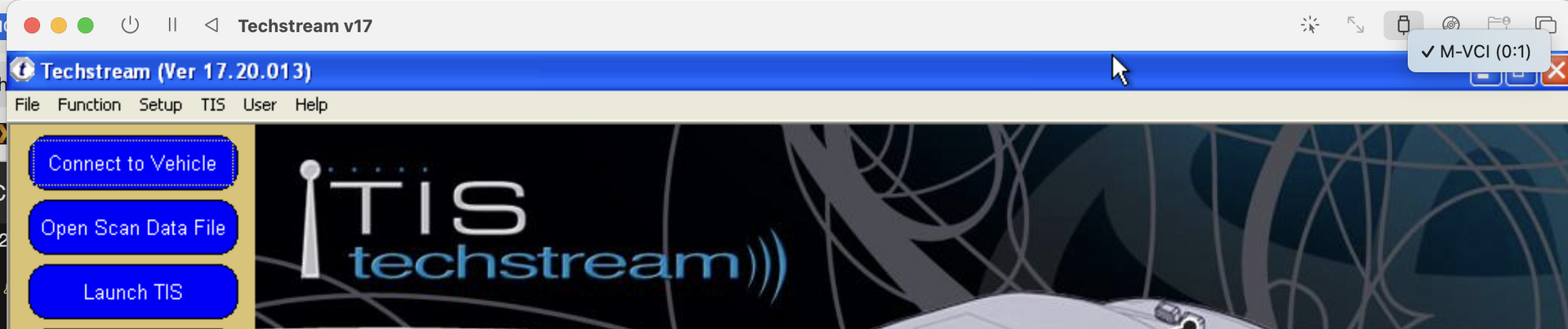

I was able to get it to finally work now on my M2 Macbook via UTM
@1emerson1 POST 1193 was the answer for me. Even though your cable is recognized by the Windows XP, Techstream needs to know what cable to use. Since you can't get into Techstream, you have to first go to the "Bin" directory, C:\Program Files\Toyota Diagnostics\Toyota Diagnostics\Teachstream\bin > select main menu > fill in required dealer and dealer code (I put random 123) > cancel registration pop up > Setup > select VIM (cable).
You can close the Main Menu and then enter Techstream via the desktop link.
HTH!! and thank you to everybody for show
get around the "Unable to connect to vim" error message by selecting the XHorse MVCI driver from the TIS main menu.
1. Within UTM, make sure you're passing your USB device to the VM. You'll see a checkmark next to the device.
2. Navigate to where Techstream is installed - C:\Program Files\Toyota Diagnostics\Teachstream\bin
3. Open "MainMenu" application. You can disregard the registration window, click on "Cancel".
4. In the toolbar menu, click on "Setup" then "VIM Select"
