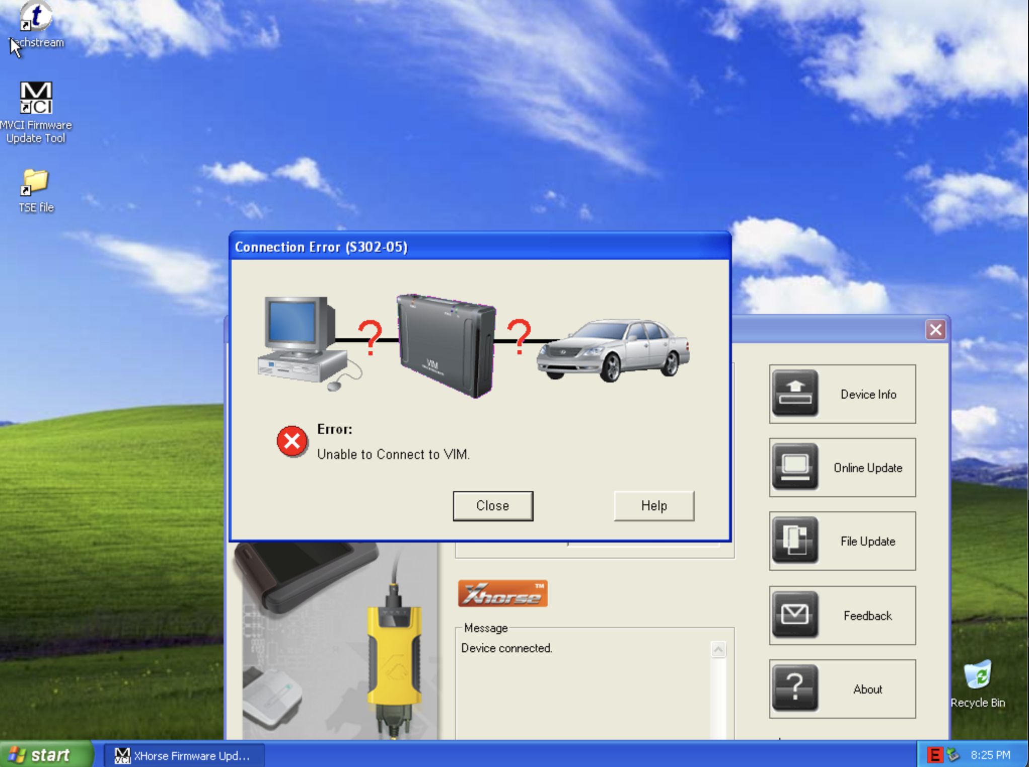

Running the VM from the 1st post on this thread on an M2 Mac. I am able to see the miniVCI J2534 USB device but when I try and open Tech Stream I just get the "Cannot connect to VIM" error.
Any advice? There's so much information on this thread it's hard to figure out what is still relevant anymore.

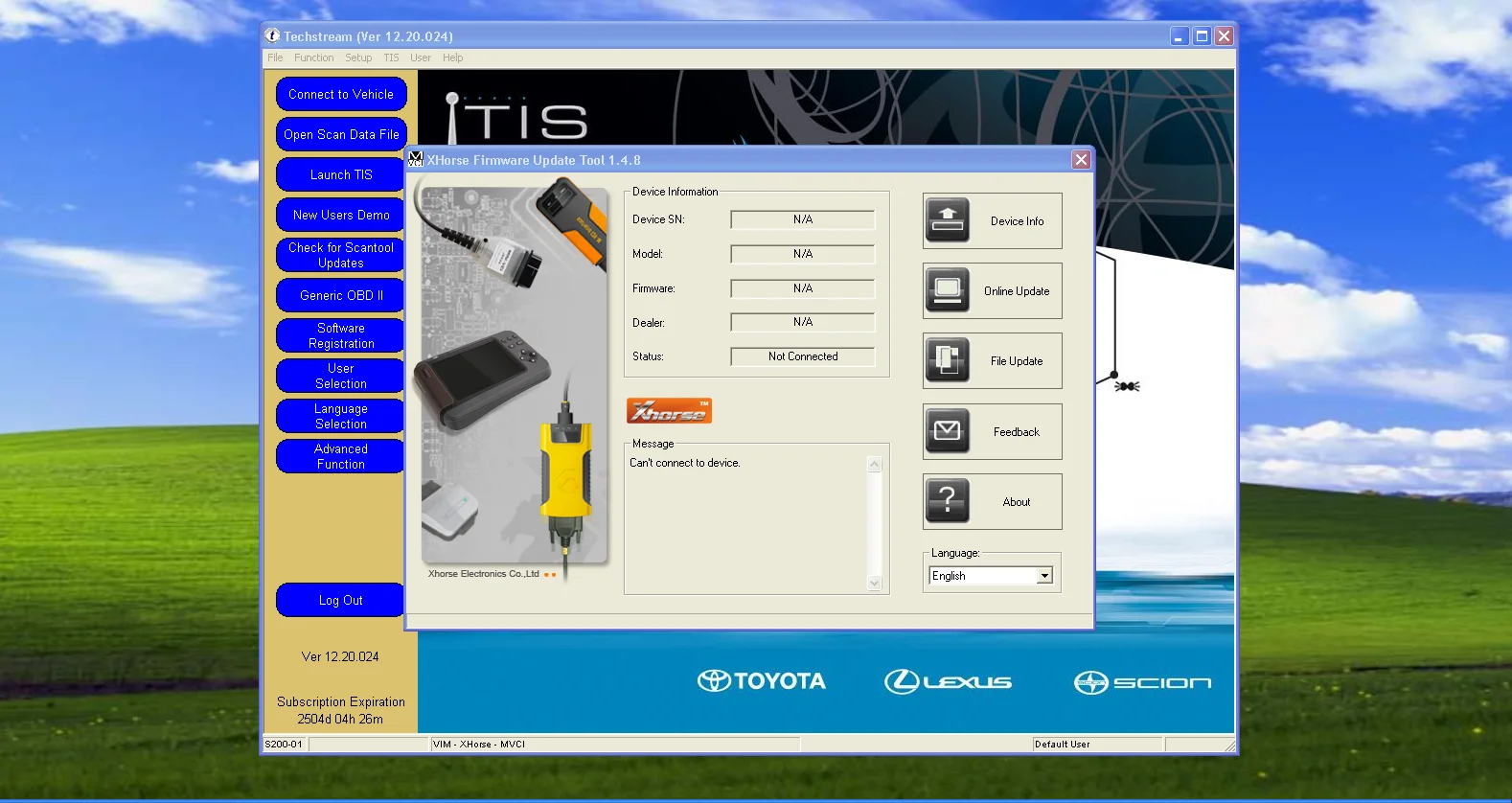

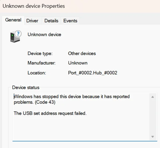

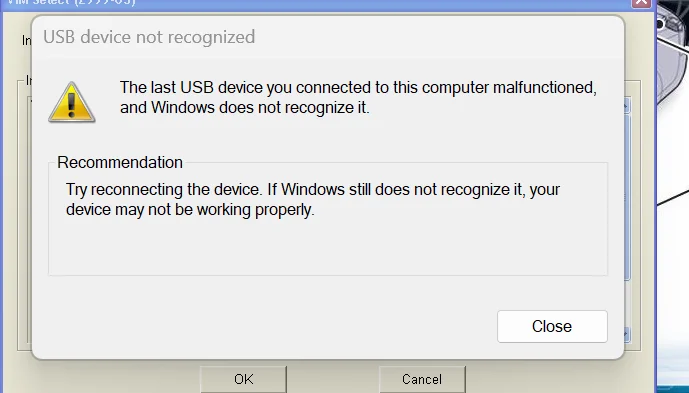

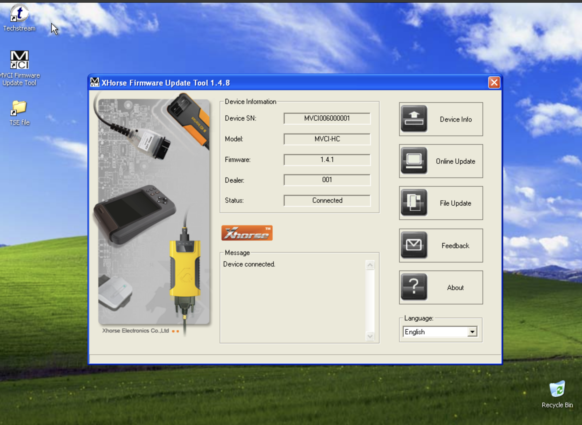

I have been fussing with this issue for days now as well. Used links from OP, VM seems to work fine, TIS opens, but "cannot connect to VIM" and both host and VM are having issues with recognizing the cable. Snips of error info from VM and win 10 device manager are included.
I'm not 100% confident with the driver situation, or that I have allowed the USB passthru to the VM correctly. Please help a guy out.
Note this is a diagking mini vci v 1.4.1 from amazon. I did not use the installation DVD due to the abundance of apparent malware on it when I scanned it, that's how I ended up on this forum.

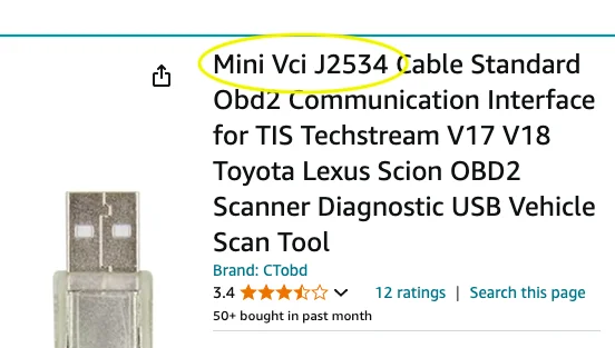

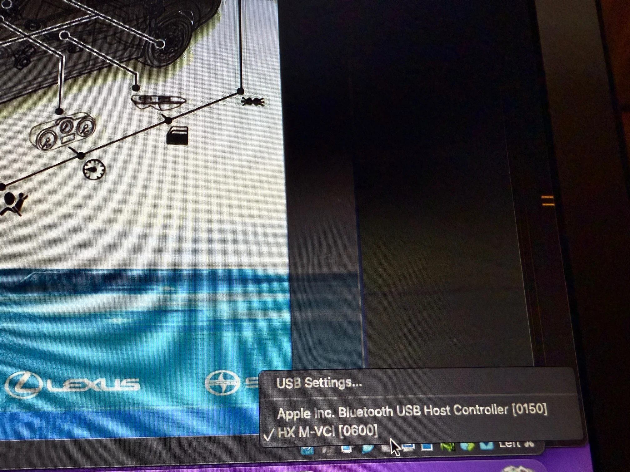

Not sure if this helps, but I was having the same issue with "Cannot connect to VIM" and here is what I did to fix it.
First thing, I confirmed what cable model I purchased. From Amazon, I confirmed it was the "Mini VCI J2534"

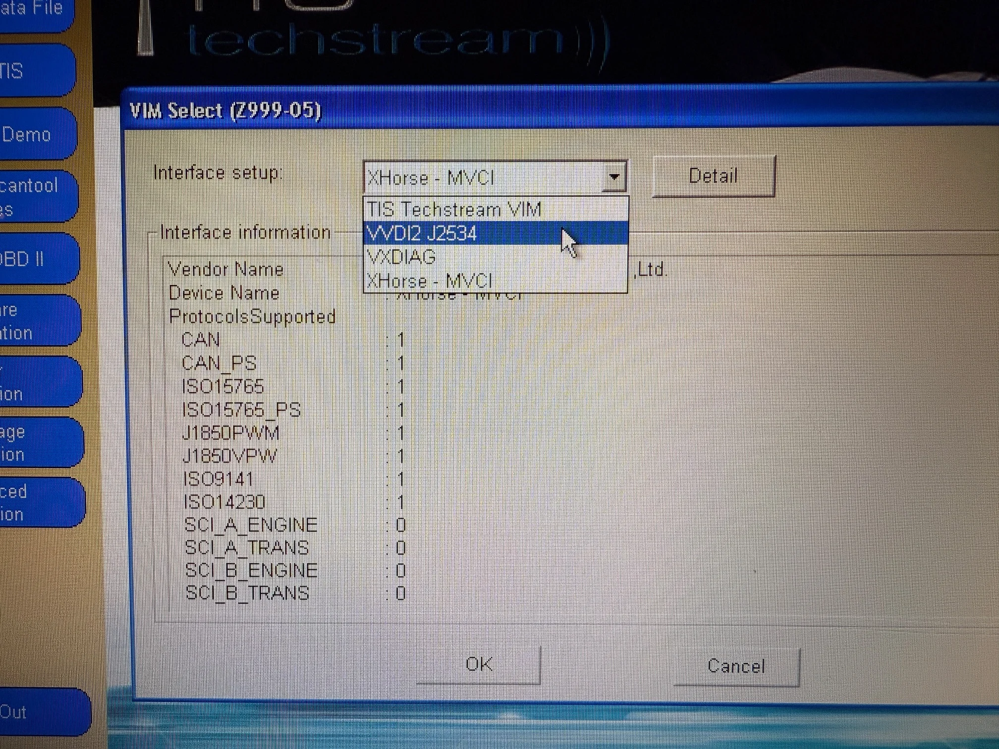

Second, I opened up my virtual box, and loaded up Techstream. At the top, select "Setup" > "VIM Select" > XXXX (whatever model cable you have)
Third, make sure the cable is plugged into the USB on your computer, at the bottom right of your computer, you should be able to click on "USB Settings", and you should be able to see your cable there. You HAVE to make sure you select it and a checkmark appears next to it like below:
One other thing I saw in an Amazon feedback comment was the following... not sure if it had any impact though.
PS: You'll know it worked once you selected the USB cable in the settings when the RED lights on the OBD2 dongle flashes once.
