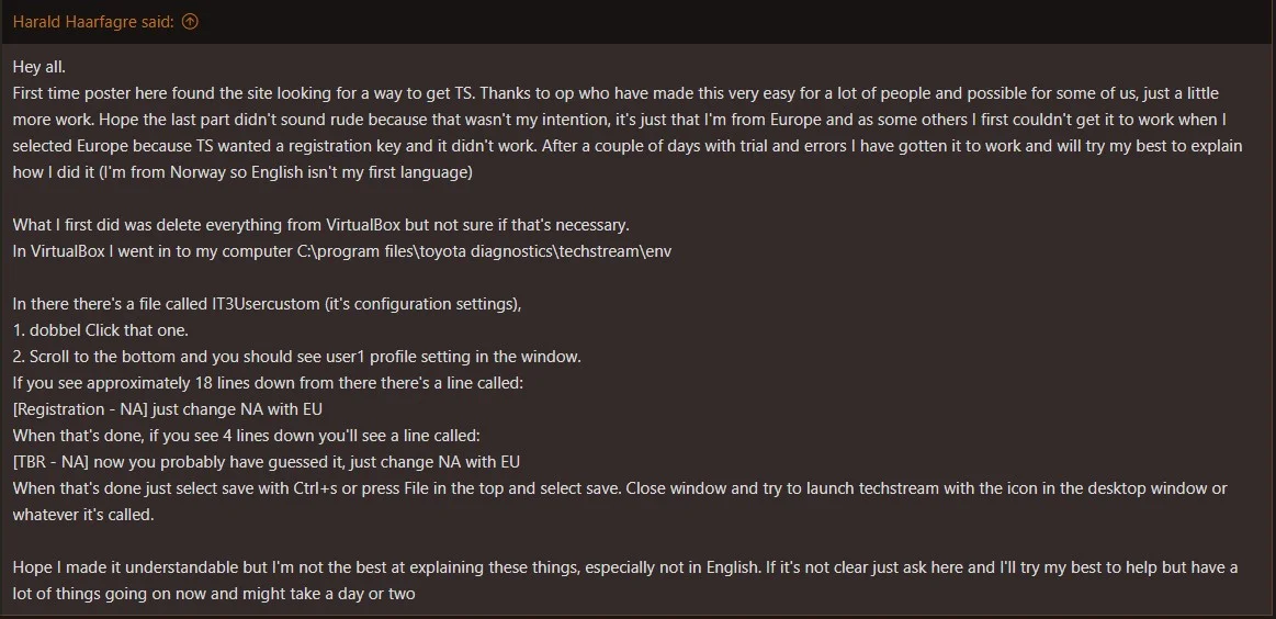

First time poster here found the site looking for a way to get TS. Thanks to op who have made this very easy for a lot of people and possible for some of us, just a little more work. Hope the last part didn't sound rude because that wasn't my intention, it's just that I'm from Europe and as some others I first couldn't get it to work when I selected Europe because TS wanted a registration key and it didn't work. After a couple of days with trial and errors I have gotten it to work and will try my best to explain how I did it (I'm from Norway so English isn't my first language)
What I first did was delete everything from VirtualBox but not sure if that's necessary.
In VirtualBox I went in to my computer C:\program files\toyota diagnostics\techstream\env
In there there's a file called IT3Usercustom (it's configuration settings),
1. dobbel Click that one.
2. Scroll to the bottom and you should see user1 profile setting in the window.
If you see approximately 18 lines down from there there's a line called:
[Registration - NA] just change NA with EU
When that's done, if you see 4 lines down you'll see a line called:
[TBR - NA] now you probably have guessed it, just change NA with EU
When that's done just select save with Ctrl+s or press File in the top and select save. Close window and try to launch techstream with the icon in the desktop window or whatever it's called.
Hope I made it understandable but I'm not the best at explaining these things, especially not in English. If it's not clear just ask here and I'll try my best to help but have a lot of things going on now and might take a day or two

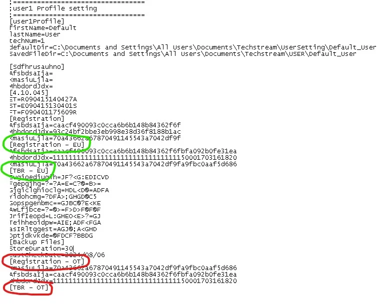

Hi, for me windows version says that the key has expired.
Any suggestions ? Thank you
Hi, follow Haralds Haarfagre instructions, Just make sure you turn off Network connection in the VM 1st so it doesn't try to communicate. The when you go to edit the file as per his instructions, you will need to change the letters to suit what you selected in the Techstream Configuration. This is actually located further down the "IT3UserCustom" config file. The last line of the text and the 4th line up will have the code you need to enter in Haralds instructions. Once these 4x match it should work. ie. The Green circles need to match the country codes in the red circles (The red ones are set from the menu "TechStream Configuration (S822-04)). Once you change these to all match, save and re-open Techstream and see how you go.
I live is Australia, so once i change Techstream Configuration to "Other", it throws up the expired error, once i go to the IT3UserCustom file and change the 2x green circled ones to match the red circled ones, it works. When you open it back up, it should say something in the bottom Left Hand corner like Subscription Expiration 2596d 23h 50m.
See attached Haaralds and screen shot.

Hey all.
Harald, you're a legend! Thank you so much! You post needs to be pinned to the top of the thread.
