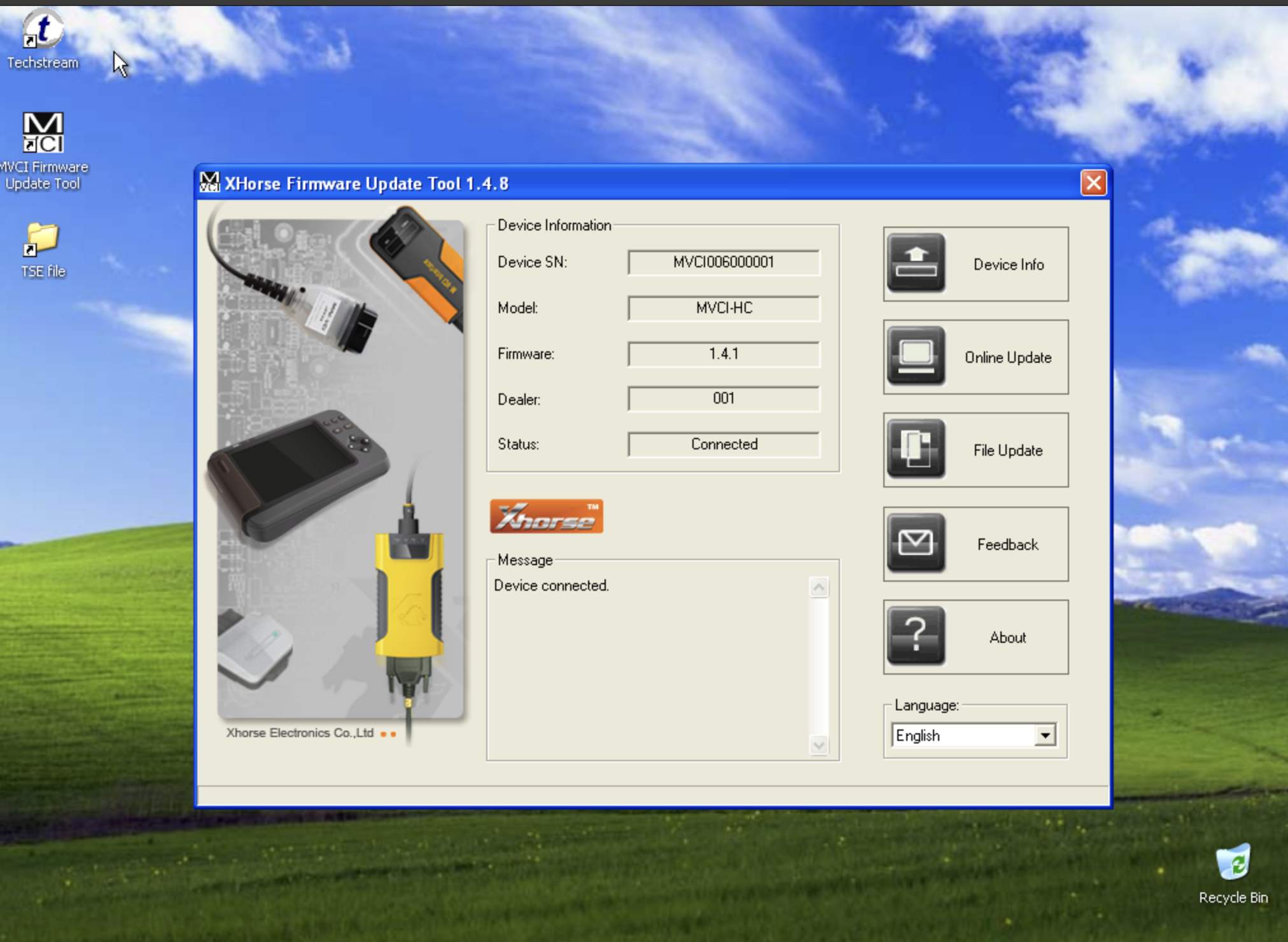

Running the VM from the 1st post on this thread on an M2 Mac. I am able to see the miniVCI J2534 USB device but when I try and open Tech Stream I just get the "Cannot connect to VIM" error.
Any advice? There's so much information on this thread it's hard to figure out what is still relevant anymore.

I run Windows so not sure if this advise will help you but try the following -
Ensure you have enabled the USB in the VM to share from your actual OS.
Close the firmware update tool before you start Techstream.
Hopefully those should enable you the access TS with your USB.
