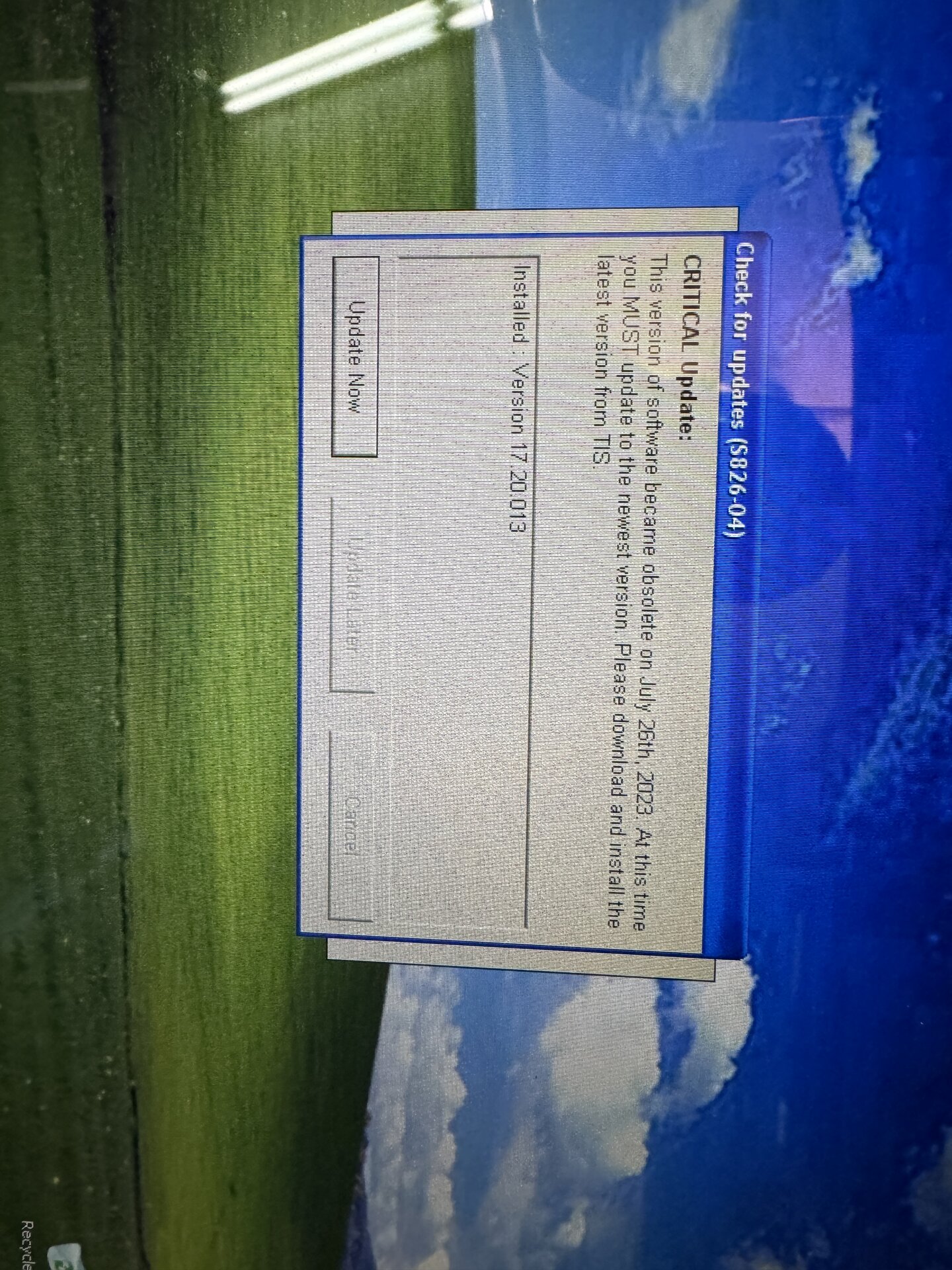

After my old single use (tech stream) windows laptop took a sh*t, I tried the Mac variant vm outlined in OP’s first post. I encountered the following error. Any help would be appreciated. TIA
After my old single use (tech stream) windows laptop took a sh*t, I tried the Mac variant vm outlined in OP’s first post. I encountered the following error. Any help would be appreciated. TIAView attachment 3612894
That's odd since someone just posted a couple weeks ago that they were successfully using an older version on mac.
I have a new cable coming this week and recently downloaded the mac friendly files from page one.
I'm hoping it works since I'm on the road for a while and 1000 miles from the shop I worked at.
You may need to make sure you're not connected to the internet when starting up TS after install
great...I didn't think of this and I was DEFINITELY online. I will try it next time. Thank you!!!
