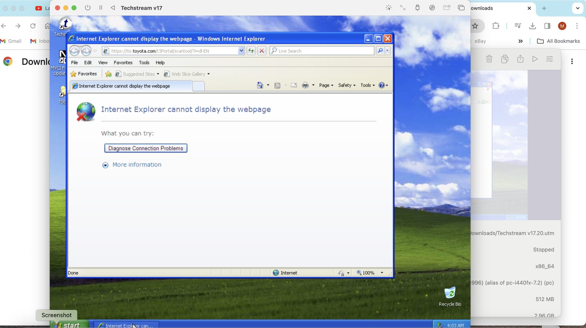

Does anyone having a issue with techstream on macbook pro m1? UTM downloaded fine with the techstream file but it wont allow me to access to the software. Its asking for update but it wont allow me even thou im on the internet

I was fighting this for a few days on an Intel based Mac and finally went back and reinstalled the TechStream image, deleting the first image that I had been using. It worked then. Can't explain why that worked.
i have had the same issue says it needs to update. I tried with internet off and then it just said failed to connect to VCI
No idea of what’s up I guess I will redownload
I have exact same issues :(
Please lmk if you find a solve
Any luck? Sadly this is going to send me in to a shop for such a stupid issue.
No sorry I couldn't, I even tried uninstalling it, delete the techstream file reinstalled it, turned off the wifi for techstream to boot. Still no luck. I just used my old MacBook pro 2010 and download the links from the 1st page and it worked flawlessly for me.

You can try disabling the network adapter in the settings of the virtual machine before launching it in UTM (Right click, settings, select network and remove) This will force the virtual machine to have no internet access.

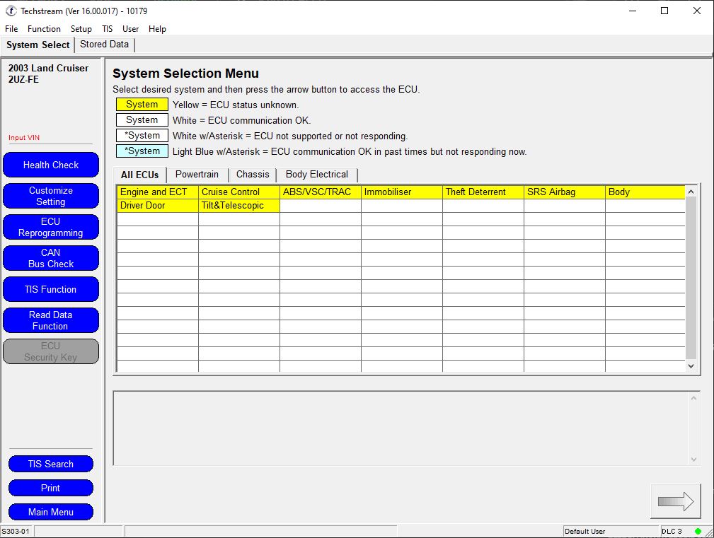

Hi All,
I installed the Virtual Box and followed the instructions in the first post.
Got everything to work and it connects to the vehicle.
But when I want to read the ECU for the ABS/VSC/TRAC it just keeps reading for over 10 minutes.
Looks like its not responding any more, or is the application just very slow and am I to impatience.
thanks

Solved it, the old version 8 and XP didn't seem to connect properly to the cable.
Found a source for Techstream v12, installed it on Windows 10 in the Virtual Box.
All works fine now, and I was able to preform a Zero Point Calibration.
