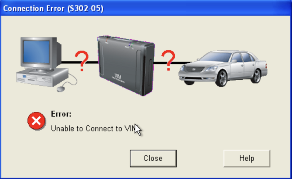

Tried to run this on M1 Mac. At first I got an error about software being too old, I changed the date in the VM and it seemed to start initializing, but then gave an error that it's unable to communicate to the VIM. I see the VCI interface connected to the VM and able to read it's firmware (1.4.1). Any thoughts?

Was able to get this working today after a few trouble shooting items. Sorry to hear for all those that are having issues. I was nervous I was going to also be in that bucket, but thankfully made it work.
  • The Rig: 2001 LX470
  • The Computer: 2012 Macbook Pro Retina (Intel)
  • The Cable: I ordered the v18 version on amazon (same link as the post above) "VCI J2534 Cable Fit for Toyota TIS Techstream" Given the firmware is the same (V1.4.8) between the three options listed there, it probably doesn't matter which one you get?
  • I followed @getco instructions in the first post and everything installed well
  • I got the "Unable to connect to VIM" message with the first attempt out of the box. I found this post (How-To: TechStream In 5 Minutes - https://forum.ih8mud.com/threads/how-to-techstream-in-5-minutes.1034923/post-14687527) which had the fix for me:
    • "1. You need to make sure your cable can be seen by Windows. Make sure the USB device is mounted in VirtualBox settings: VirtualBox -> Devices -> USB -> Select your cable (mine had M-VCI or similar in the name - via USB-C adapter). Windows will beep you once it's found it."
  • I got it to all load up, but AHC wasn't there! Doh! Then I read you have to make sure you select LX470 when you start Techstream. Once I did that, I got it all to work!
Huge thanks to getco and all those that have helped trouble shoot this. And sending good vibes to those out there still struggling with this that you too can figure it out.
