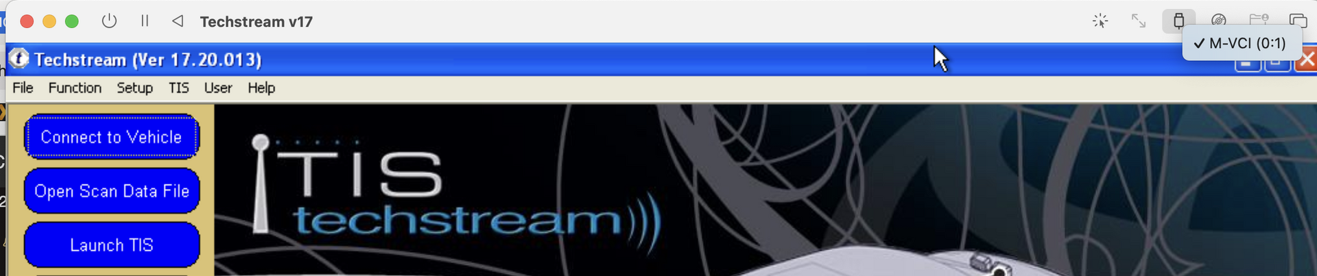

@Wheeliee are you using Virtual Box or UTM? I've found that I have to manually select the usb cable. It only auto connects the first time for some reason.
It shows up here on UTM. I think it's under "devices" on Virtual Box.
I am using virtual box through my MacBook and I do have to select the usb each time. That seems to work fine and it sees the cable along with the tone it makes when it connects but when I try to connect through techstream I get this error that says can’t connect to vim. On the first bad cable I had it just never recognized the cable . It worked great earlier today so I am baffled . I’m going to try on a windows based computer tomorrow 😑

Hey everyone. Thank you @getco for sharing this guide with us. I was able to get Techstream running on an M2 air. I'm using a generic VCI J2534 cable purchased from Amazon (click on hyperlink).
I was able to get around the "Unable to connect to vim" error message by selecting the XHorse MVCI driver from the TIS main menu.
1. Within UTM, make sure you're passing your USB device to the VM. You'll see a checkmark next to the device.
