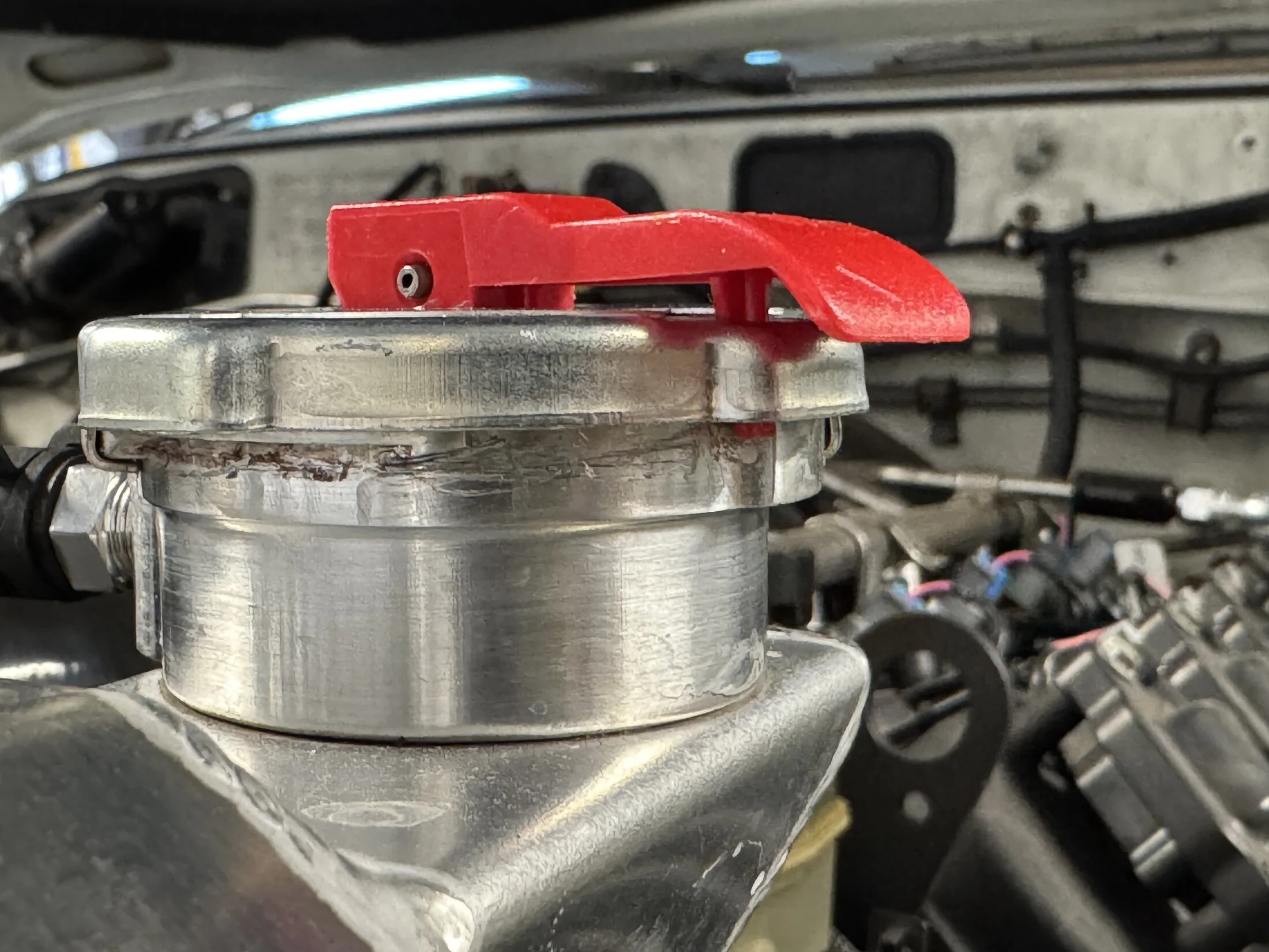

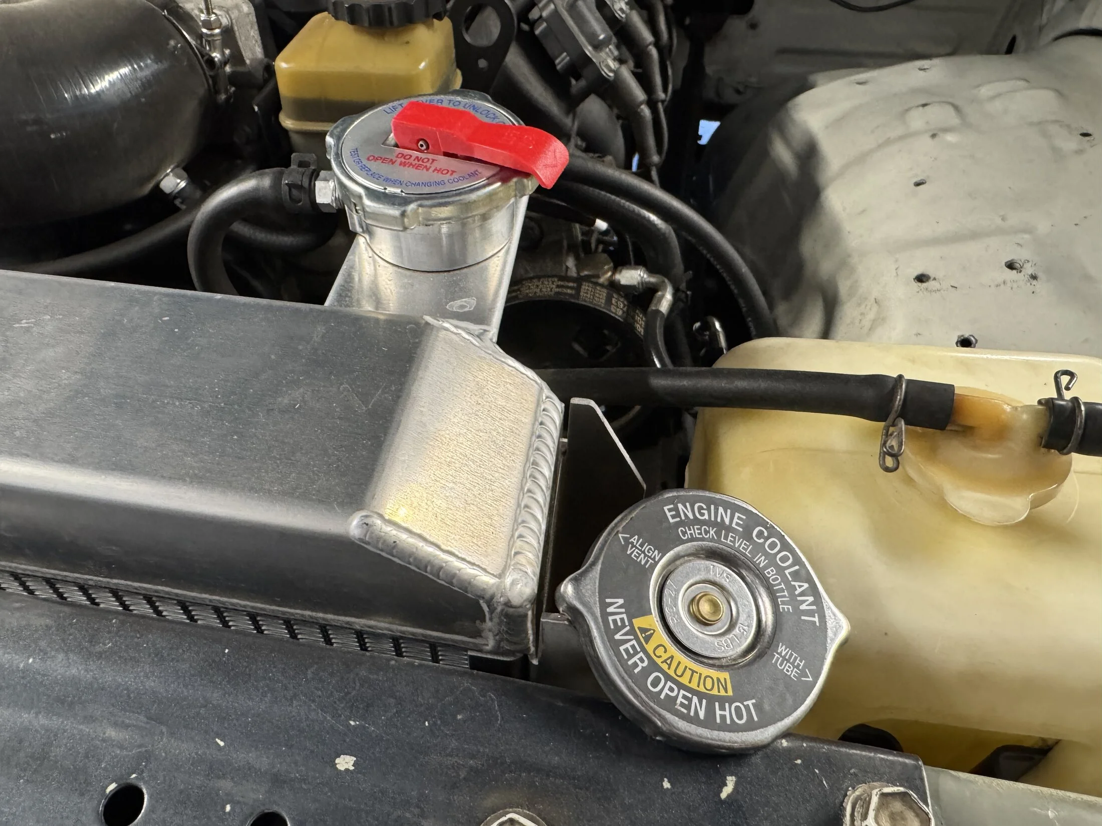

On my FJ40 with LS swap - I’ve been through a million different caps. I have had a 13-17 and 21# stant all of them burped. I now run a cheapo 19# and it still burps. I have given up. Open to discuss with all of you. I need to solve this too.
What pressure radiator cap are people using? Did some light wheeling today and never got above 210 but my 15psi cap was burping fluid into the reservoir
I was using a 28 psi cap for a year or two and couldn’t figure out why all of my heater hoses were leaking. It was mostly the rear heater hoses. Turns out 28 psi is way too high for the 60 series. I’m using a 15 psi stant cap now and have very minimal hose leaking. I would delete the rear heater but it’s nice to have with my daughter in the back seat.
I do get some burping but I always assumed it pulled it back in. My coolant level goes up and down in the overflow bottle. Maybe somewhere between 15 and 20 is the ticket? I like the lever lock radiator caps a lot.
I think you have to find the Goldilocks zone of no burping and not leaking coolant in your heater hoses.
I’m running the cap that came with my FSR radiator and never had any burping issues or new coolant leaks. Truck consistently runs at 190-195, never seen it go any higher.
Only leaks I have are my hard lines for the rear heater which leaked before too.
That’s where mine leak. They’ll leak at the back or at the Y fitting on the firewall. Dropping from the 28 psi cap (what you have) to 15 helped a lot with the leaks
