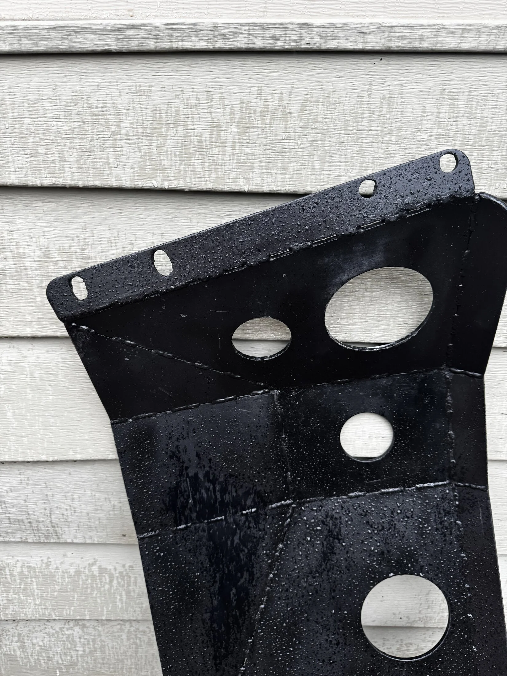

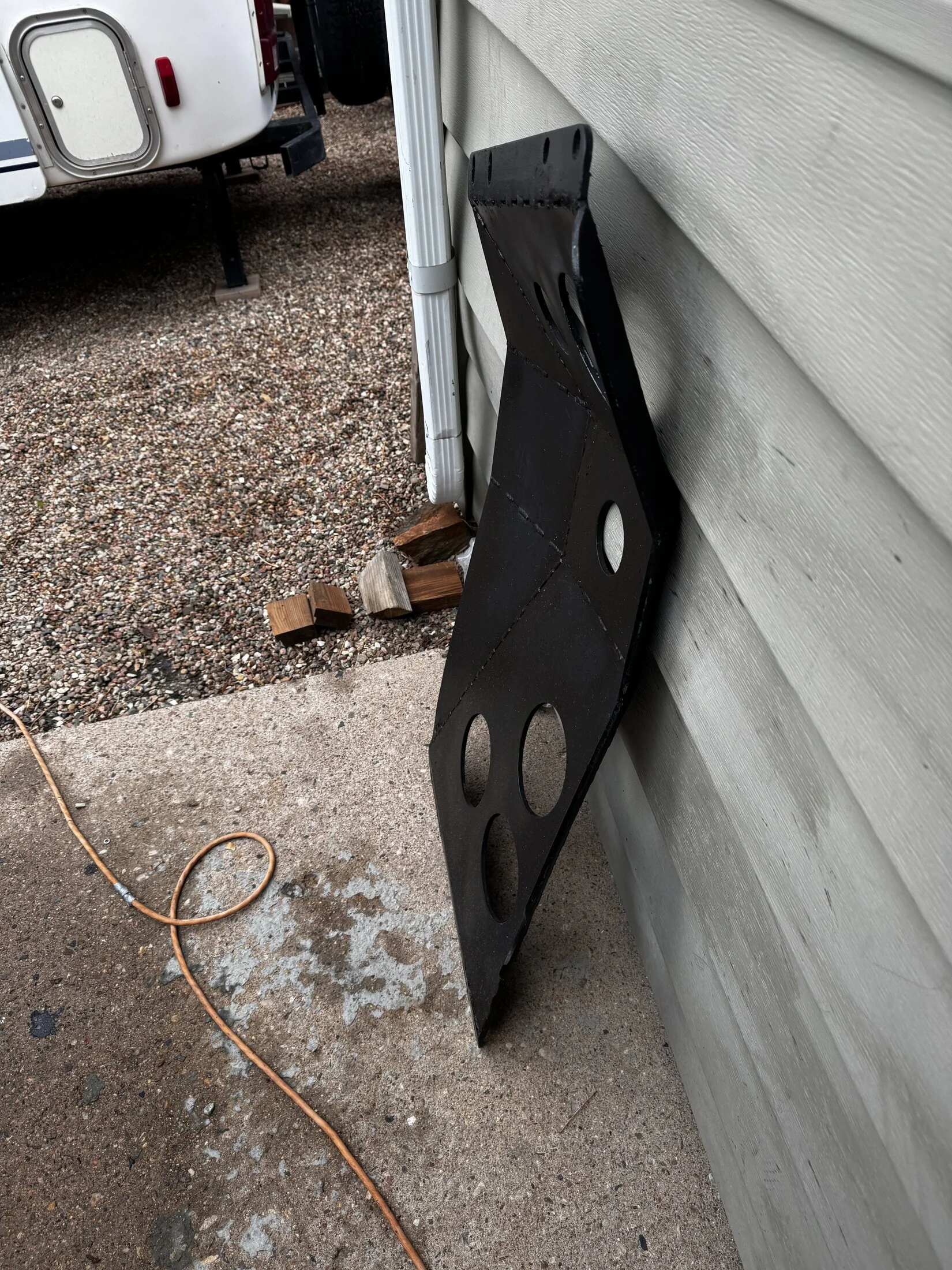

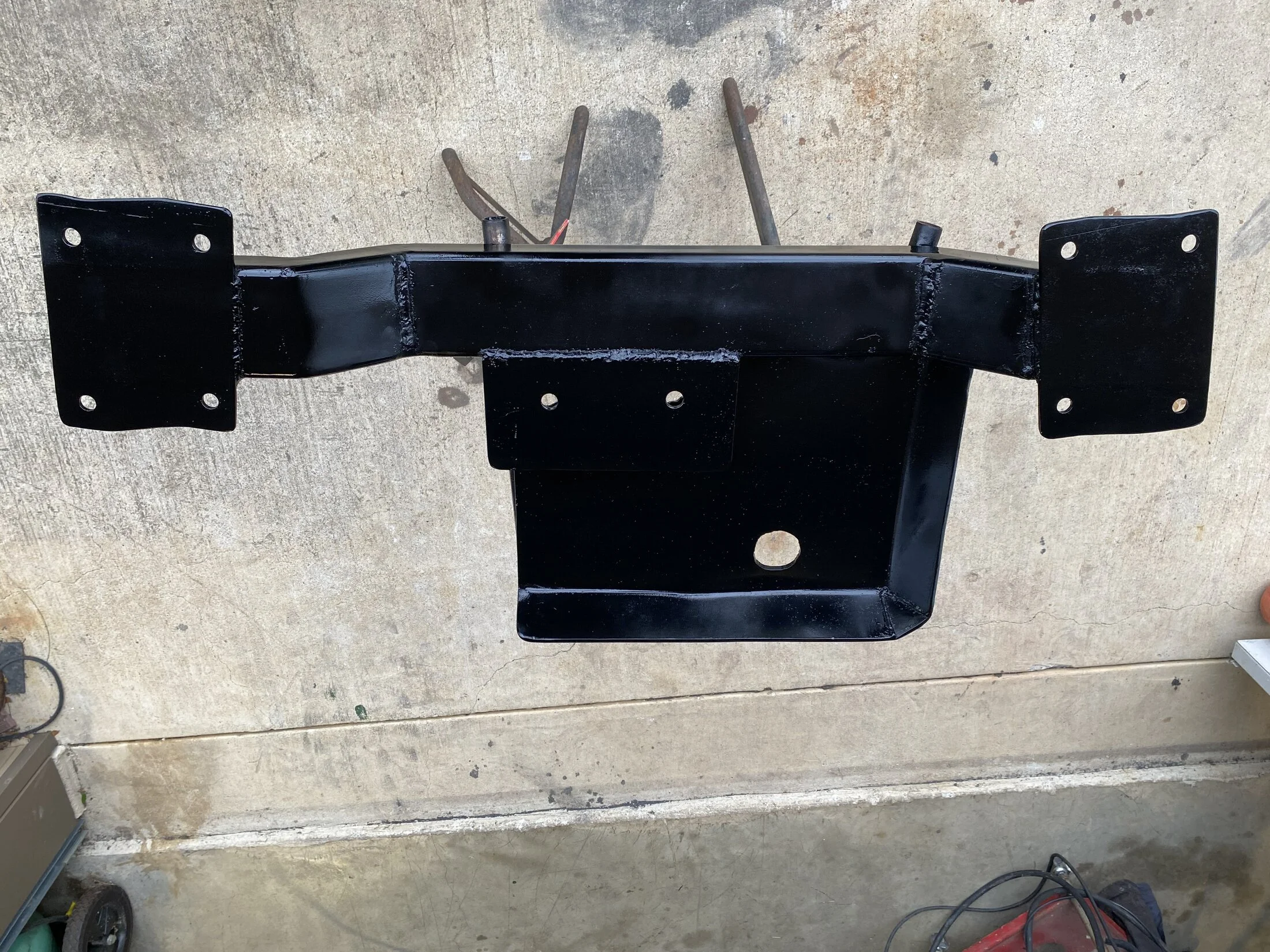

Finished a crossmember/skidplate for the swap.
3/16” 2x4 square tubing, 1/4” plate bent with a 20 ton press.
Found the limit of a homemade press brake…the reason for the bow in the skid plate.
A step drill bit rips big holes faster than a regular drill bit. Drill a 3/16” pilot and then cut a huge hole in no time with the step drill bit. Your drill will let out a little smoke if you push it too hard.
Decided to leave one side of the skid plate open for easy cleaning. Also, for the skid plate to be able to flex and be bent back.

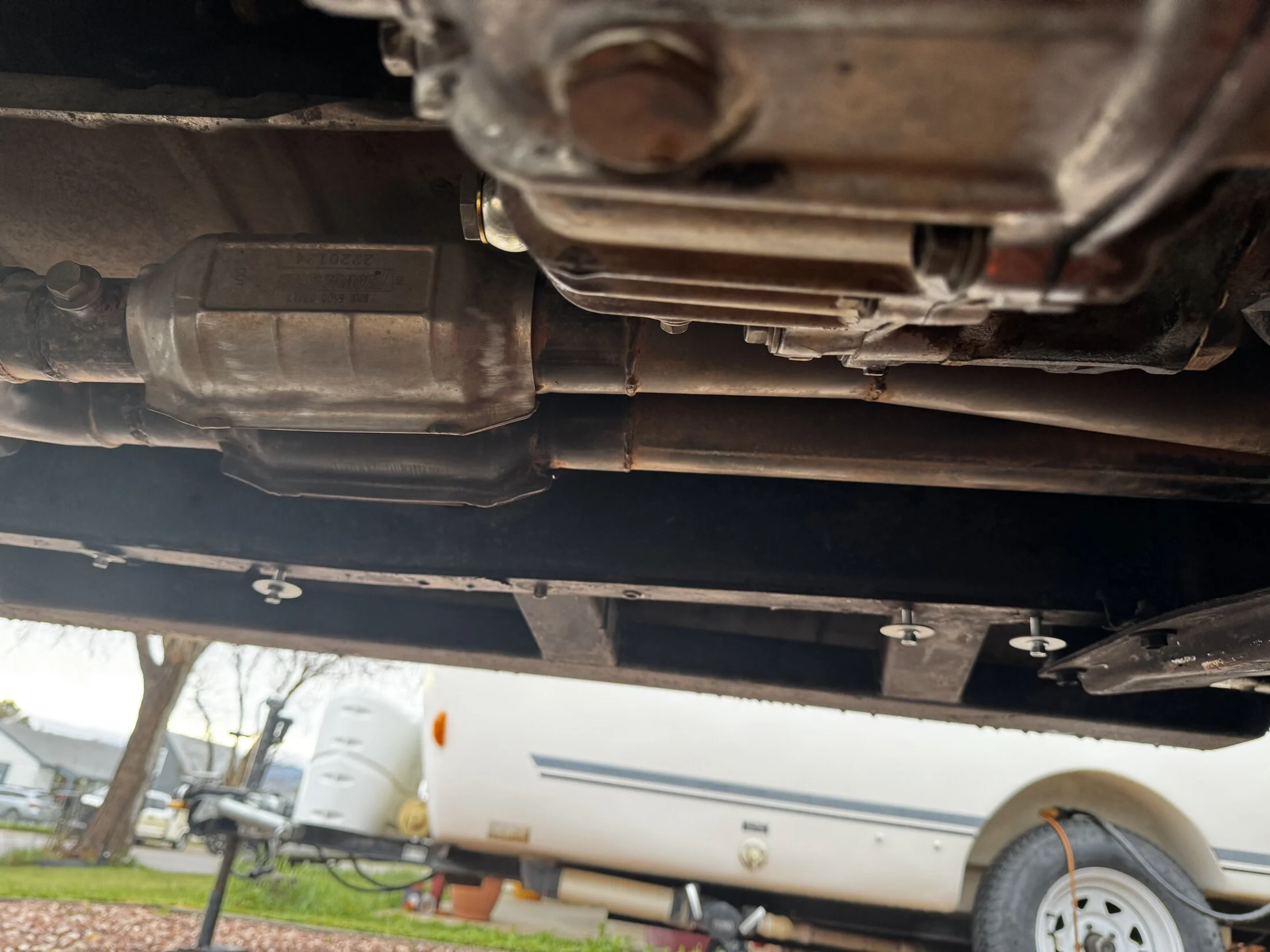

Running a 3/8” steel one with a few access holes, only 45.6#. Easy off hard on (well my only “garage” and flat spot in driveway). Little weather Dependent working by myself.
Tapped some holes to frame (disregard the nut certs) and bolt on.
