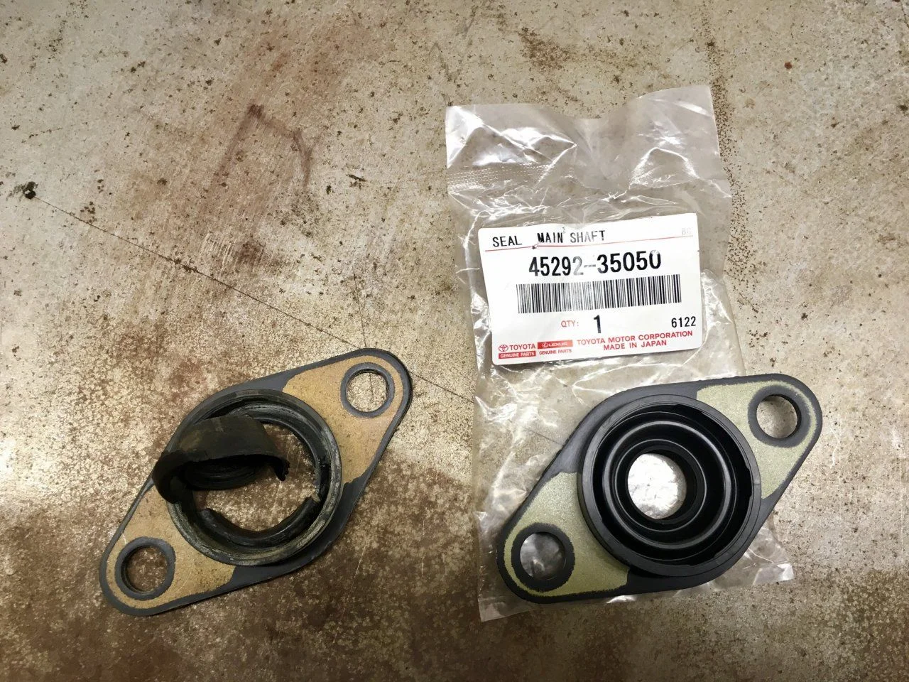

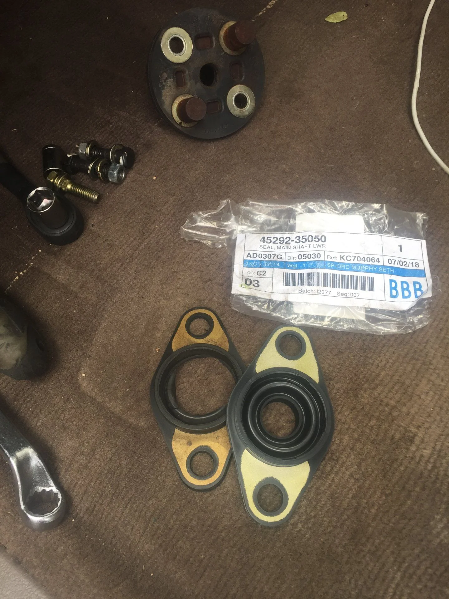

Did this with OEM this afternoon.

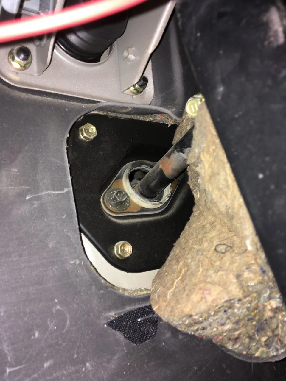

reinstall the seal to the floor board LAST.
Tighten the seal bolts last as the seal bolt holes have some wiggle room to allow it to seat well with no stress to the rubber when everything above it is tightened properly.

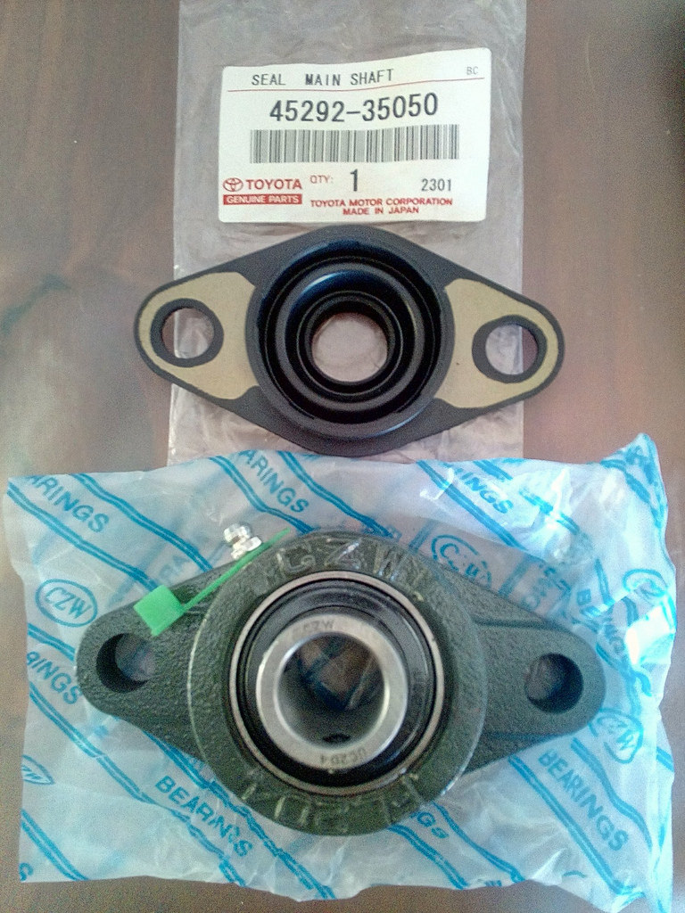

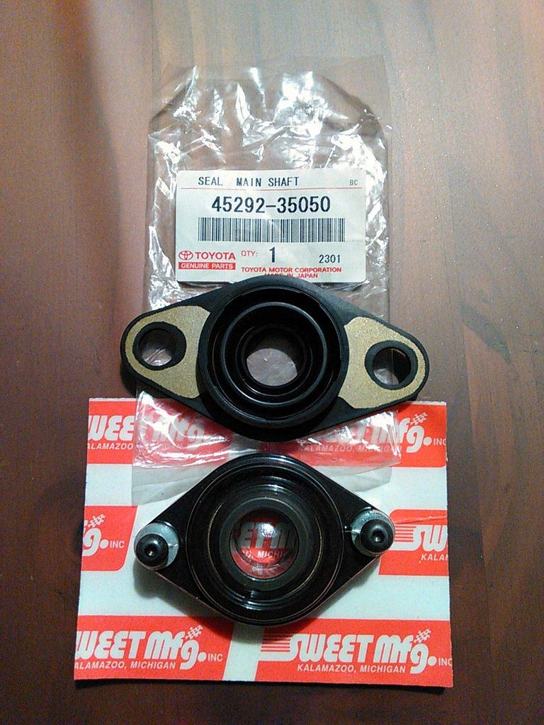

The cheap UCFL-204's were way too big and chunky and didn't match the bolt spacing of the factory seal. The Sweet # 405-10405 'lightweight' 3/4" bearing units are really high quality but their bolt hole spacing is smaller than the factory seal.
Koyo UCFL-204 cheap Chinese knock-off copy (!) vs Toyota # 45292-35050 :
pic page
Sweet # SWE405-10405 vs Toyota # 45292-35050 :
pic page

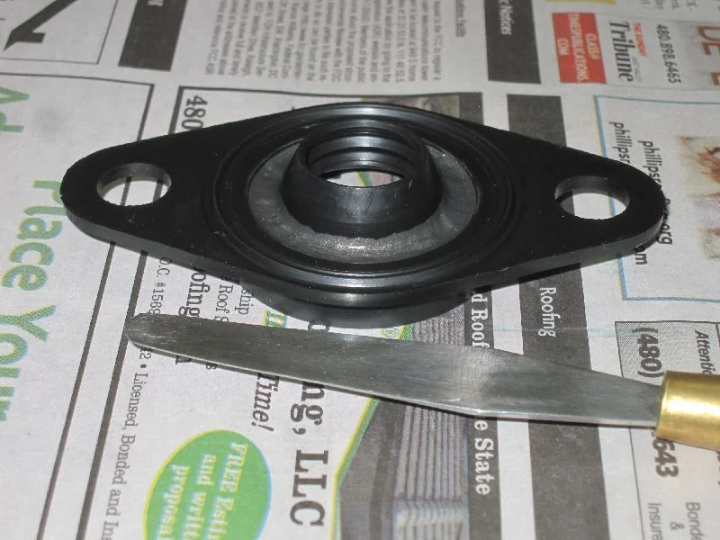

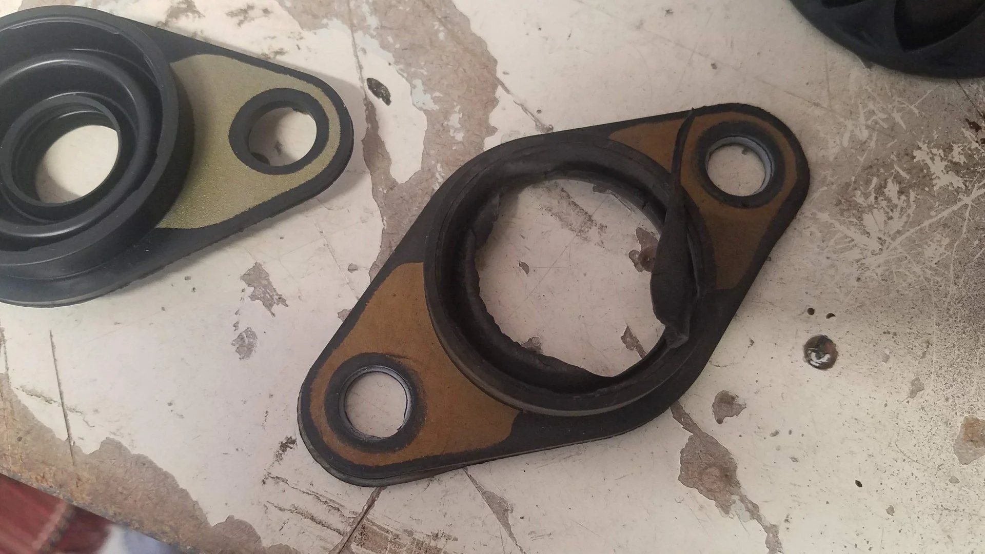

Someone suggested re-enforcing the common failure point with RTV, so I gave a try.
Seems to work fine. Still flexible.
Wiped the groove out first with xylene and MEK on a Q-Tip to enhance adhesion.
Spooged in black gasket RTV with the tip of a painters pallet knife, round and round, until it was smooth.
We'll see in a few years whether it helps or not.
