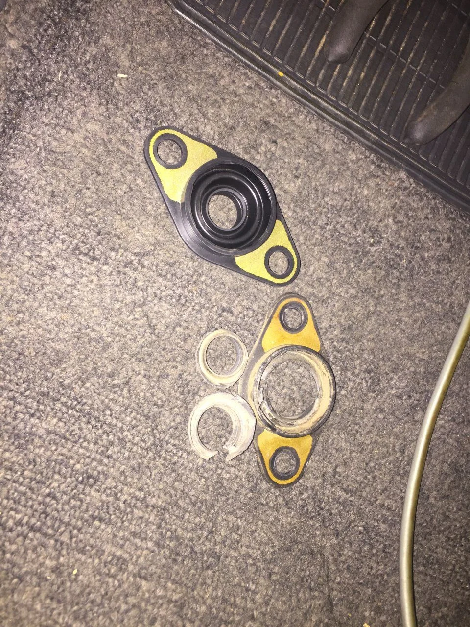

I mentioned it way back a few years ago but never tried it. Instead I applied a few coats of rubber PlastiDip to reinforce the thin rubber of a new seal. It's still in good shape four years later.
Looks like I will return it and get OEM. In the picture of the aftermarket one it shows what looks to be a thin black seal, but the one I received does not have any rubber on it at all. Seems like dirt will get into the rotating part of it likely causing noises, etc. Thx
Did the bryke racing one. Ended up going with a OEM rubber one. It squealed a lot. I even soaked the bearing in motor oil before I installed it.
I guess I'm lucky. I also went with the Bryke Racing one, and it did squeak when I turned the wheel for a few days after installing, but then the squeak went away completely. YMMV
Ordered an OEM one today. Will have it tomorrow. $12.

I used a floor matting in place of your cardboard as temp fix until OEM part was obtained. Needed a seal like now as diesel exhaust was invading the cab when I purchased it.

Just replaced mine. The old rubber had turned into brittle plastic after 400k miles
