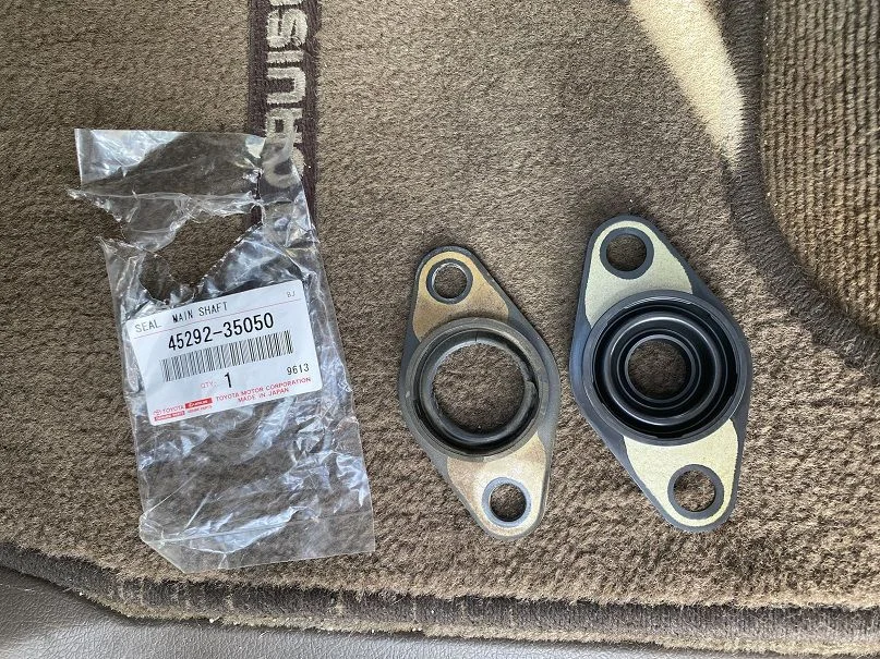

Replacement completed with OEM part. Thank you @LandCruiserPhil for starting this thread and to the others for all the comments. Much easier route than the FSM.
