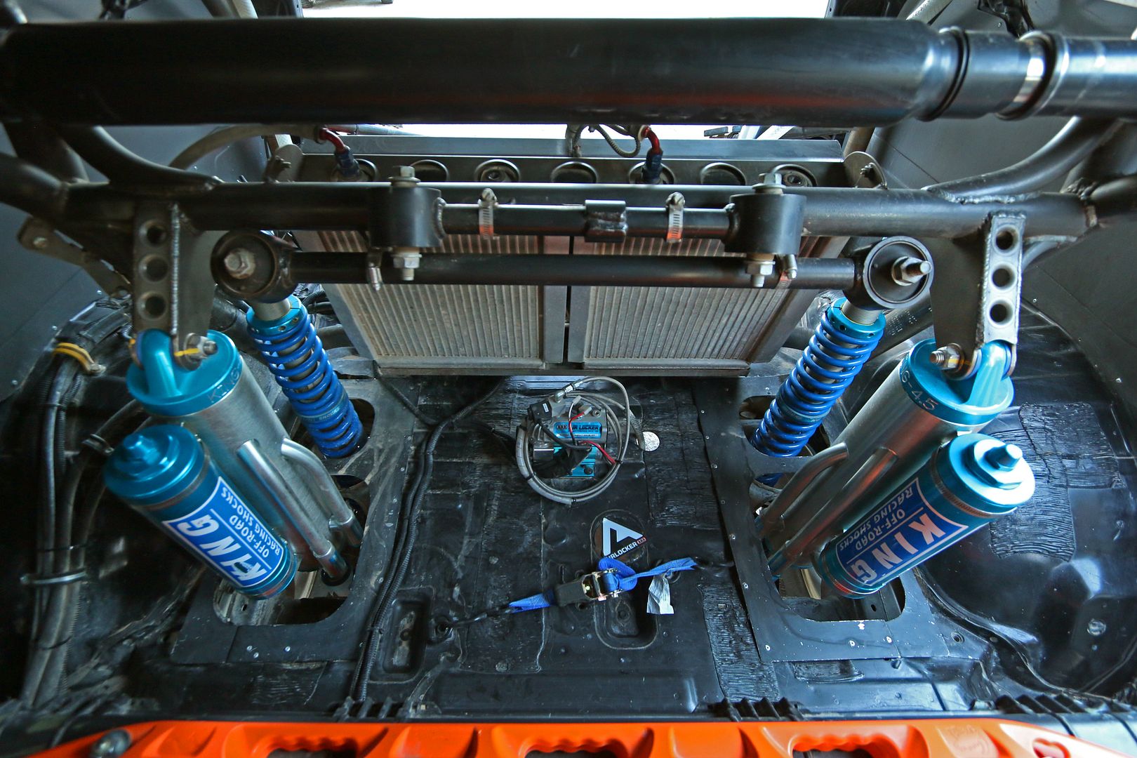

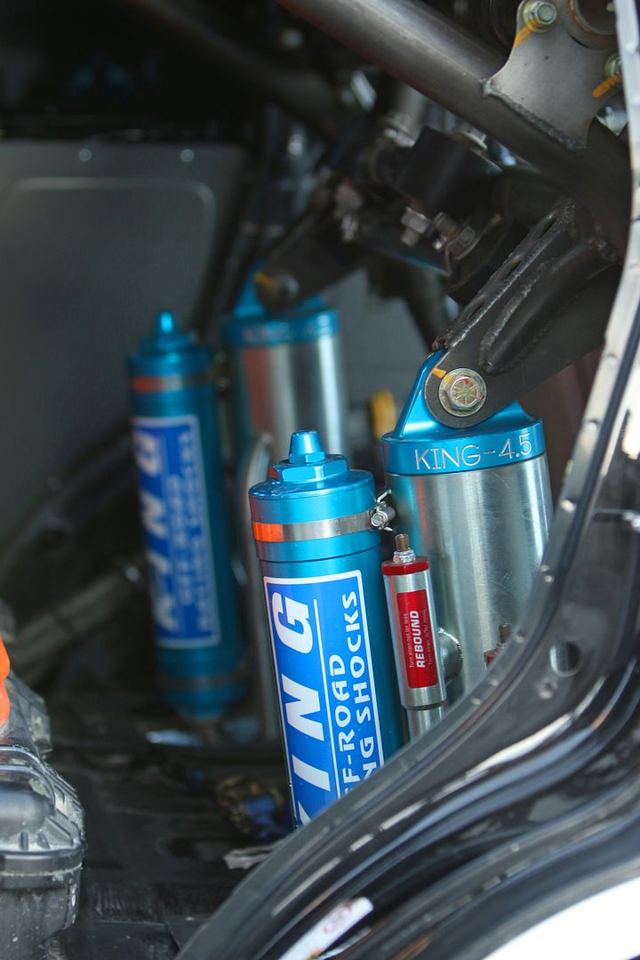

Not quite a direct comparison given that the 200 Series has IFS but Canguro Racing has been competing (and winning) their class for a few years now. The have been racing the Baja 1000 in the "Stock Full" class which requires all factory suspension links, steering etc, but allows for upgrades to shocks. The truck is running King coilovers with a secondary bypass shock in the front and rear. This truck is pushing almost 20 offroad races on the chassis. It has won the Stock Full class in the 1000 prior to being purchased by Canguro Racing (all made of up Cruiserheads that don't have limitless budgets or massive factory backed sponsors). The first year with Canguro, it took 2nd in Class behind the Toyota Factory/LongBeach Racers built TRD Pro Tundra by only a small margin.
Just this past weekend it raced the Best in the Desert Series Vegas to Reno (longest offroad race in the US) and raced in the Class 8000 Unlimited class. Basically full sized trucks/SUVs with unlimited suspension. Canguro is still racing on Toyota factory links, axles, steering but won the Unlimited class over the weekend.
Having had a bit of time co-driving in the truck and much more time chasing with the team, I believe the 80 Series can be built to compete in these classes and 50-65mph should be reasonably within reach. The Solid front axle isn't ideal, but as has been mentioned classes like JeepSpeed etc have vehicles running solid axles and they do well. The Canguro 200 Series will hit over 100mph on some sections of race course. For an 80 (or any truck for that matter) I think that keeping the truck as low as possible is important. Open up the wheel wells to allow more up travel. It's very common to have much more down travel available, even on trophy trucks. Cruisers just have a lot of heavy body that's up pretty high and stability can be compromised so keeping it low will help.
Obviously proper safety equipment is needed. Stripping out as much weight as possible is important, especially when you're adding in a bunch of weight with a full race spec'd cage. You'll definitely want stronger coil buckets/shock towers with lots of bracing. If you're serious, I personally think airbumps are worthwhile. Foam bumps may do the trick, but are not ideal.
Finish line of the 2014 Baja 1000 with the TRD Pro Tundra and Canguro Racing 200 crossing the finish line ~40 min apart after 1200 miles.
Livery change for 2016
Crossing the finish line Saturday night to win the Vegas to Reno Class 8000 Unlimited class
rear setup
If the goal is just to build a "prerunner" that is capable of good speed but still needs to have full interior/seats then the approach would be a bit different but still follow similar principles.
