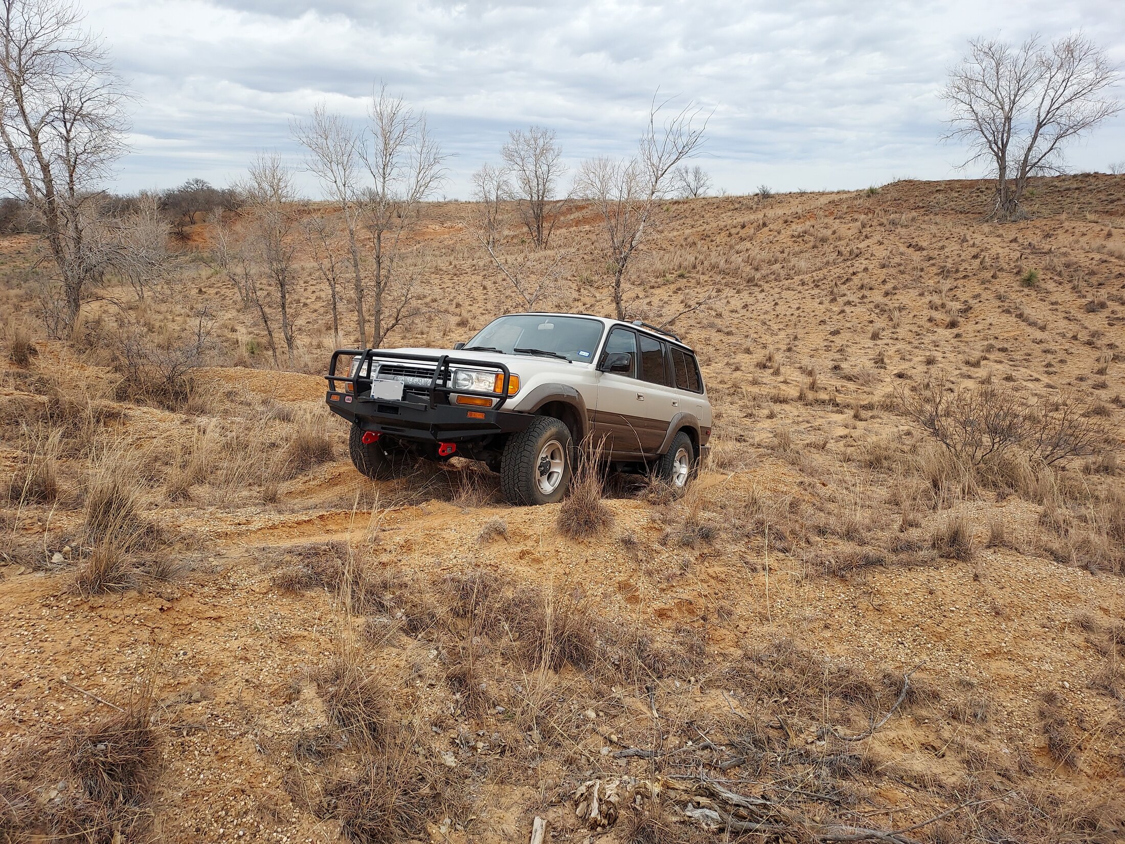

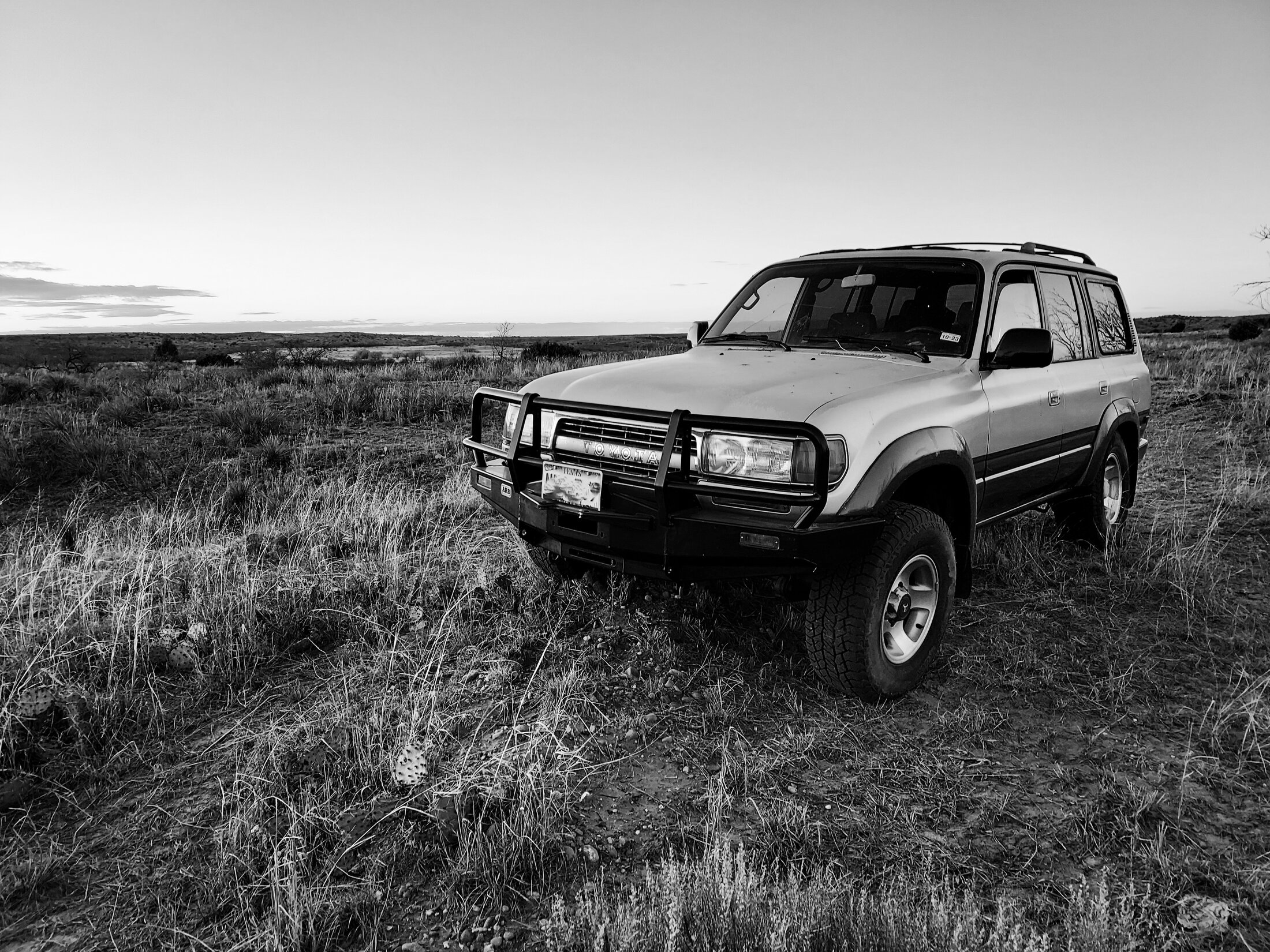

Hey everybody! I've been a viewer on Mud nearly daily since I caught the bug a number of years ago. I just haven't ever set up an account until now.
My family has too many LCs, ranging from projects to daily drivers, and it turns out, I've become more or less responsible for coordinating maintenance/modification/and repairs on the fleet.
I posted this in the 80-series section, as that is my favorite series, and my daily driver (More about that later), but we have several from other series as well.
Here's a pic!
