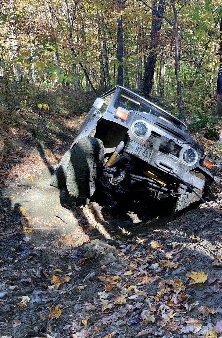

For the sputtering/ bogging down issue, check your fuel filter. I had an issue with mine recently after going off road and being very off camber in both directions for multiple hours. I think it stirred up a bunch of crap in my tank and impeded my fuel flow. Thankfully I had spare filters with me (I have one pre-pump and one pre-carb). After swapping them out I didn't have any more issues. I'll probably pull my tank this winter and get it cleaned.

@FJmaine Nice rig! Great shot.

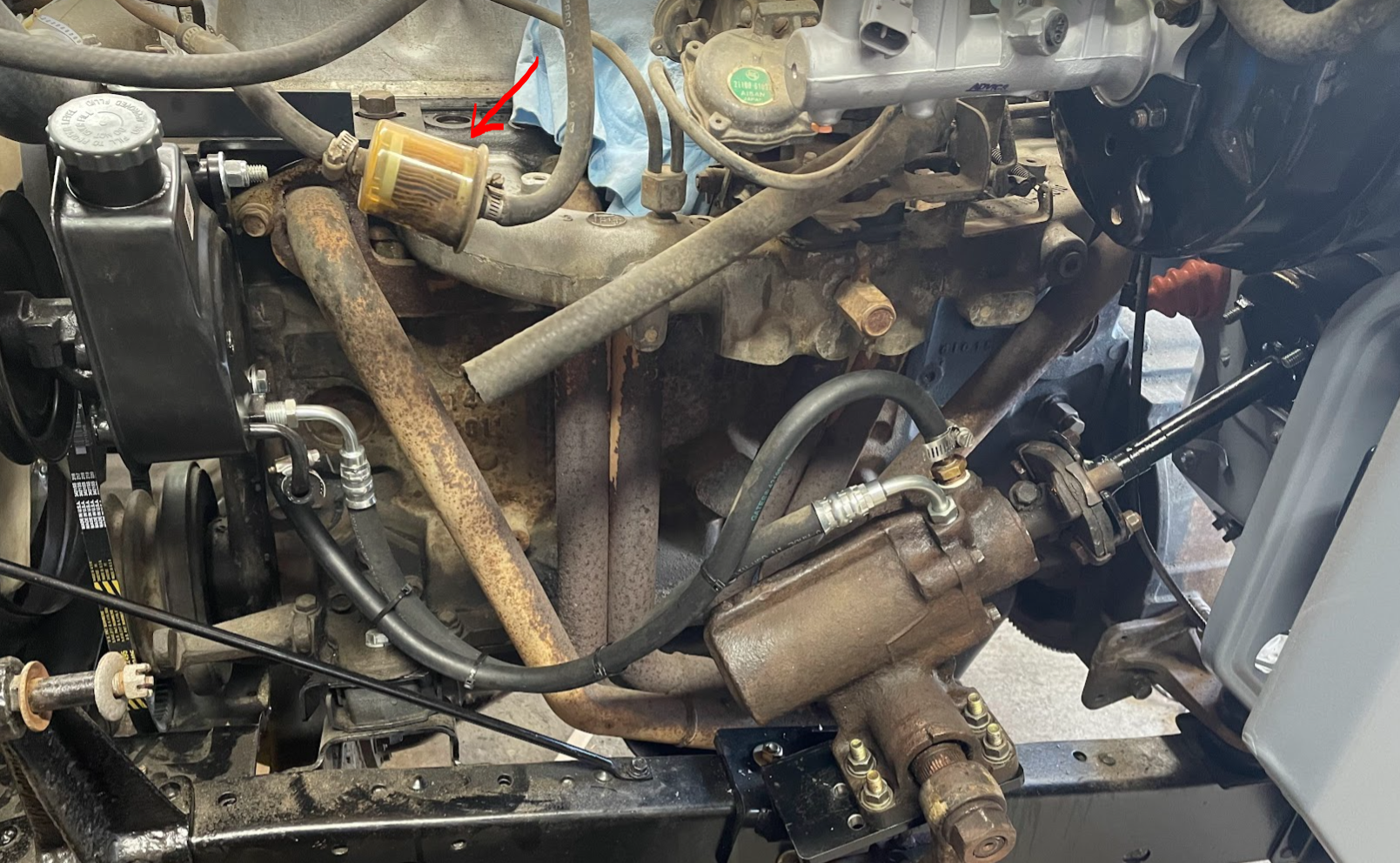

Any advice on how to check the fuel filter? Willing to learn, just unsure where to start. I will take a look this weekend and see what I can troubleshoot.
I'm not sure what you have for a filter. I put a couple of these in line. They are clear, easy to read, cheap, and easy to change. You can see that the one in there is old and full of debris.
