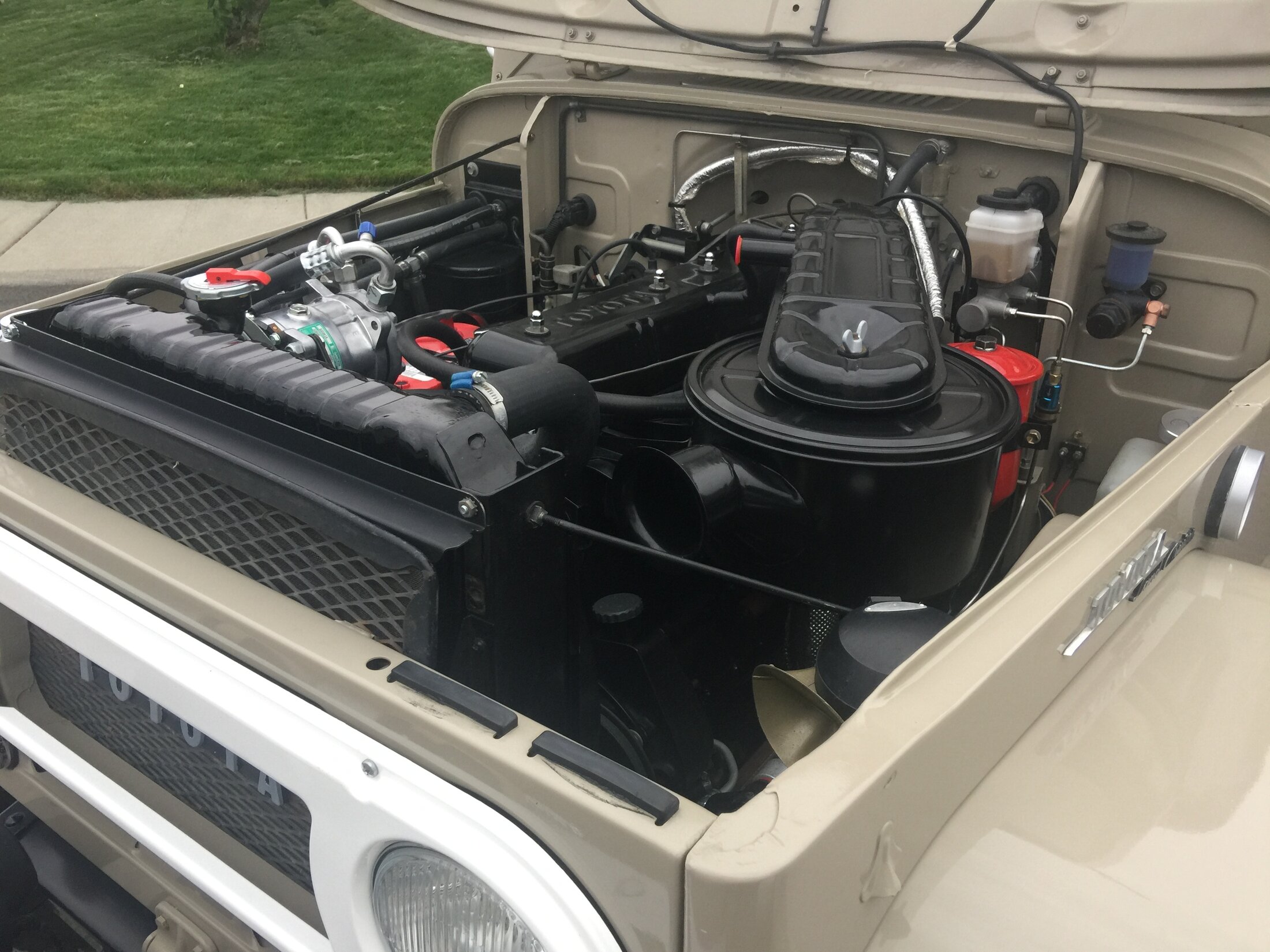

Yes, the PO (or PPO) cut off the down tube and the connection is made with a rubber hose. I'd be curious to see how yours is mated to the carb. Are you using a rubber gasket on the carb? (5/75)
I’ll take it off this weekend, get some pictures and PM you….
Where yours is cut, there should be a short neck with a clamp. Then there is a rubber sleeve that gives a snug fit to the carb air horn. Fits perfectly. In fact, when I restored the rig, I got a new rubber sleeve from SOR.
I wonder if there was a different aftermarket carburetor installed prior to the B series????? And that’s why it’s cut up.
Mine looks like Mark's, except the PO put a screw/stud in the carb center, drilled the connector duct and then put a lock washer and wing nut on top - this was because it would pop up when off roading and then not have a seal.

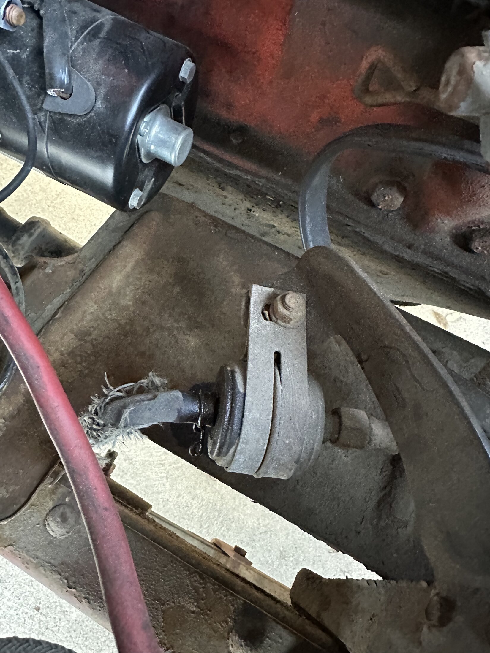

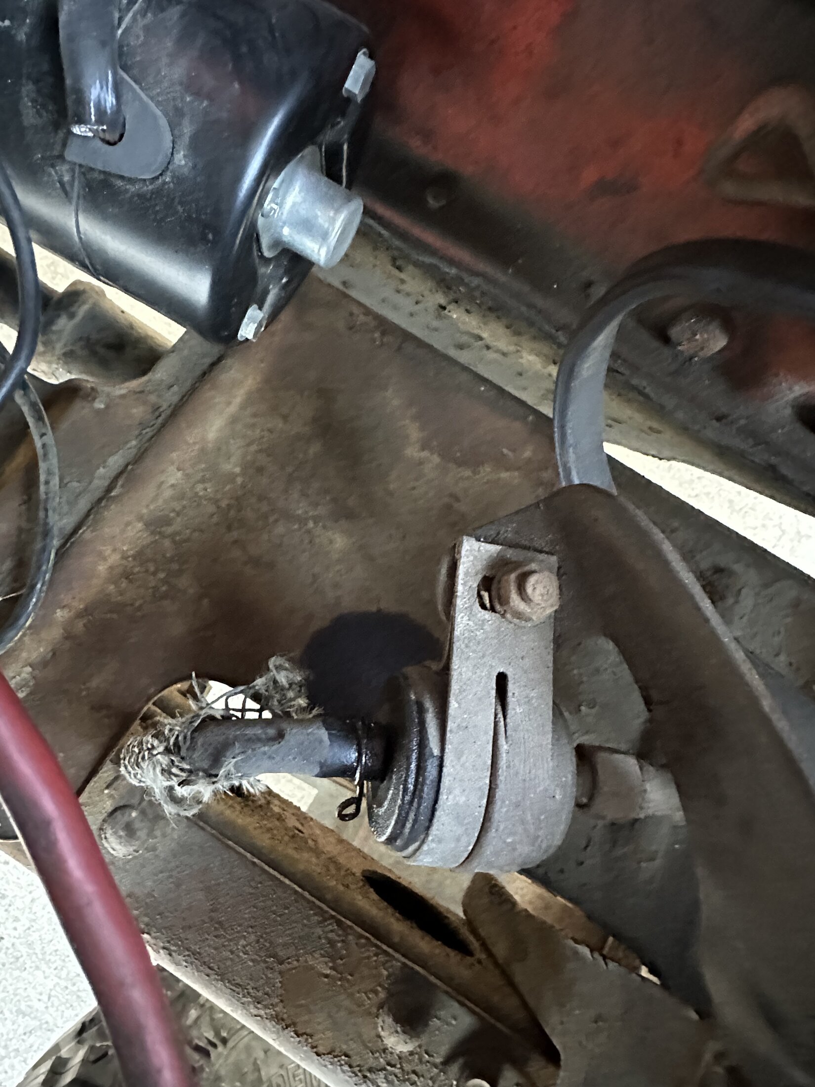

In other news, I just tried starting the rig and it cranked but never started (welp). I looked under the hood and noticed this was leaking (whatever this is, it’s attached to the fuel pump). I’m guessing another type of filter ?
You’ll have to excuse my ignorance. learning with trial and error.
I don’t think this is related to my shaking issue, but it could be what’s causing the sputtering !
Fuel filter. I thought you said you replaced it. That looks old. Can you take a photo of the one you replaced?
I thought I did as well. I have been replacing another one near the carburetor. I did not realize there were two (welp).
This one is easily sourced from Toyota or any Auto Parts store. Once you fix the leak...you may get lucky and just have to trim the end of the hose. You may have found one of your problems!
