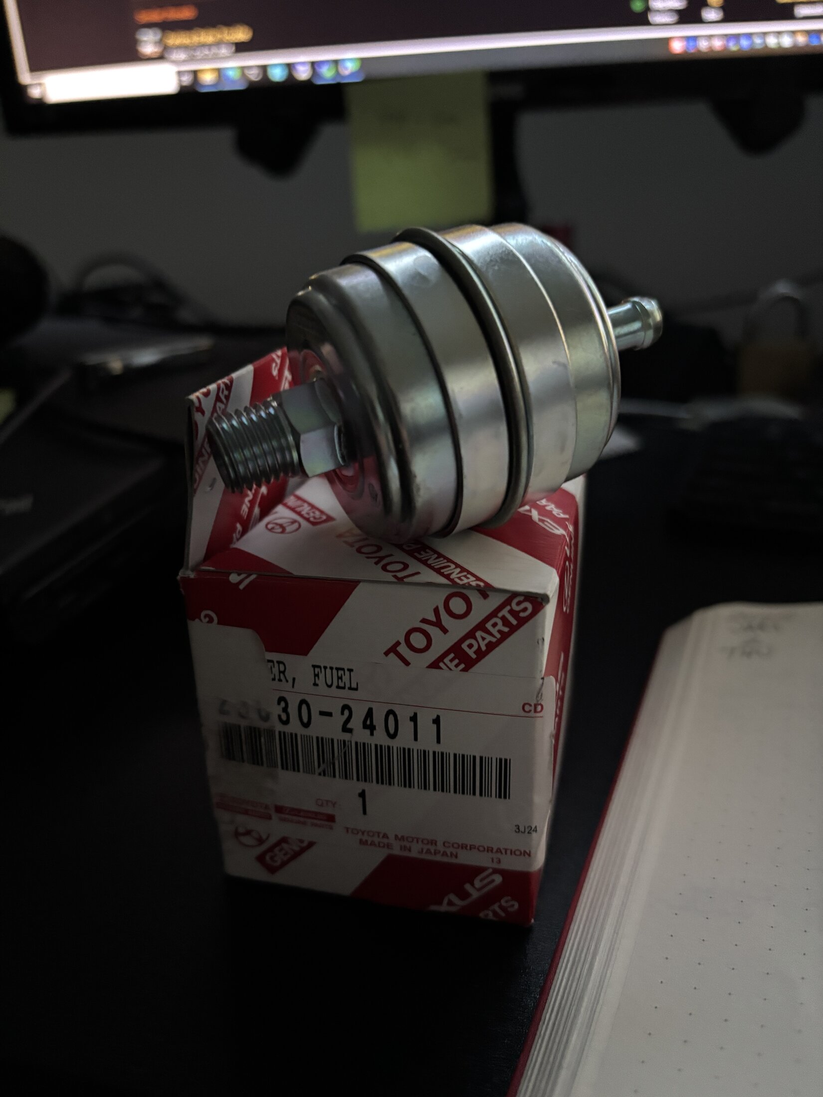

do i need a different type of filter for this newly discovered filter ?
Yep, yours looks like a 23030-24011 about $12 from Toyota.
The supply line on the stk filter is scary looking. You should replace it too.

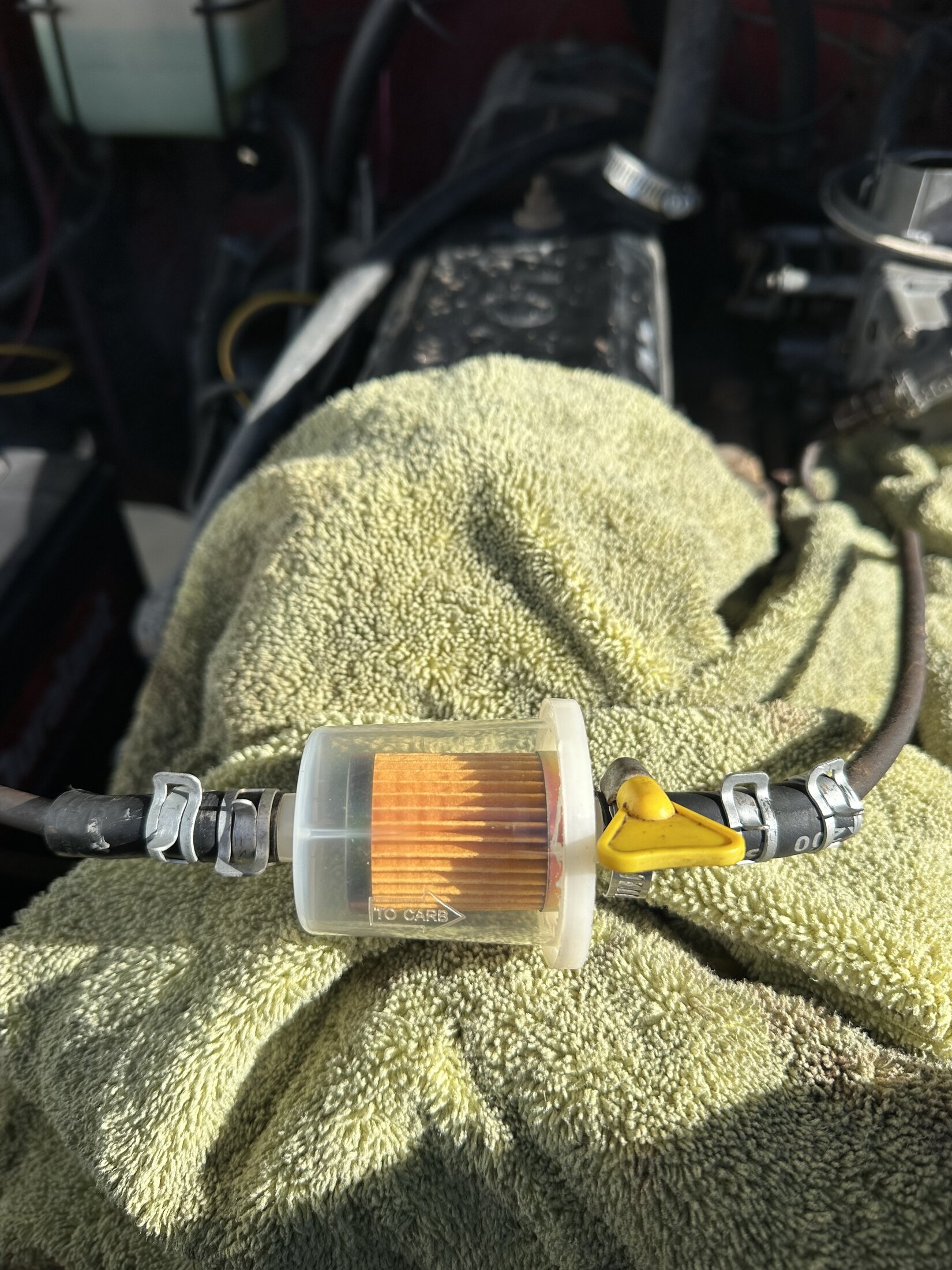

awesome. much appreciated! will chase it down.
Honestly, just get the $7 clear Napa filter. That way you’ll can actually watch what is happening.

As an update, I was able to replace the second fuel filter with the toyota filter (thanks, @MatthewMcD !). It looks good, no more leaks. However, the truck still won’t start.
