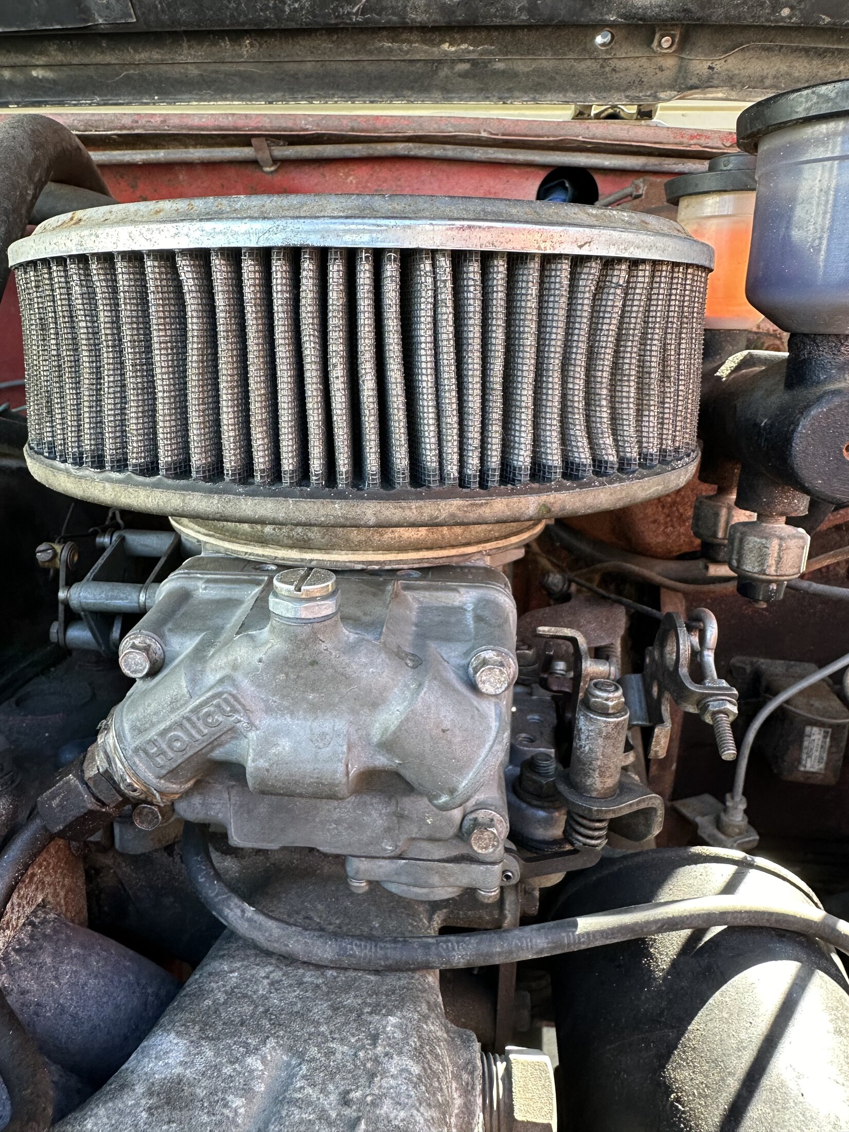

some pictures attached. @Mark Jennings mind sharing what the carb float is and what to look for ? thank you - much appreciated

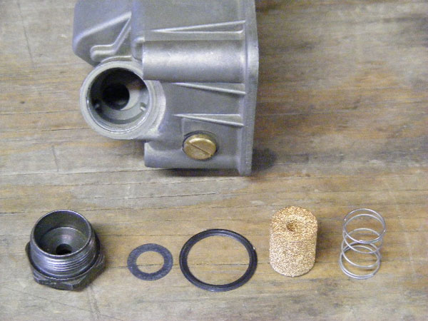

+1 I'd bet there is a fuel filter inside the housing under the HOLLY. Unscrew the fuel line, then the bigger fitting. Use carb spray to wash out the filter unit, old gas turns into varnish that will plug the filter, same as powdered rust from the tank - usually powdered metal crushed together.
Your air filter looks dry - I think they work better with filter "snot" oil. I have the big oiled foam unit from man-afre since about 1984 still there still works fine.
The Air filter looks like a K&N, it has a cloth element. Clean it up with Carb Cleaner then let it dry in the sun, then use a bit of ATF to oil it up. I used to use a small squirt can with ATF around the top edge and let it ‘wick’ down….just remember ‘spareingly’…..

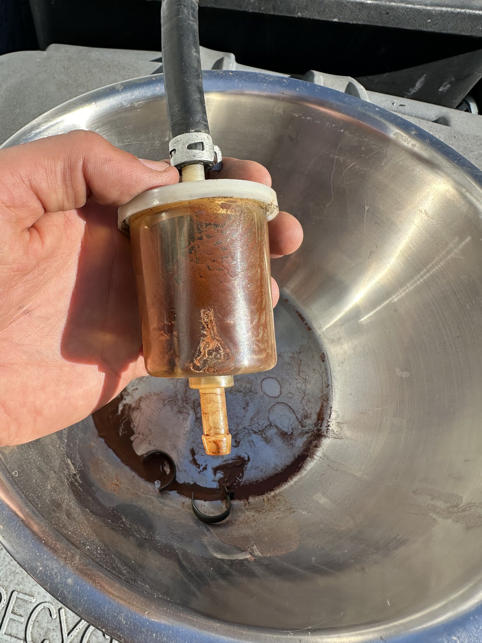

I replaced the fuel filter and I was surprised how much sludge was in the older one. see pictures. thanks for the advice on checking that.
after replacing it, I definitely noticed less sputtering at the start and the throttle felt strong again. i drove around my neighborhood and it drove fine (flat road). i went ahead and tackled a short, inclined hill and surprisingly no problem. keep in mind, it was a very short hill (30yds of incline). i went ahead and drove it to a longer, less steep hill, and boom, it sputtered and bogged down about 40 yards into incline (bummer).

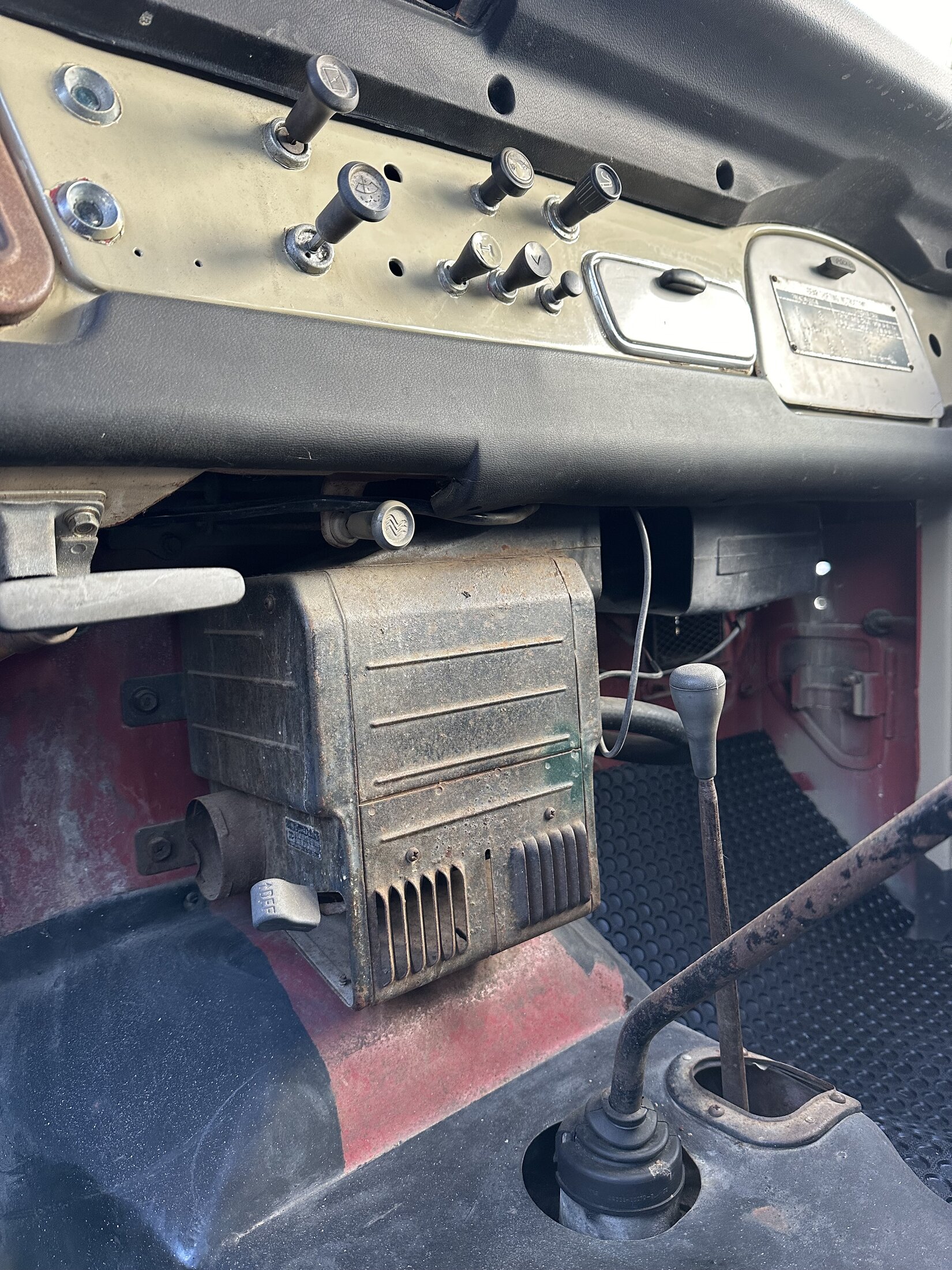

one thing I wanted to mention for the group was I noticed smoke would come from beneath the center dash (picture included, i don’t know this part is called).
overall, it drove better — zero doubt. but it’s still losing some power on a modest, longer incline.

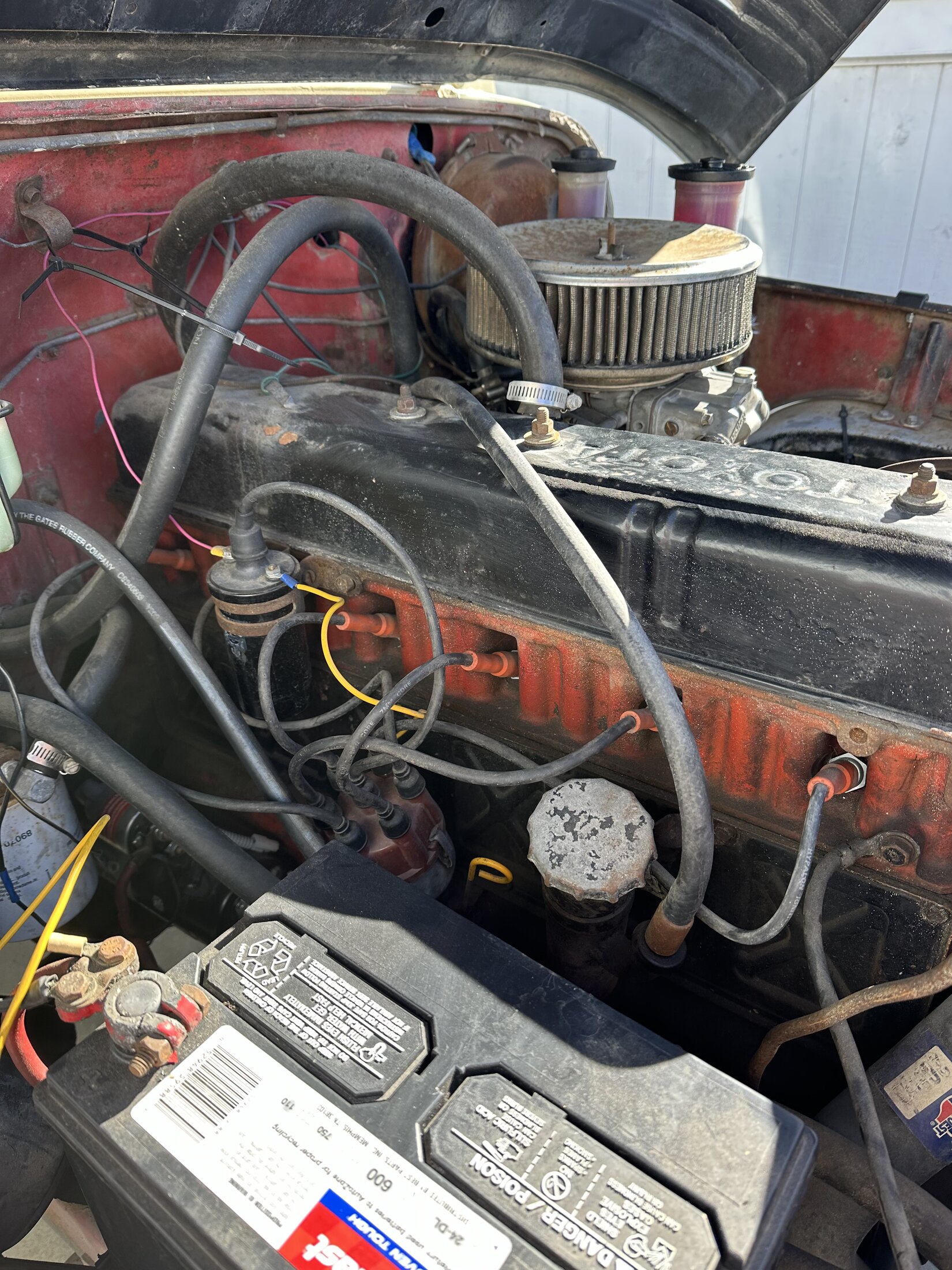

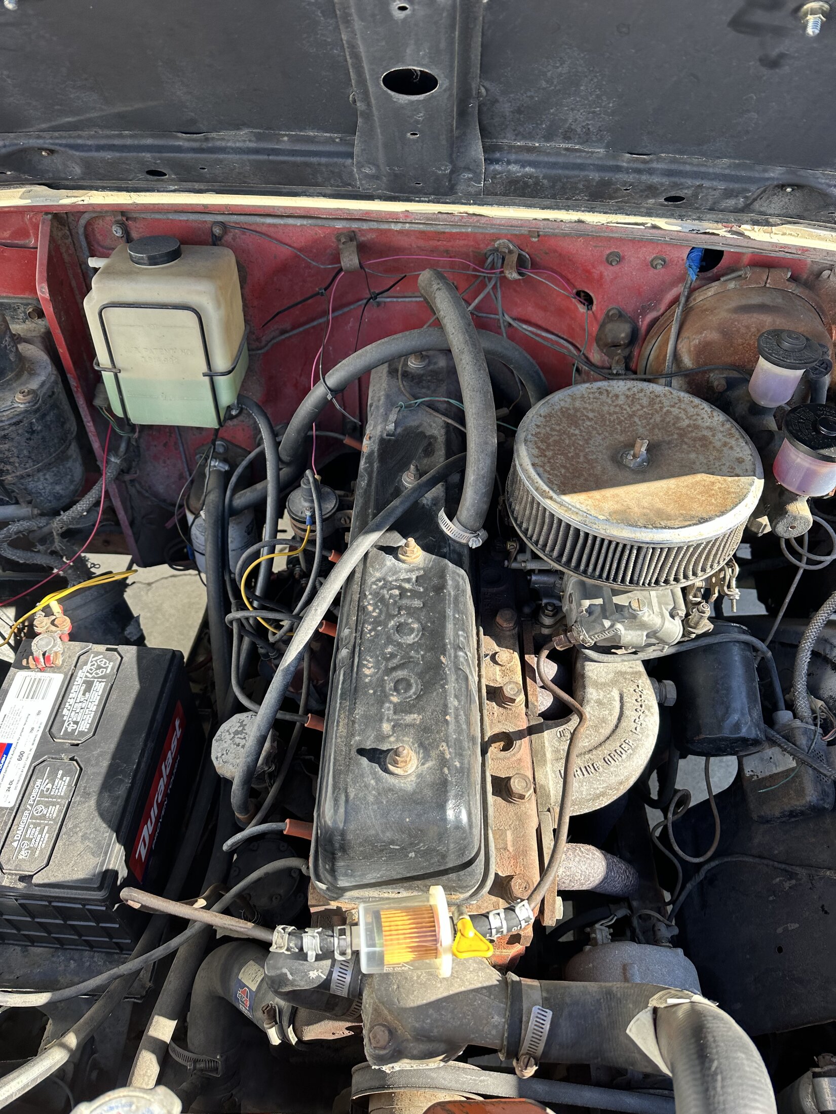

Engine bay pics attached ! let me know if anything sticks out.
cc: @Mark Jennings @charliemeyer007
You need new battery terminals + is cracked. Make sure the wire is corrosion free before you connect it. I actually prefer cast on battery terminals as they resist corrosion much better. Thick ones like for diesels are way better for the amps to pull the starter when its cold. I run a ground wire to the frame and the other to a starter bolt. Get a few extra fuel filters now - there is likely stuff still in the tank. That paper element will not pass fuel if it gets wet with water - set it in the sun for a few days and it will dry out and work again. Put some gas drier in the tank now too - that will help
After looking at the picture of the fuel filter, I wonder how much gunk is in the fuel pump. May be worth it to pull the pump down and clean it and get a fuel filter upstream of the pump. There should be a soft line under the passenger seat, tank outlet.
I’m beginning to think the same. I bet there’s a bunch of gunk in the fuel pump. will figure something. many thanks again
I had the same filter issues when I first got my 40 back on the road. I could drive about a mile with no problem, then it would bog down and sputter. If I pulled over and waited a couple of minutes I could go another mile. I found that the pick up line in the tank was getting clogged. My simple fix was to carry an air tank with me everywhere I went for the first couple of months and if I had the issue, I would pull the filter and blow a quick blast of air through the line back to the tank to dislodge the crud. After a few weeks and a couple of changed filters I stopped having issues.
Fast forward to this fall and I was on a trip in the woods and I think I knocked more crud loose and started running into the same issues. Changed the filters and ultimately ended up blowing air back into the tank and no more problems. I think I'll pull the tank this winter and properly clean it.
