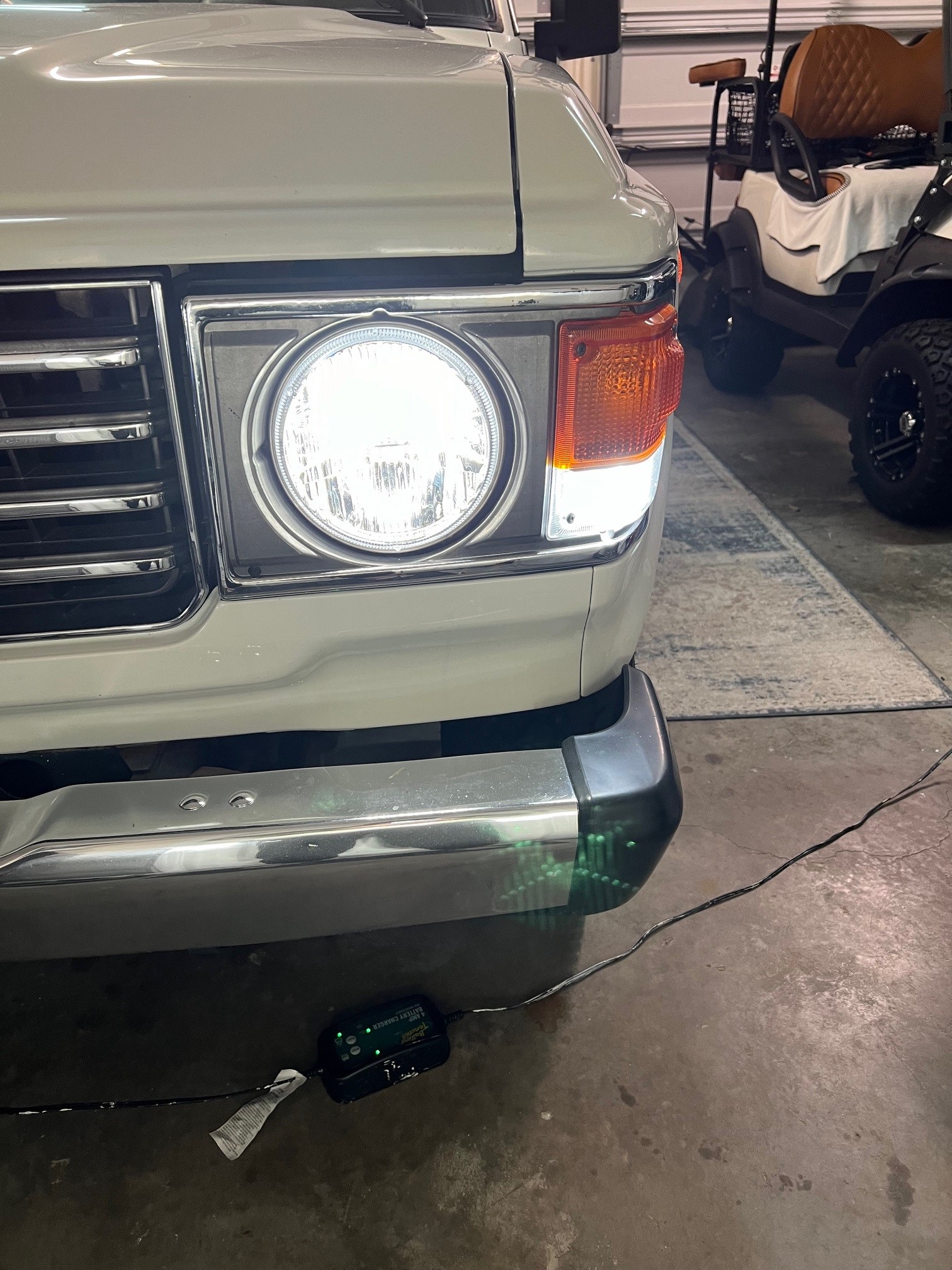

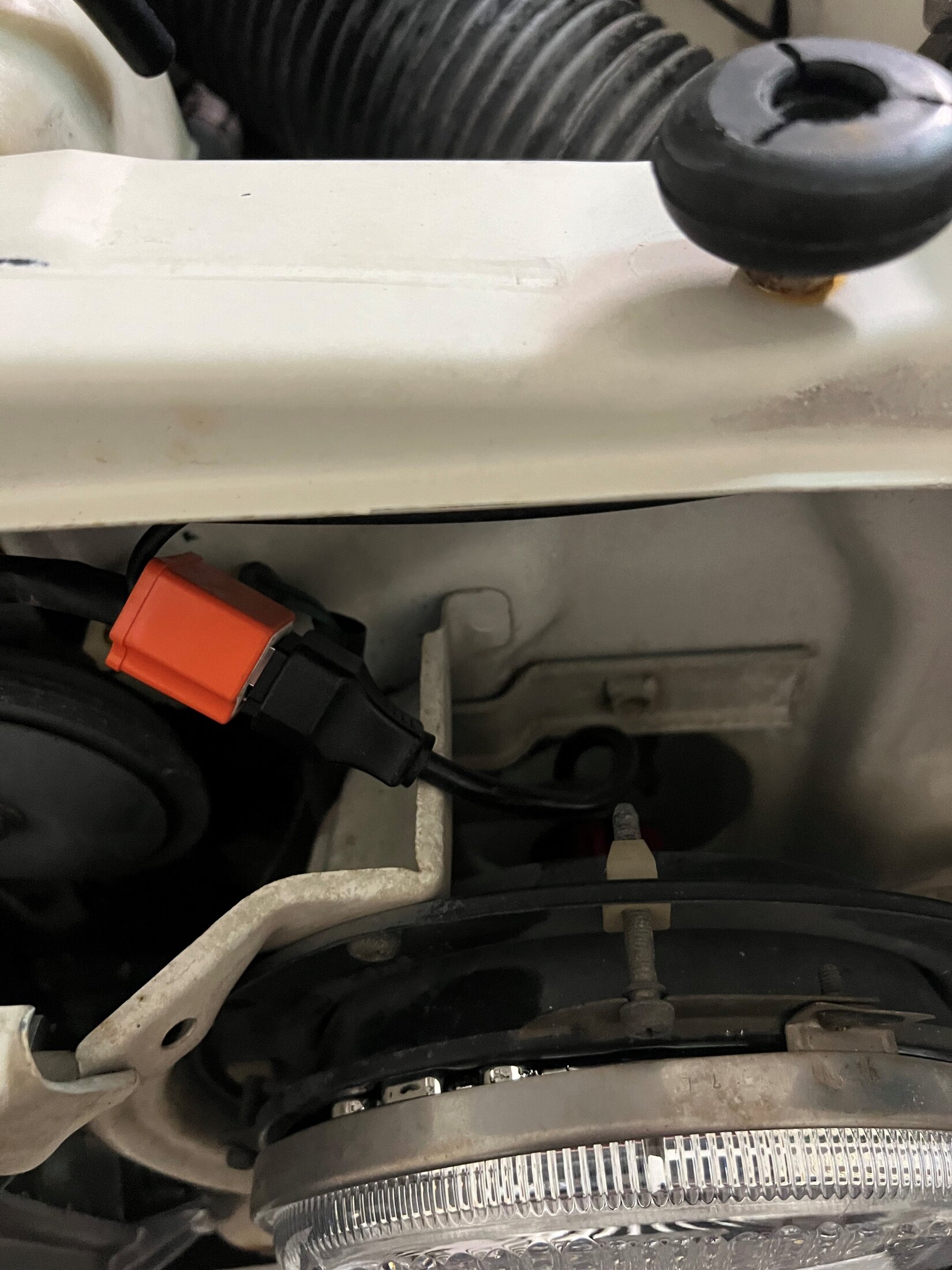

Here ya go. Trucklite LEDs vs Holley Retrobright LEDs. The retrobrites have been great. My dads got them on his firstgen camaro and a buddy has them on his firstgen 4runner. No complaints. The Holleys use a morimoto led bulb cartridge thats removable. You can buy the white colored headlights, and then get a spare set of the more yellow bulbs and switch them out if you wanted to haha
Did you need to cut any part of the headlight mount bucket or firewall to fit the Holley Retrobrights? On their website they look significantly deeper than original equipment lights. Thanks for letting us know

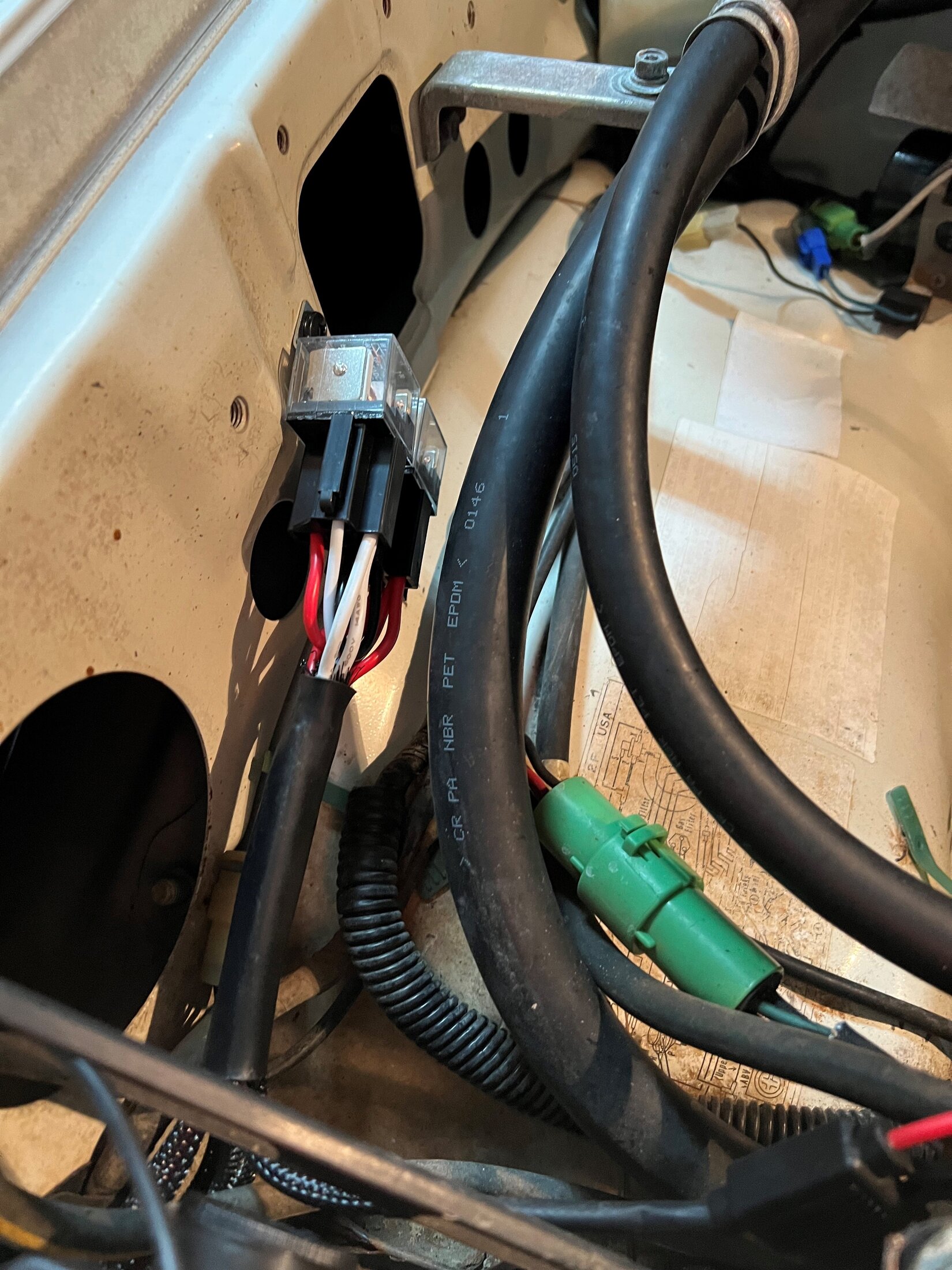

I just looked up my Holley order to be certain. Yes. I used the Holley RetroBright switched ground harness Part # H840. I also used the HBIM - High Beam Indicator Module for Koito Headlight Upgrade Kit from Cruiser Trash Parts @CruiserTrash after his recommendation here. It restores the blue high beam indicator on the dash after upgrading to LED headlights.

Awesome, thank you, I'm putting in my orders for these parts. I have some cheap halo/dual projector lights on there now from the previous owner. These Retrobrights are definitely going to be an improvement.
