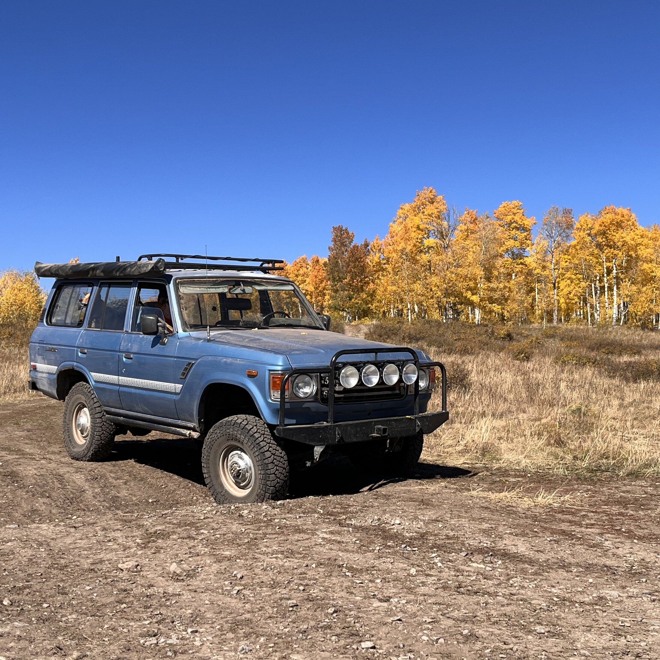

That’s probably my next step is shoehorning an 80 Series (3FE) alternator in there. I also have four 85w halogen PIAA driving lights up front, and running all 6 halogens bogs the system voltage down. Really, under 1500rpm I have to kill two of them. LED auxiliary lights to replace the PIAAs would be my move, but again … I want the look to be fitting. I’ve seen the BD stuff on other trucks and it’s is impressive, but I personally can’t get over the look of a robot-looking square pod on the front of my 60 haha.
That’s about 30-35 amps of current draw when they’re all on 😬
