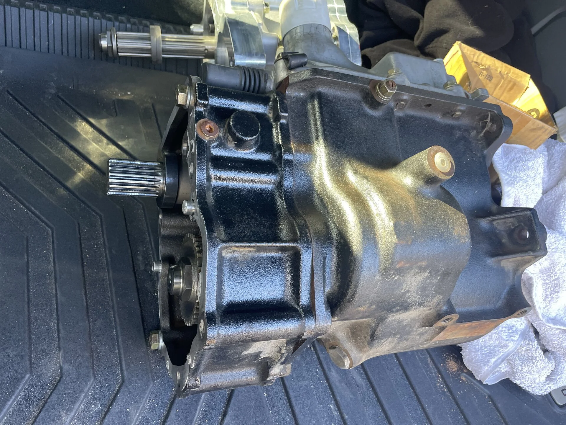

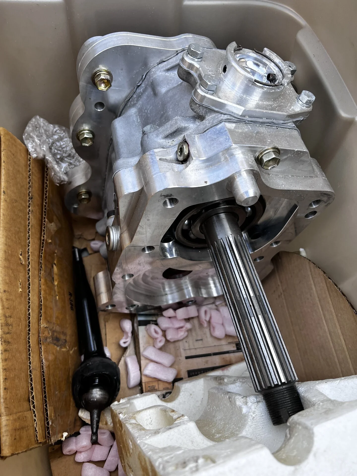

Pm sent. I can drive down with cash😜
Thanks Tommy FJ! Great to meet you today! I ended up picking up a h55 as well from him! Now time to modify and build!
