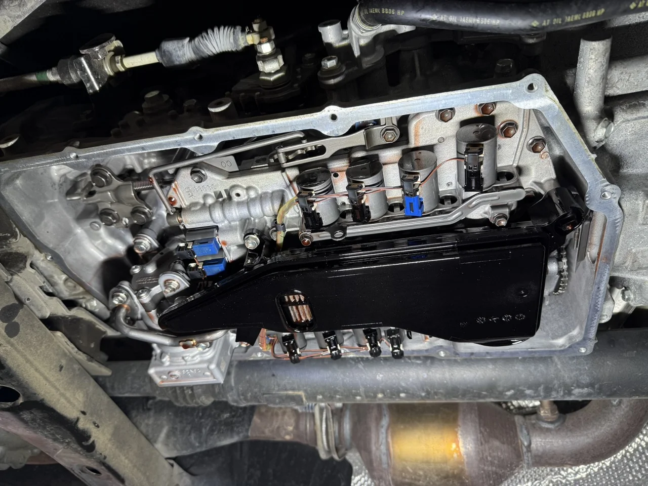

Pics in my thread:

Pics in my thread:

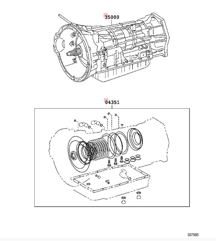

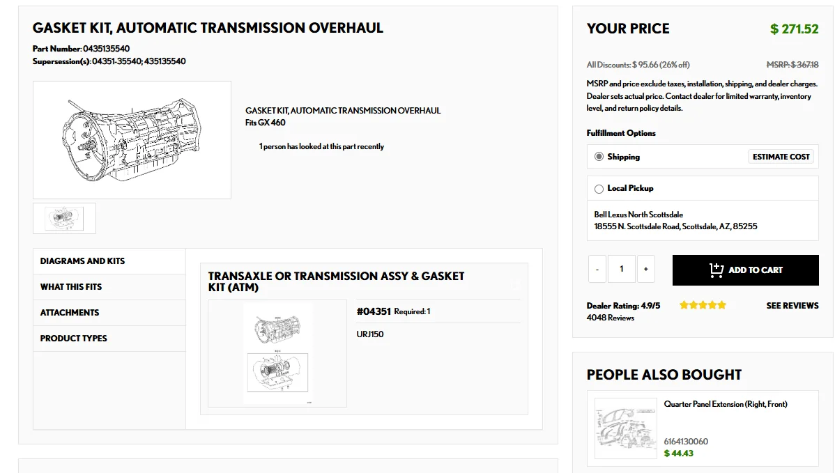

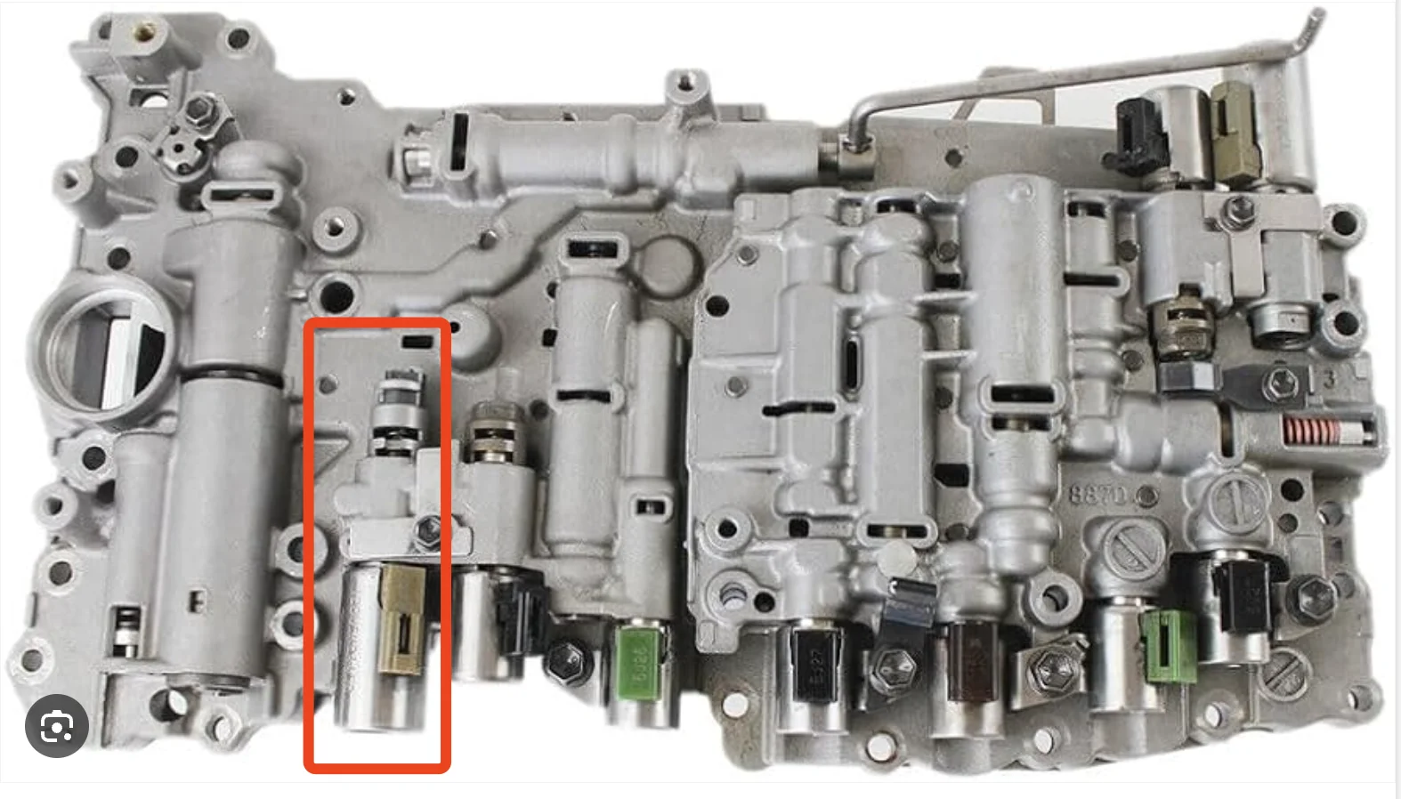

Also, has anyone else noticed this parts kit in the catalog? Is this all the clutches and plug seals etc??
